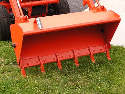

Yep, don't wait, go for it.
Best investment I have made, except maybe adding fluid to the rear tires, cause once you add the tooth bar, its easy to fill the loader bucket. Pops trees out of the ground, roots and all.
I bought mine at Outback Tractor, Cumming, GA.
Enjoy,
Les

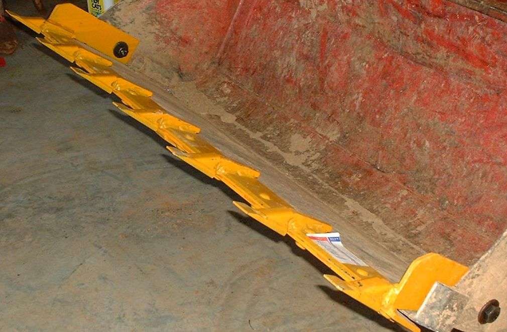

Love my H&H. Henro was right. It is built tough, and I like the"V" edge that protects the existing cutting edge. I unfortunately installed mine incorrectly, though. When I set the bucket down, I evidently did not have it flat. So, the bucket's cutting edge splits the "V" cutting edge of the toothbar. The bucket's edge is supposed to be on the bottom edge of the toothbar's "V" edge for more strength. I now have to wait until I get my welder, weld reinforcing plates on the bucket, and install the toothbar correctly. Oh, STUPID me. Doesn't pay to hurry. It certainly seems to give the bucket "rigidity" along the cutting edge, which was my goal (as I bent the buckets cutting edge prior).
