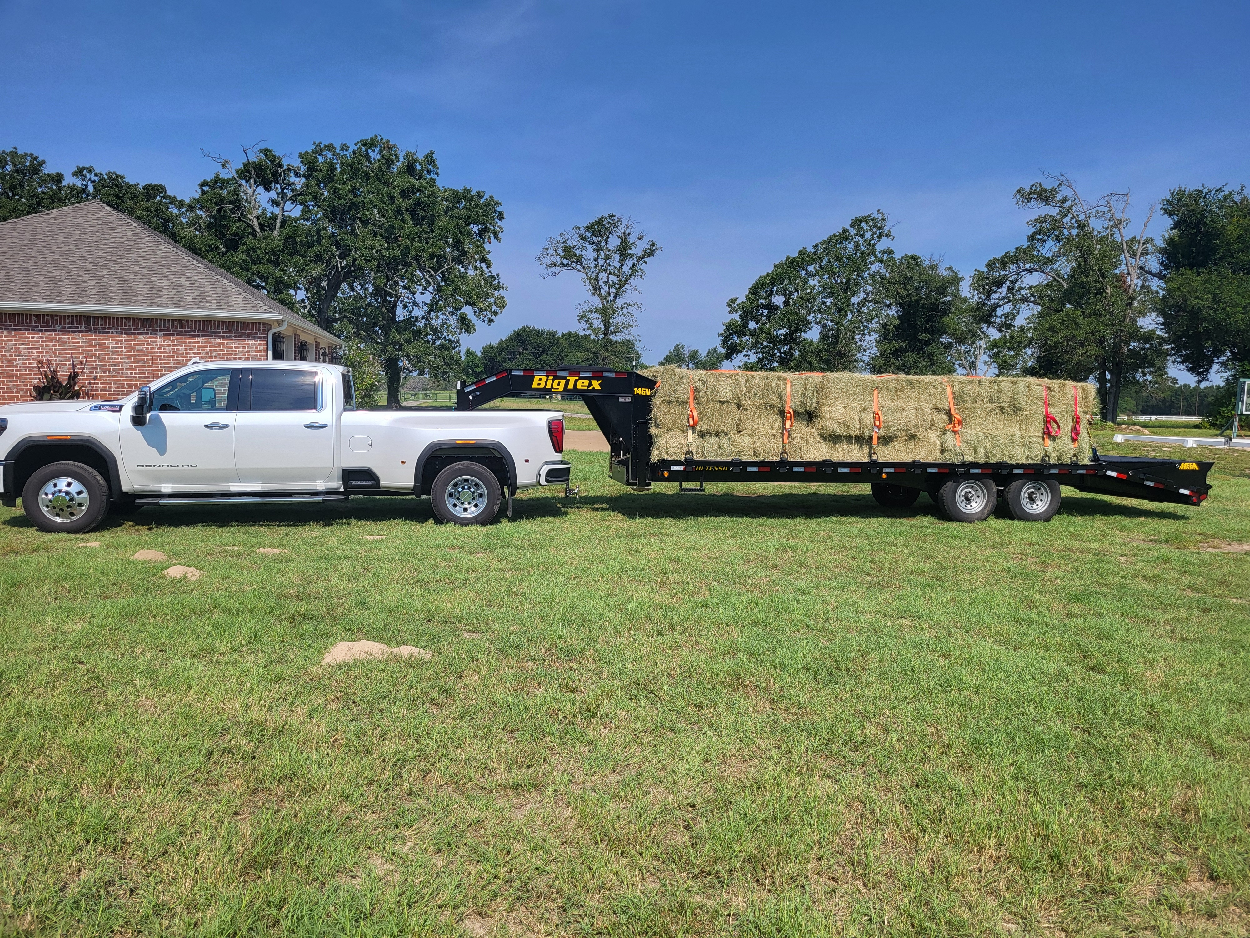

I currently have 4 Big Tex trailers, plus have had several others that were traded in on the current ones. No issues with any of them. My 14GN 20+5 has the Mega ramps, they are nice. I put 5,400# d-rings in every stake pocket for hauling hay, works out well having a tiedown every 2 feet if needed.
Since you are considering a skid steer and have the 350 towing vehicle, why not get a gooseneck trailer? I have the bumper pull 14TD dump trailer that I routinely fill with 12,000# of topsoil. I previously had a GN dump with scissor lift but traded it in on the bumper pull as it had a ram lift. It definitely rides rougher than the GN dump and my 14GN haiuling a heavy load.

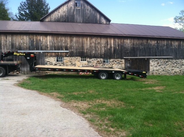

Good looking trailer Mr. Lou. Looking at their website...lots of dealers fairly close.
Did you get the power tilt or gravity tilt?
Does the spare tire get in the way?
/ Trailer Decision - Pros / Cons #17
It is the full power tilt up and down, it can also gravity down.
The spare tire is not in the way, except it is in the underside center of the bed.
I have looked at it but never touched it. The good thing is it does have safety stops for the lift for if you ever had to go in and get it.
If I ever need it on the road I sure hope one of my young nephews is around :) cause I don't want to have to get it out.
I have mounted one toolbox under the bed and have a second one to mount on the other side for tiedowns and accessories.

One of the reasons for it was to enable moving my lighter tractors. I have not loaded one yet. I do not know if the hoe would impede loading and require manipulation to load. I have considered getting a wireless controller to avoid having to work my way down and off the raised bed.
