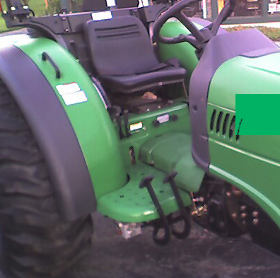

Photo 1: The tractor has the rear remotes and the lever is actually UNDER your right leg so you have to move your leg to operate the remotes. That is fact. It is opinion that it is bad ergonomics.
ALSO in Photo 1:
Also, the tractor has no rubber mats or flat floor. For a tractor this size that is sold as a full featured tractor this is surprising. That is opinion. Fact is that the floor will scratch and rust and the large hump will get in your way. This is a large tractor for its power range, about 30hp, I know of only one or two other tractors this physical size without a flat floor.

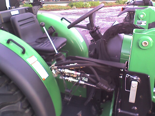

Photo 2: This is sold as a 39hp deluxe tractor with HST. OK now here I hit one of my major pet peeves! When a loader is installed, these tractors become ONE SIDE entry/exit machines. You can see my hand in one of the photos, my hand measures roughly 8" across, which illustrates that there is no room to exit from the right of the tractor. It is fact that you cannot exit/enter from the right side. It is opinion that this is bad design.
Photo 3:
This is the same tractor again, you can see the "stout" (that is how it was described by the sales guy) loader valve mount. To me it is a "mess". Both are opinions. Fact is the hoses are exposed to tree limbs or other things that can snag it.
Photos 2 & 3
will illustrate the next points. The loader control valve is also set in an awkward place (that is Opinion). Most loader controls that I have used, whether fender mounted or loader mounted, have the end of the loader control stalk/lever roughly in line and to the right side of the center hub of the steering wheel (that is fact). This one was well behind the center of the steering wheel, in fact it was in line with an imaginary line that would run from the bottom plane of the steering wheel (that is fact). It seemed too far back to me (that is opinion). Again, that is just my opinionated view. You can see how far behind the center of the steering column the loader is located in the first picture. In these pictures also look at the placement of the throttle control. With the throttle pulled back, it could come into contact with someone's leg who had the drivers seat pulled forward (that is fact), but it is my opinon that it is also a bad design.

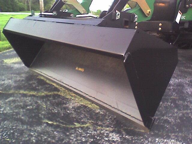

Photo 4:
This shows a very lightly built bucket (fact). The tractor claims to have lots of capacity (fact). My opinion is that the bucket is too lightly built and will be damaged far too easily given the size of the tractor and the claimed capacity. My opinion is that the top of the bucket should have some reinforcement instead of a simple 60-degree fold. My opinion is that the bucket top will collapse if bucket hooks are welded to it and a heavy load is lifted (again the tractor is rated to lift heavy loads). Fact is the bucket come standard with a QA system. Opinion is the QA system is roughly made poorly finished, but it will probably provide a long service life, even if it is not the smoothest to operate.

Ohhh, I dunno, Bob. You've obviously given this alot of thought and the value of evaluating a tractor in terms of intended Tasks & Conditions can't be debated. But, rather than being a flat-out 'factual' example of bad design, the tractor in the photos would benefit from the T & C approach in at least a couple of cases.
Addressing just the issues you raised about the tractor in photo 1; having those remotes buried low behind a leg is a big advantage when working around trees. Also for an orchard spray-rig tractor that gets doused occasionally, a floor without a rubber mat but with drain holes would be an advantage as well. I notice the rears have rounded fenders with the grab handles aligned with the direction of travel; this too would make it a superior orchard tractor.
While some of these things might be examples of bad design for a general utility tractor, they point to a design that, at some point, may have been intended for orchard work. If orchard work wasn't one of your tasks, the design would obviously be lacking. If it was one of your tasks, this tractor has some things going for it. If it's an orchard tractor that's being marketed as a utility tractor then the market itself will declare the tractor a loser in the long run.

As for the FEL control arrangement....wellll, I won't attempt to rationalize that.
