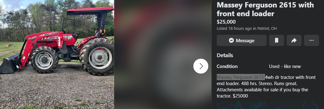

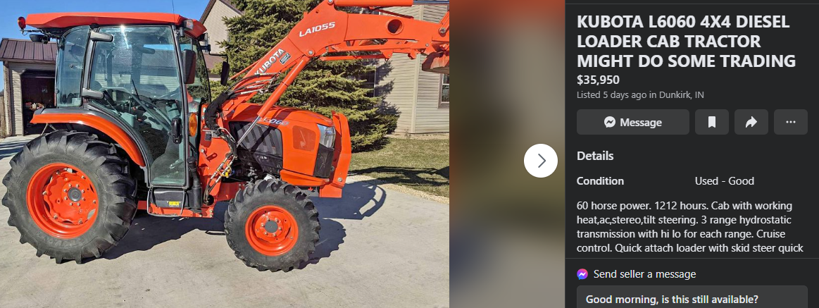

There are some used deals out there. Here is one that is a lot of tractor for the money and low hours. You may have to drive a bit to get them but they are out there. They still aren't lasting too long if they are a good deal.
   / Best upgrade from a Kubota L2800 #7
This 50hp listed 18 hours ago. He's probably already getting messaged. Won't last
Edit: Oh but it looks like gear drive.
