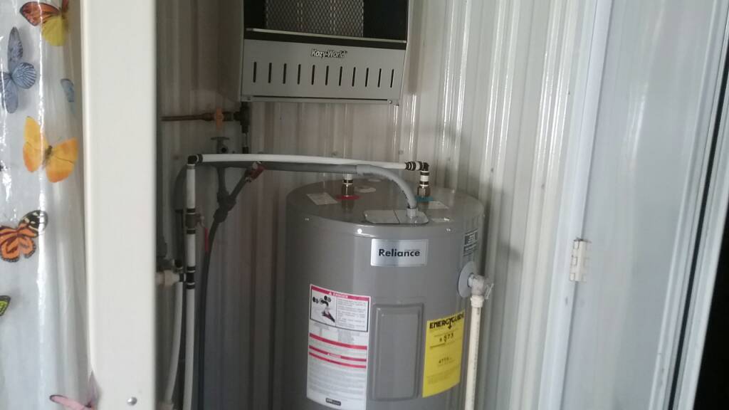

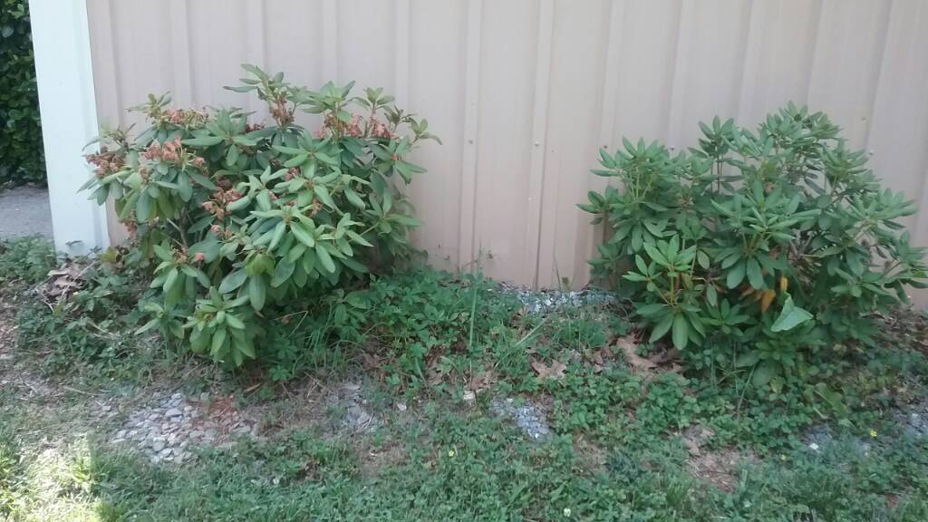

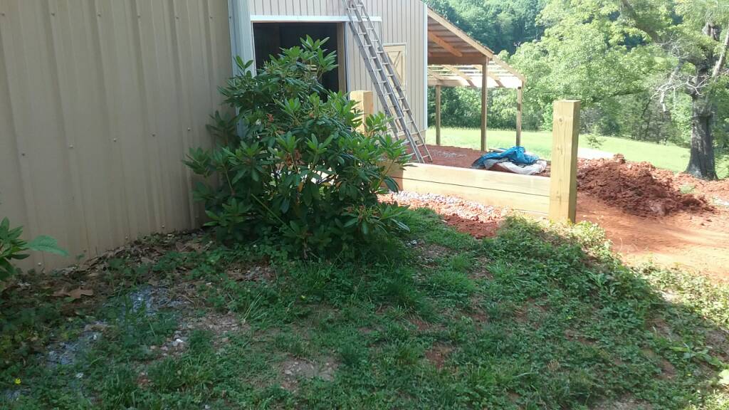

Yes and I so appreciate good useful advice! You can't beat experience. A few pictures may help. This project I want to come together in order, before cement is poured and there will be steps put in also, going downhill to barn.
Garage room I'm starting from is a bath area, always heated so water tapped there. Also not far, 20 ft. away is the main panel box, so it's convenient.
50 amp service is all I need. Friend/neighbor has lots of Square D stuff he said I can have. I plan on 240v box there and few breakers, outlets, lights.
I put the small road in today going around to the shed overhang. 20190527_161237.jpg20190527_161257.jpg20190527_161303.jpg20190527_161324.jpg20190527_161400.jpg20190527_161531.jpg

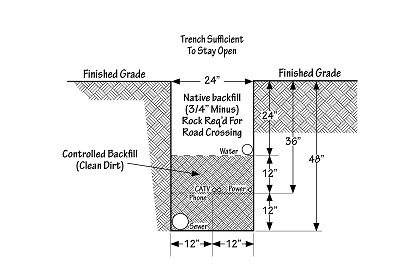

Here’s the way I’ve seen it. This doesn’t work in Vermont as the frost line is 5 ft.
