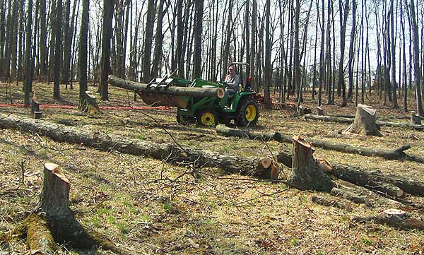

The safest way to cut trees is to have someone else do the work for you. If you are going to do it yourself, be smart. As stated above, Dead branches will kill you if you try to push a tree over with your tractor. My idea of cutting trees is to drop the tree. Worry about the stump later. Trees fall on the heavy side unless helped to fall where you want them to go. This can be accomplished by dropping the branches on the heavy side first. Or you can attach a cable, not a rope, high up in the tree and use a come-along to help intice the tree to where you want it to fall. Ropes strech and are not preferred for pulling trees down with a come-along. They do work well when used with a tractor for pulling. But if the rope breaks you will wish you are not in direct line of it. Notching the tree is very important as mentioned. The Arborist Site mentioned is very good for information. I found that there are a few guys there that have swelled heads and think that if you are not one of them that you shouldn't be climbing or cutting trees. There are also a few guys there that are pretty good and will help you out with questions on climbing and such. Be safe, don't drop trees into other standing trees. This leads to more work and a potentially dangerous situation should one of them break and land on your head while you are trying to clean them up. Should you drop a tree into another one and it gets hung up. Use your tractor to pull the base of the cut tree till the tree falls to the ground. I've also used my tractor and bucket as a lever to help push trees over that I am cutting. I use my rear blade reversed and dug into the ground for a backstop. Then lift the bucket up and put pressure on the tree once I have my notch cut in place. I then start to cut the backside of the tree. Once the tree starts to move the slightest bit, I try to use the tractor to finish it off. This gets me out of harm's way. I've been cutting trees on our 45 acres for general maintance and firewood since 1974 without any mishaps. Think ahead, think smart and you will do all right. Here's a small one for you.

   / Best way(s) to safely fell trees #14
This is to no one in particular because I have seen it reccomended in a few replies.
What on earth are you thinking by putting pressure on a tree with a FEL , then walking UNDER the FEL and making a back cut?
First, you have no real idea of what direction, other than away from the tractor (maybe), that the tree "should" fall. Look at the angle and where all of the tree weight is. Your FEL is the fulcrum if one breeze blows back. Your machine will be wearing a wooden hood ornament. If you are alive to see it, get a pic please.
Second, why are you standing under a FEL that is in a raised position? Even worse, no one mentioned anyone on the controls.
Third, the FEL makes a really nice slide for the tree to go off to the side. I got talked into doing this, once. The tractor was applying pressure and the operator was moving it towards the wedge. The tree decided it didnt want to go that way. It didnt. The stump almost got me. I had some words with the operator, then I started bucking up the tree that was now across the road blocking traffic.
Forth, that tree has more force than your FEL when the FEL is not under hydraulic pressure. A tree has more potential force than your FEL under hydraulic pressure.
Fifth, you are parking a big lump is your escape zone.
If it is some little 6-7 inch tree then I can see it, less the idea of standing under the unsupported, uncontroled FEL. Since you could push that size over by hand, maybe not.
To each his own, but I wouldnt reccomend doing that to anyone.
   / Best way(s) to safely fell trees #15

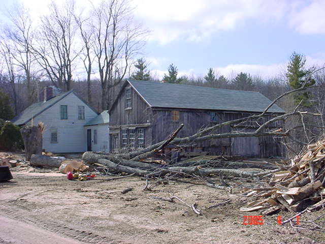

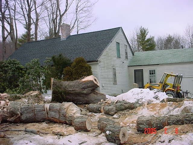

Good points well taken. I should have mentioned that I only use my loader on smaller trees of 12" or less diameter. The picture that I posted was of a tree I cut down in sections. The last section was pushed over using my tractor once I cut the butt of it off. I do and have worked under my bucket with pressure on a tree. The bucket is up pretty high, I don't think the bucket could fall on me with the tree in the way. One other thing that I didn't mention about falling trees using the bucket. I drop them in the direction that it looks like the tree will fall in. I use the tractor and bucket to make sure it falls that way. I wouldn't even consider tyring to push it over from the heavy side. Here's another that we pulled down with a winch. This one was heavy on the building side.
