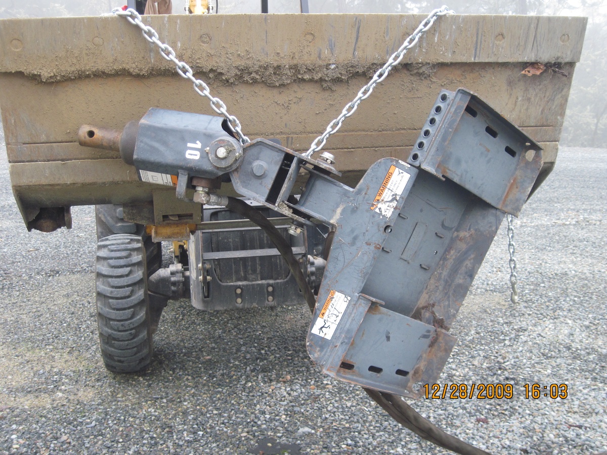

I wouldn't want it mounted to my front bucket, but I would really want it on the backhoe. I don't know the size of your pins, or the pin on the auger, but if there's a way to make it work, that would really be a nice setup.

Not sure if Bindian's method is using the curl cylinder or not but it certainly looks like a nice setup. Considering the fact you have to fabricate a mount anyway I think something similar is a good choice. I know the bucket curl cylinder is important for a hammer but am not so sure about an auger which should be able to hang plumb to start with.

That's not the thread that I was thinking of, but the second pictures show it very clearly. In the thread I'm thinking of, she was talking about it, and I asked her to show a picture. It might have been the same picture, I don't remember for sure. I am going to copy that picture you linked to and keep it my "ideas" folder. I have all sorts of pictures that others have done that I want to do some day, and that's one that I need in there.
If I come across a great deal on a hydralic post hole digger, that's just what I'm going to do. I have a 3 pt unit now, and while it gets the job done, it's lacking in allot of ways. Mostly just lining it up where I want it, and then keeping it going straight down are the two biggest issues. Then I'm limited in how deep I can go because of how high I can get my 3pt lift. 3 ft is about my maximum depth, and while that's proven to be enough, I still want that option of going deeper.
I think that with Brandi's method, you will have the ultimate setup that will allow you to get the auger exactly where you want it, and also to keep it perfectly straight. Being hydraulic, you can also back it out of a hole, as opposed to a 3pt, where you have to get a pipe wrench to unscrew the auger if it gets in too deep, too fast.
Of course, with the setup that you bought, it's either as simple as fitting it on the pin, or making an adapter, and then running some hoses. If the bucket curl is removed and the hose gets a quick attack to the cylinder, you should be able to remove those hoses from the cylinder and control the auger with those hoses. Maybe even put a valve on the hose to divert the hydrualic oil from the cylinder to the hoses running to the auger. At least that's my idea. I don't know if it's doable or not. LOL

I do have the auxiliary hydraulics on the backhoe. Right now it is used to power the hydraulic thumb.

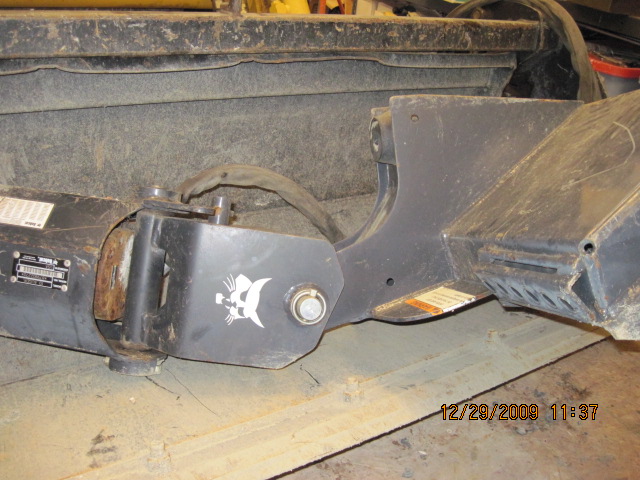

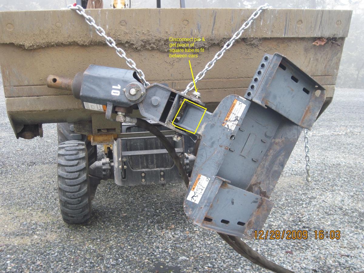

Here are some more pix of the attachment side of the mounting plate.
Looking at this, I don't see any reason I can't set this up for a dual mount system. For something quick & dirty, I can get another skid steer plate and either weld it to the arm side of the existing plate, or have the welder fabricate an attachment mount similar to the existing one, whichever is less costly.
The pin right above the cat's head is 1 3/8" diameter, and is easily removable. The pins on the backhoe near the bucket are 1 3/8" diameter also, but none are good candidates for hanging the auger, because nothing will fit the auger bracket properly.
The backhoe bucket has the proprietary JD quick attach system rather than being a pin on system, which would have made things a lot easier.
I do have a 12" bucket which I do not use since it is incompatible with the hydraulic thumb, but it might turn out that I can somehow modify it to use as a bracket to accept the auger unit. Something to think about.
I do agree that having the auger mounted on the backhoe would be better than on the loader. It looks like that is going to involve a more expensive bracket.

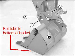

You could disconnect the existing QA mount at the first pin. Then get yourself a piece of square tube sized to fit between the ears of the bracket where you removed the pin. Drill the tube to accept a bushing and the pin. Bolt the tube to the bottom of the bucket and attach your backhoe hyd auxiliary circuit.
This option uses no welding and uses your existing 12" BH bucket (and its QA) without totally destroying it.

the mount you have is for a bobcat "MT" series machine; the walk-behind skid steers. you can readily buy a fullsize plate with the correct "head" that your auger will go right onto
