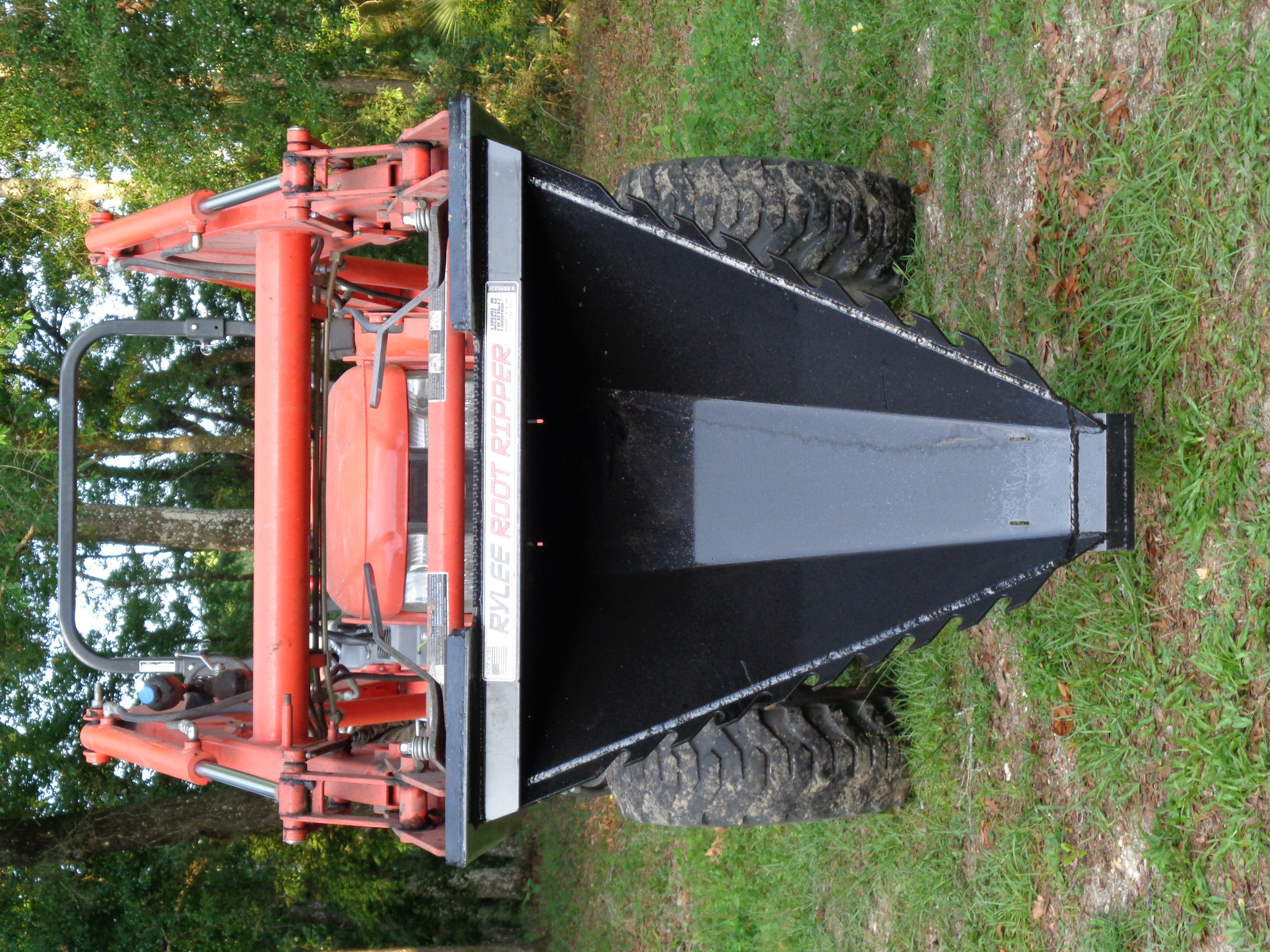

Has anyone used this for removing trees/stumps with a tractor?
I have a very similar Rylee Root Ripper, which weighs 165 pounds.
My compact tractor operates a 100 pound bucket spade well, so I thought it would handle the heavier, longer Tree Spade. Well, it won't.
Compact tractor hydraulics are too weak to operate a long stump bucket satisfactorily even in my sandy-loam. Too much leverage working against the FEL, unlike a bucket spade which is relatively short. A 5,000 pound or 6,000 pound bare weight utility class tractor might work.
I need to make time to put my Rylee on eBay....
