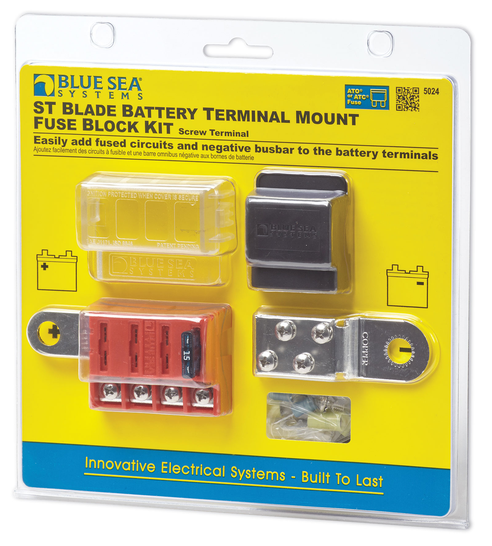

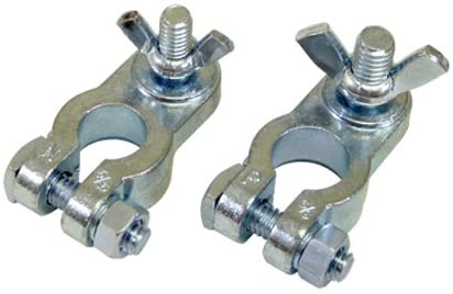

I was curious what others do to land additional wires onto your battery terminals. I have to run an additional wire and I'd like something clean and reliable. Any suggestions?
   / Best way to connect another wire to a battery post? #3
A lot depends on the amperage you need to draw.
Most important is to have circuit protection as close as possible to the battery and to use proper fusing for the wire size.

Look at any site the sells auto stereo equipment, they use all sorts of different connector configurations so they have a huge selection available...
I was lucky on my MF GC1715 because it bolts the cable to a clamp on battery terminal, and I just put a ring terminal under the nut for bolt....

My Ram Power Wagon has a special terminal. It's got multiple bolt/nut connection points. There are four wires coming off the terminal. Each wire is fused at the terminal. Hard location to get a good picture. I've used the type bcp links to with good success.

For my trickle charger, I just put crimp-on ring terminals on the wires and put them underneath the nuts on the terminal clamps. But that is only an amp or 2 at the most. That is fine for smaller loads, but you probably want one of the other solutions shown for heavier loads.

How big is the additional wire? What does it power? Might be better off going from your fuse box.
