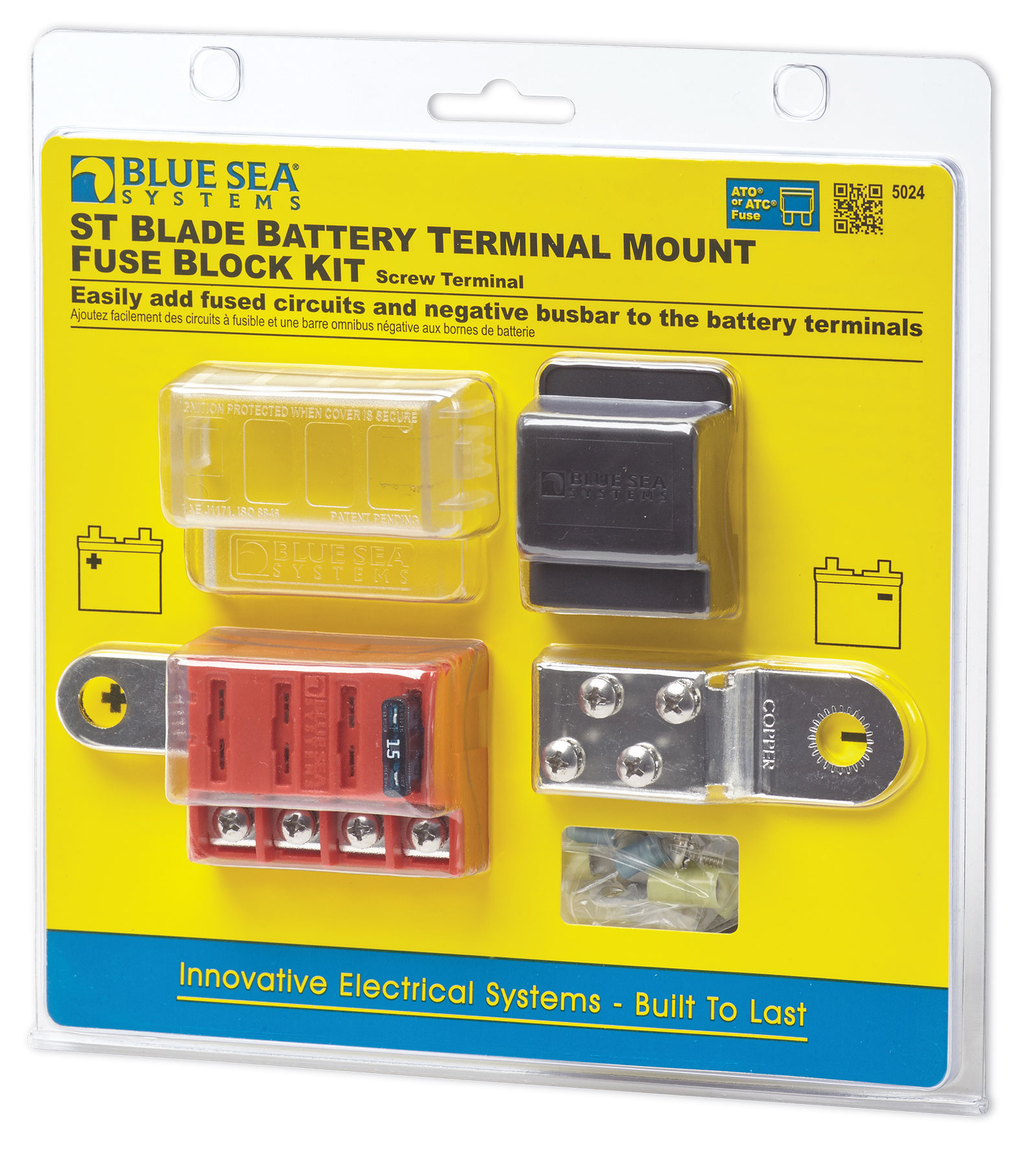

Try Blue Sea Systems, they have a variety of options for circuit protection, bus bars, switches, etc. They produce quality components mainly for marine applications, but suitable for ag and other mobile uses.
   / Best way to connect another wire to a battery post? #18
Combining these two would give you the circuit protection at the battery.
