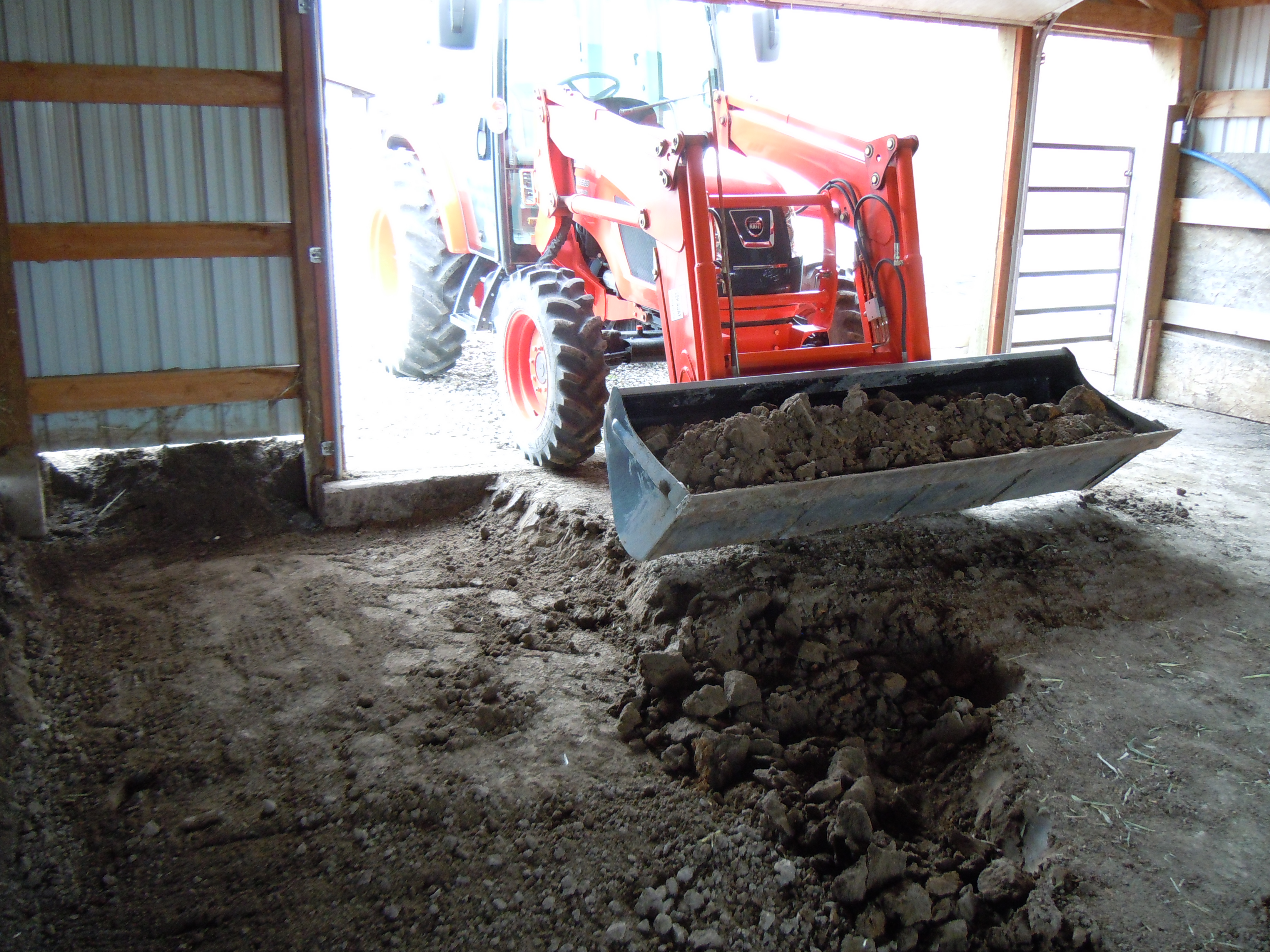

A tooth bar on the bucket works wonders. Other than that you went about it the best way with what you had available.
Something like a pihrranah tooth bar will dig pretty well at least mine does. As long as it痴 not supremly bony mine will do that much without too much trouble. I do use the hoe though whenever the going gets rough which sure helps .

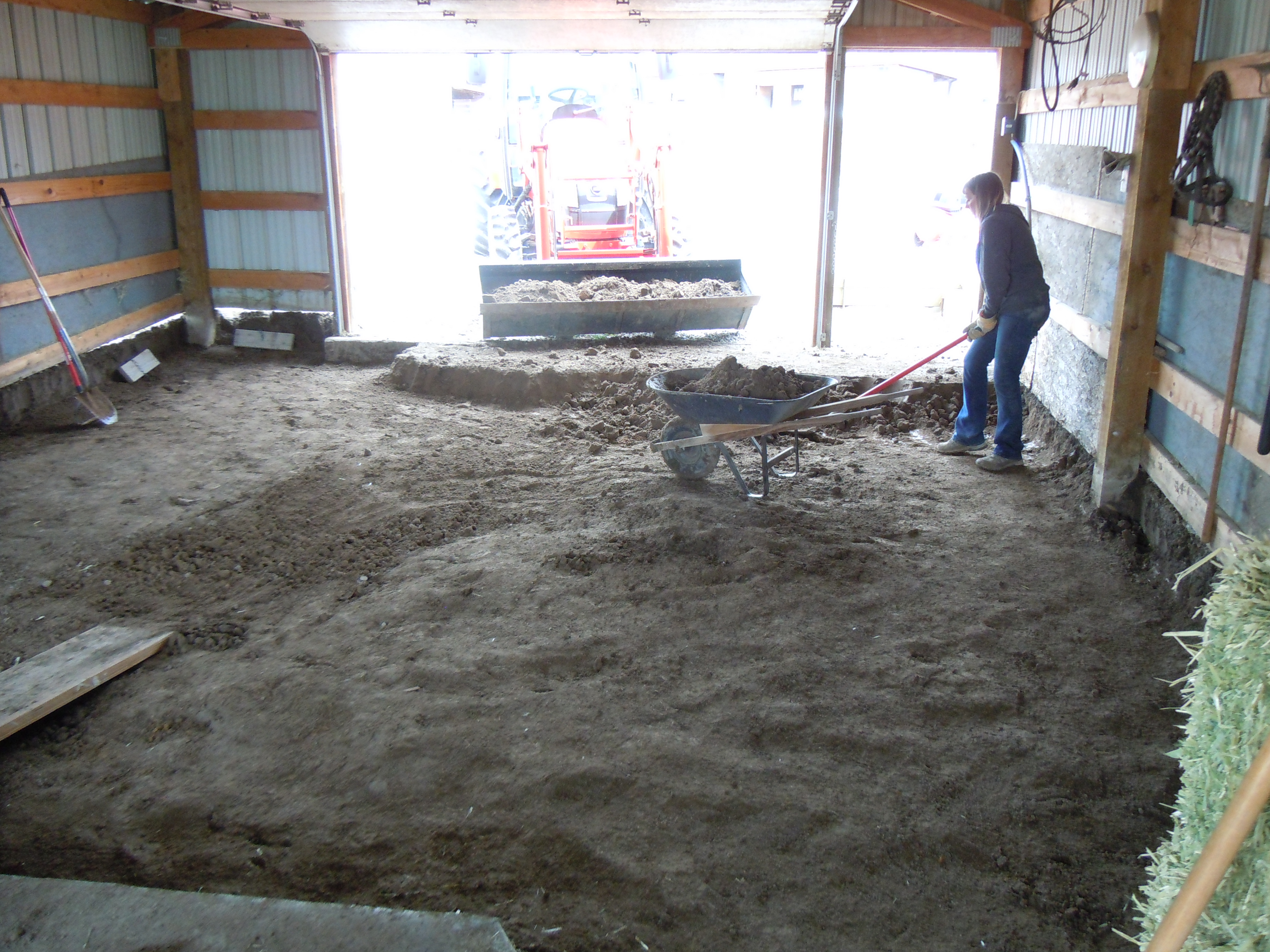

As said,
Tooth bar and FEL. Myself, I thought it would be easier to build the barn then dig out the dirt.:confused3:
