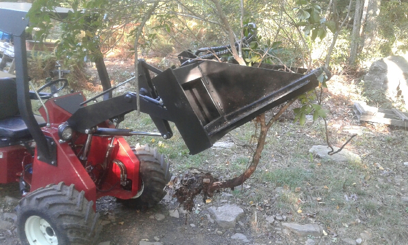

You can try a tree puller (they are reasonable at Titan when on sale). If you can pull them out with a chain, the tree puller will work quick and only need one person and you don't have to get off the machine. I grab the larger trees and push over forward then back etc.
When I bought mine, it was only $600, they have gone up a bit, but on sale now. You would need an adapter or weld on a mounting plate.
Heavy-Duty Post And Tree Puller For Skid Steers, Universal Landscape Tool

Need to clear a couple access roads through my bug out property. Alot of 1 to 4 inch trees (oak and maple). I have the light material bucket and the 4 in 1 bucket and PT1460.
Going to try and just use the front edge of the bucket and dig into the ground slightly and lift and tear all this out as I go into it?
A little concerned about getting flat tires?
I think it will work on the smaller stuff but the trees that are around 4 inches and bigger may be a problem?
Any better/other suggestions?
If you need an access road in the bush I find that the best thing is to get an old chainsaw bar and chain and cut these small stumps flat and flush with the ground. The roots hold the ground together and give your vehicles better floatation and traction, especially if you have soft ground. Ripping out the roots leaves you a big muddy mess and you make ruts fast.
If you are planning a real road then rip out the roots, remove the topsoil and put down gravel. Root rake grapples work great for small stuff like this.
