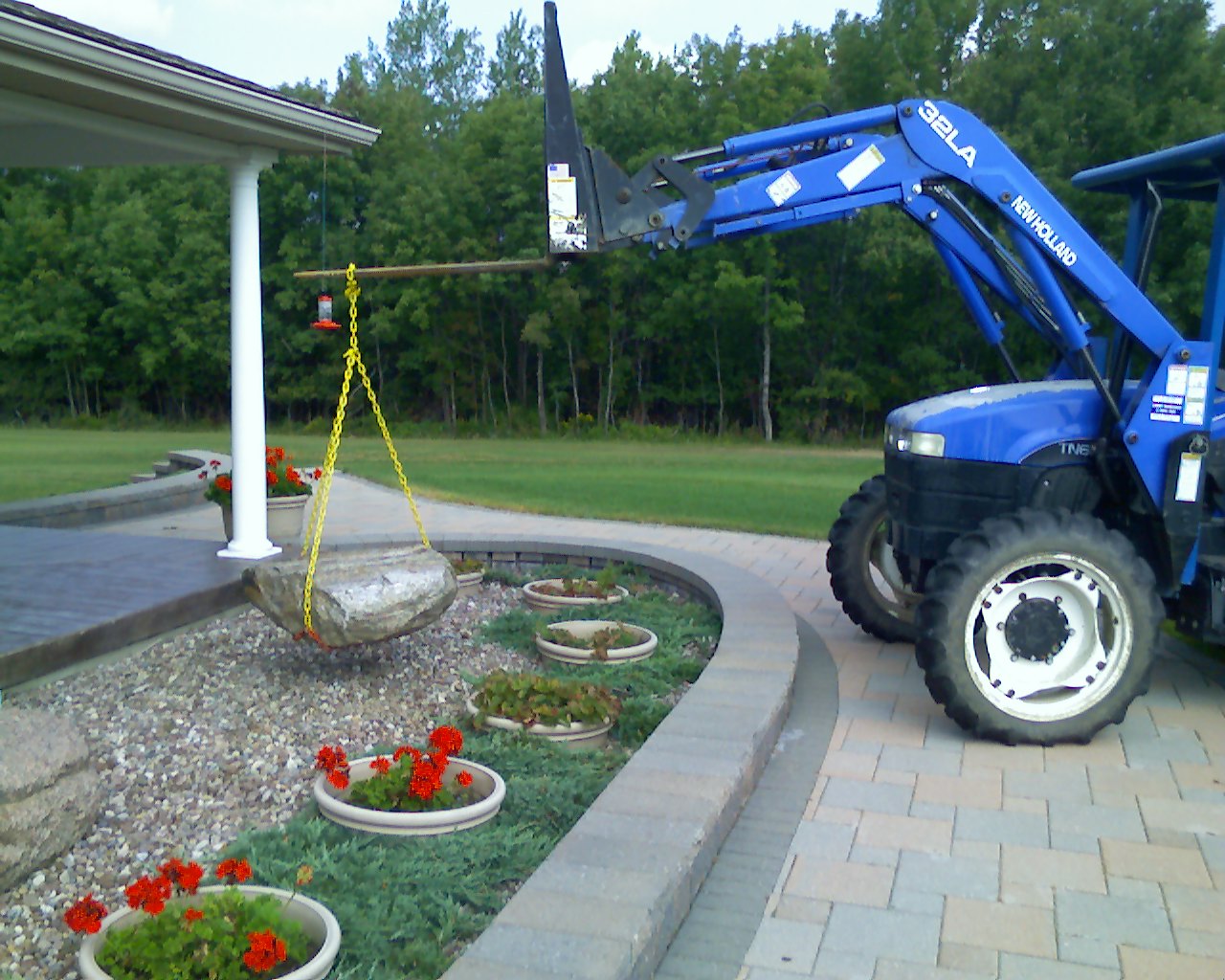

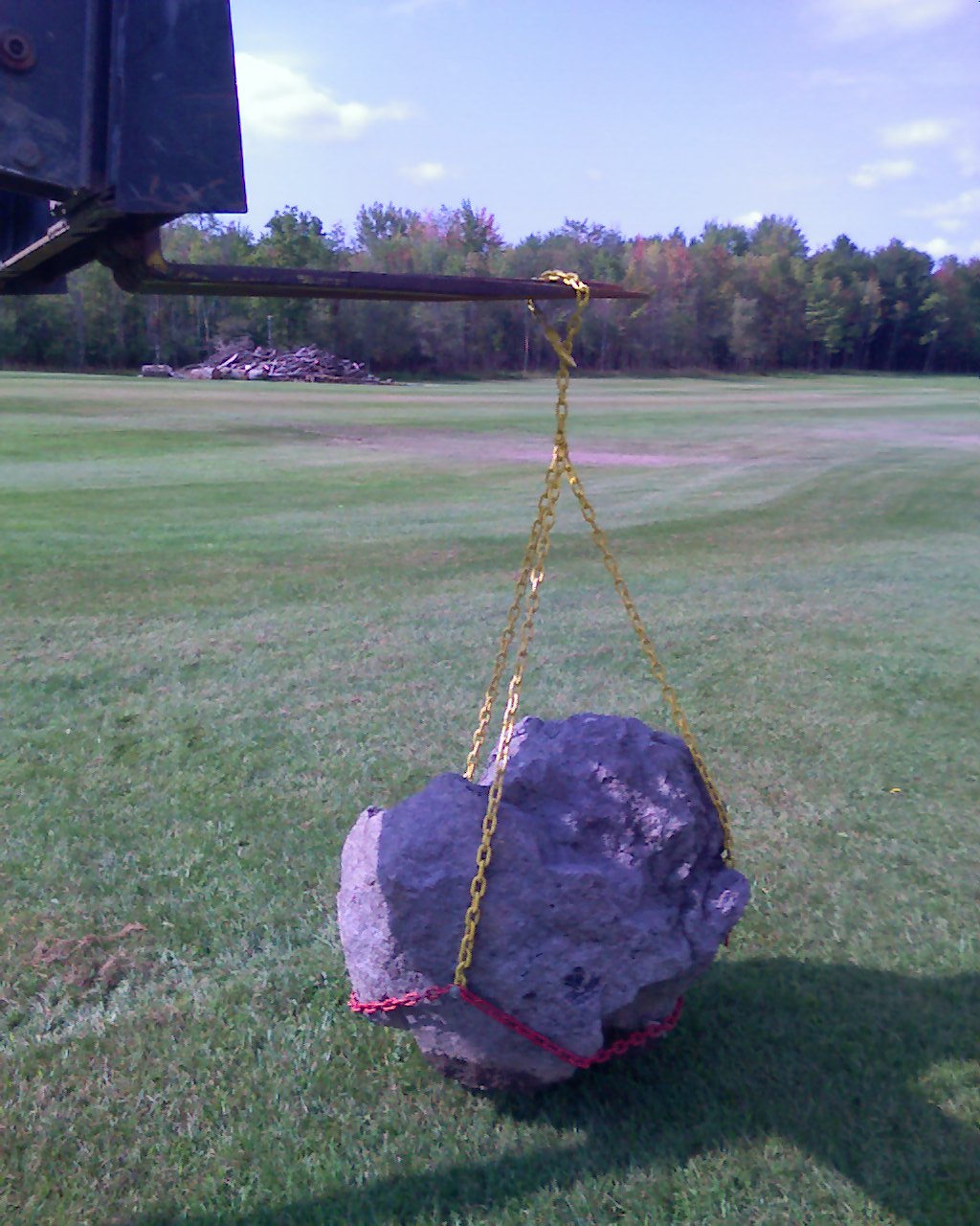

   / best way to move big-ish rocks? #7
Boulder sling, $10 in chain
The paint is to eliminate confusion when tangled.
Thanks for those pics! Very helpful.
- Mike
