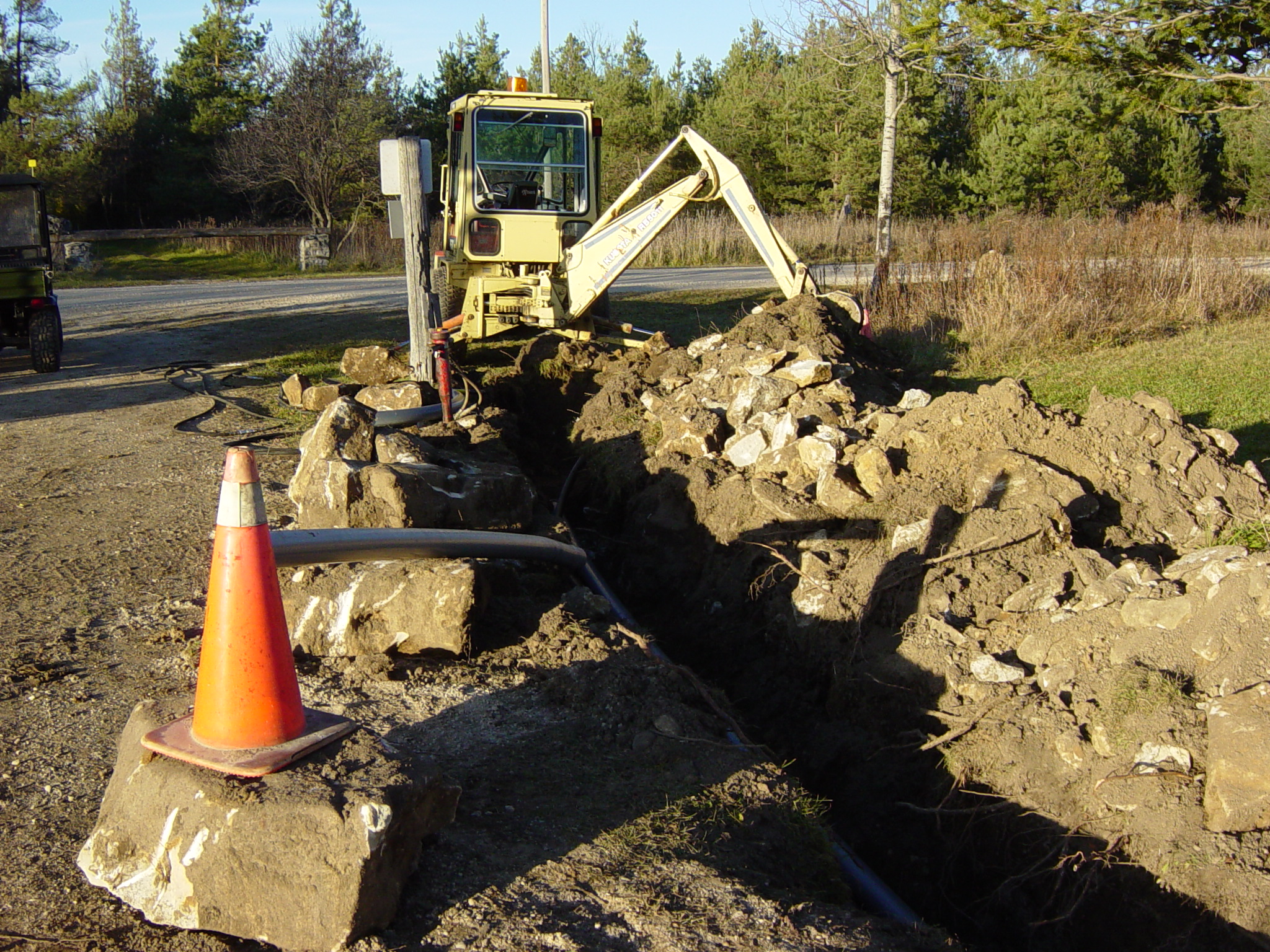

The days of going to the hardware store to get some dynamite are over. I have serious doubts of blasting being an option. I really don’t care how long it takes within reason. I never called the rental place but I suspect the rock hammer is the most economical option. The septic tank is 5.5 feet tall. There’s a possibility of getting a shorter and wider tank but still 4.5 feet tall. As to the fill line I have to dig 330 feet of ditch 36” wide and 24” deep. I don’t think rock will be a problem at only 2’ depth required. They’ve done soil test and mapped out the location and quantity of line.
   / Best way to remove 3’ of bed rock to burry septic tank? #37
I’m not even sure why I recommended blasting. It’s way overkill for a septic tank. If I remember correctly it was like $6-$7k a day. Just rent a hammer or sub a hammer out and use your backhoe to dig out the hammered material. You should be able to do it in a day no problem.

Is a 4-5 ton mini with a hammer adequate for this job? I’ve never rock hammered before.
   / Best way to remove 3’ of bed rock to burry septic tank? #40
How soft is the rock? Does it come apart readily in layers? I have various hand held hydraulic breakers. I love playing with those. The hardest part is how often you have to get back in the hoe to dig out the spoil, then back in the hole to break up some more stone. It would work so much better with two people.
