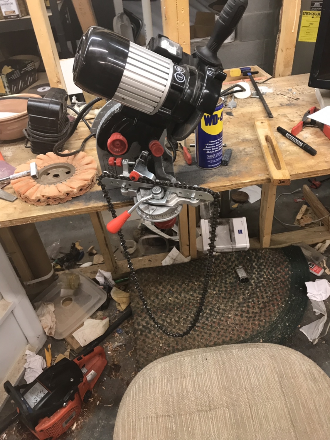

Despite what they tell you very few weekend firewood cutters can freehand file a chain and do a good job. It’s not a skill you’re going to master overnight or probably ever with light use. I had a Timberline jig and it worked really well but it was slow and tedious. I ended up buying an Oregon chain grinder. It has the disadvantage of having to remove a chain but it works well once I got the hang of it. Removing a chain isn’t as big of a deal as it might seem if I didn’t rock the chain or cut dirt one chain would easily cut more than I wanted to split in a day. There’s plenty of tools available to assist in sharpening a saw but I’ve never dealt with most of them.
