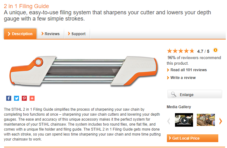

I have an Oregon Bench Grinder. But, I do very much like my:
It is easy to use for a novice, easy to carry to the field. It also hits the depth gauges or rakers, or whatever they are, at the same time.
Pferd makes the same file (I believe they came up with the design) and it is less costly.
