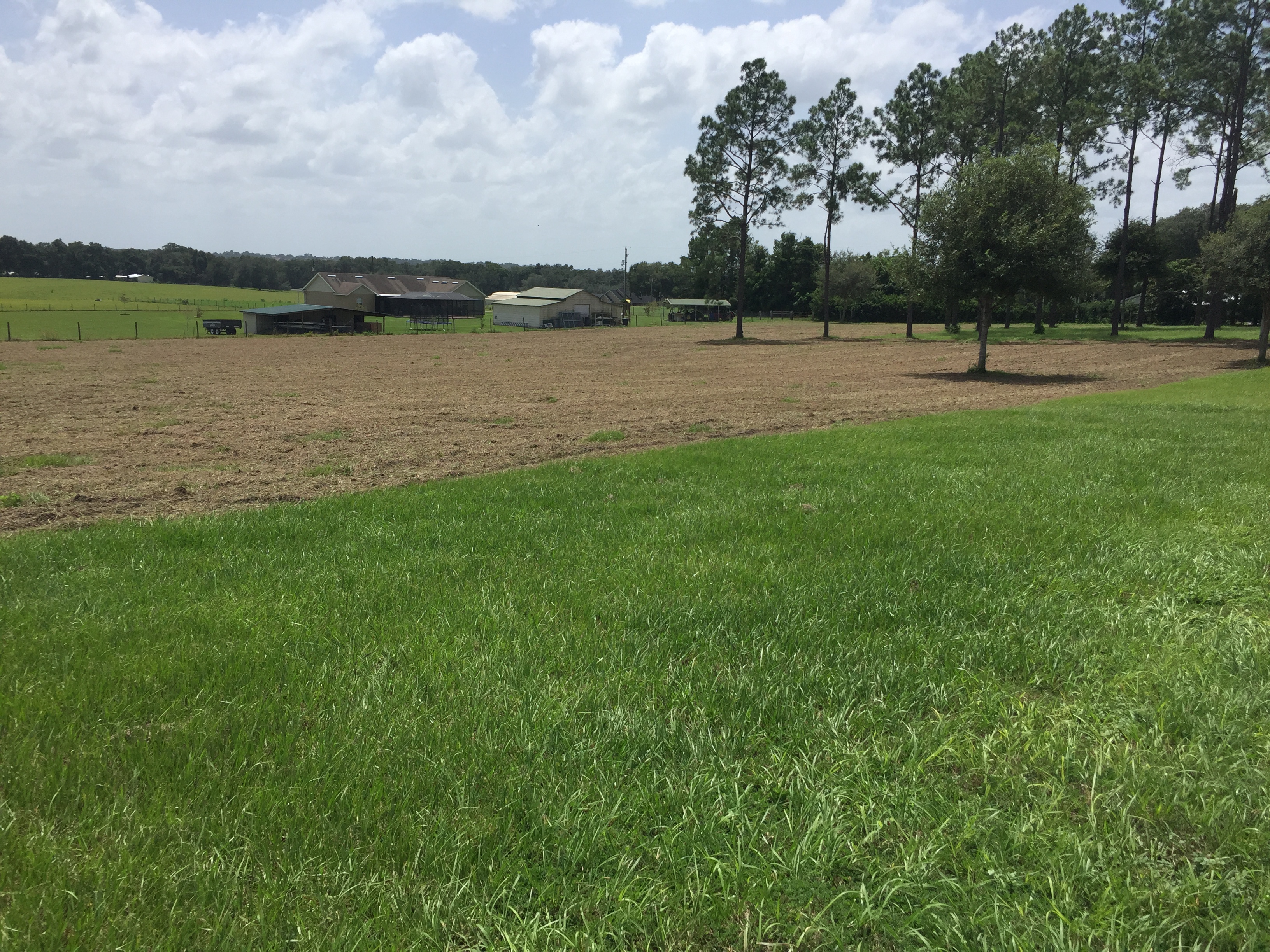

Our property used to have a bunch of pines on it and many were removed and the stumps ground several years back. That's left the land very rough. I've started tilling some sections so I can have something smoother to mow in the future.
I thought I would be able to smooth & compact the tilled dirt with my box blade tipped back on the rear blade, but the soil is so soft that the blade just sinks and digs in when lowered all the way. One caveat here is that I tried doing this when the ground was fairly saturated, so I may have better luck waiting for it to dry out some.
If the box blade method doesn't work, I'm thinking the most economical way I'll be able to get everything smoothed out is by dragging a chain harrow over it multiple times, and hope the combined action of the tractor tires compacting the ground and the chain drag smoothing gets me where I need to be.
Any thoughts? Pics below show what I'm dealing with. There's a lot of bahia grass mixed in with the dirt still. Not sure if I should continue trying to work it into the dirt by tilling more or just smooth it as is.

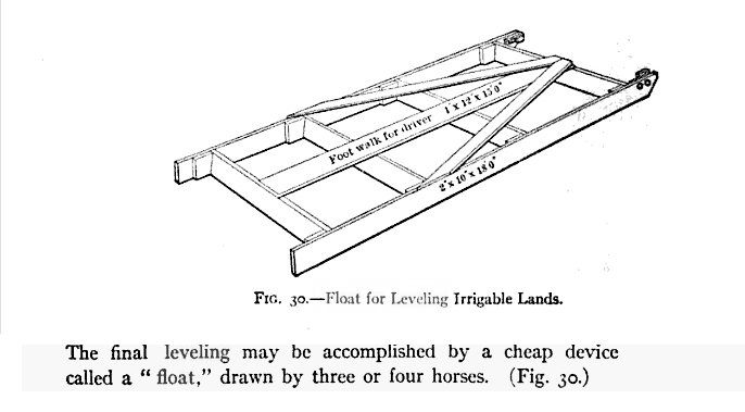

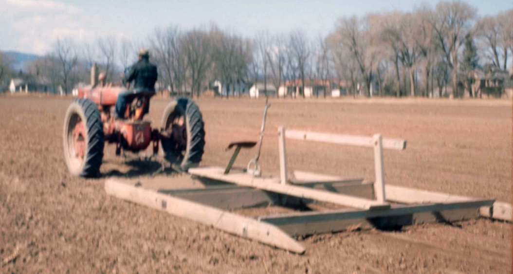

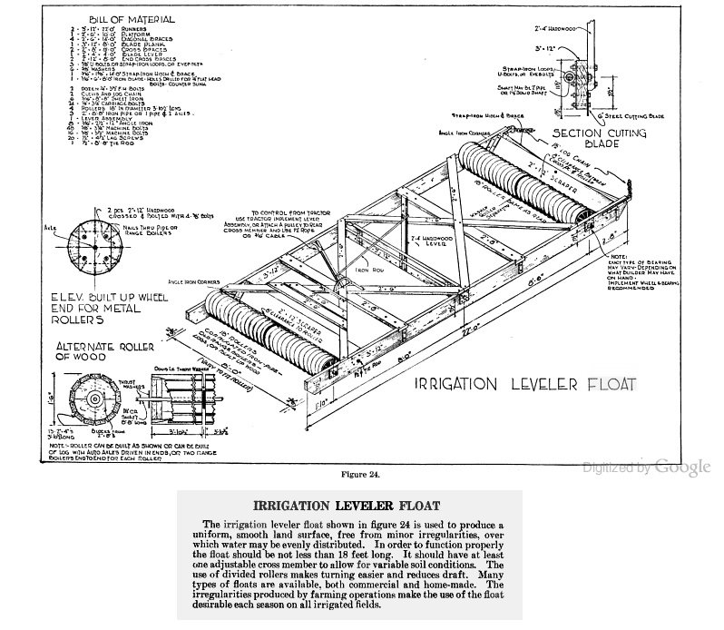

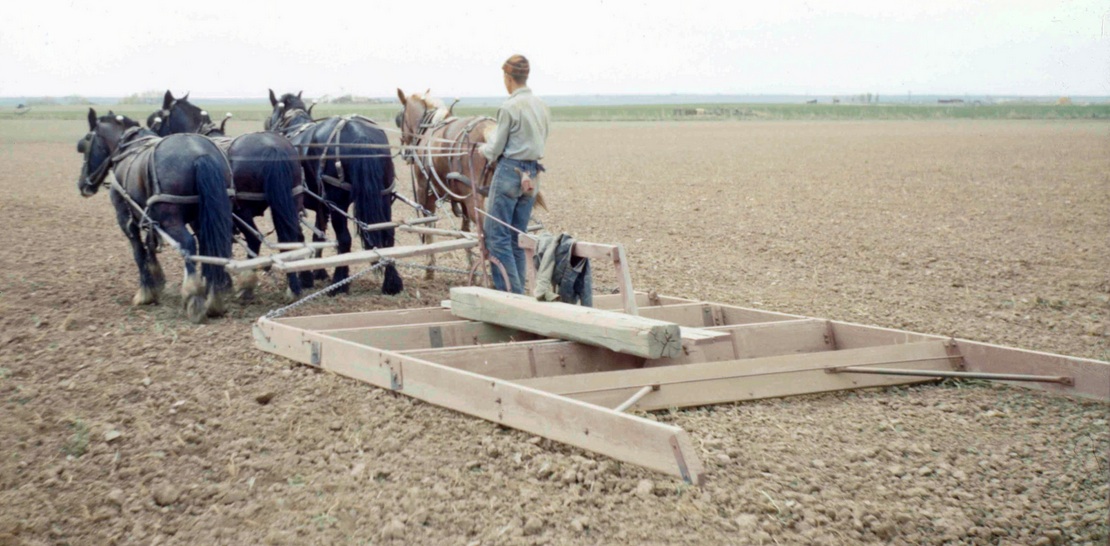

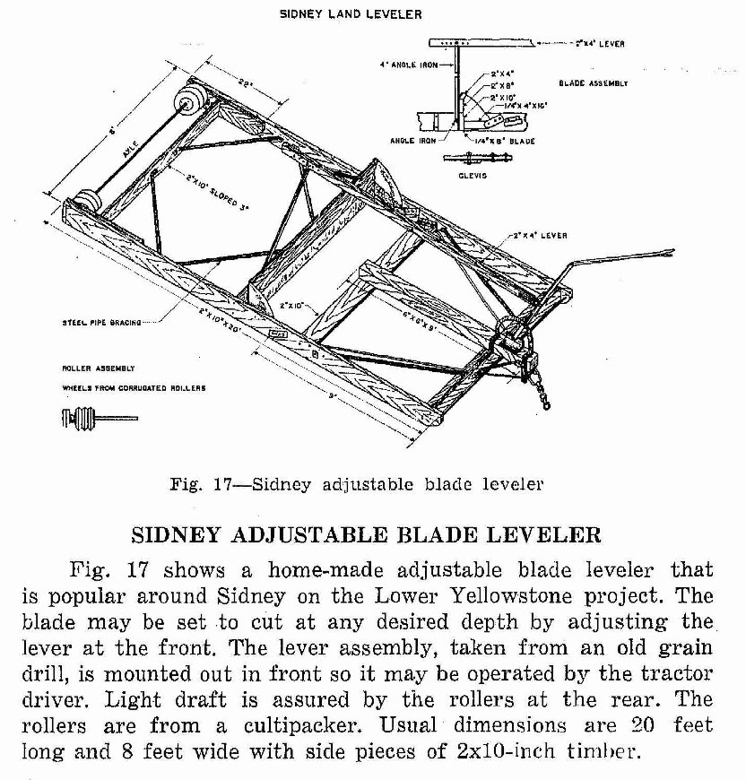

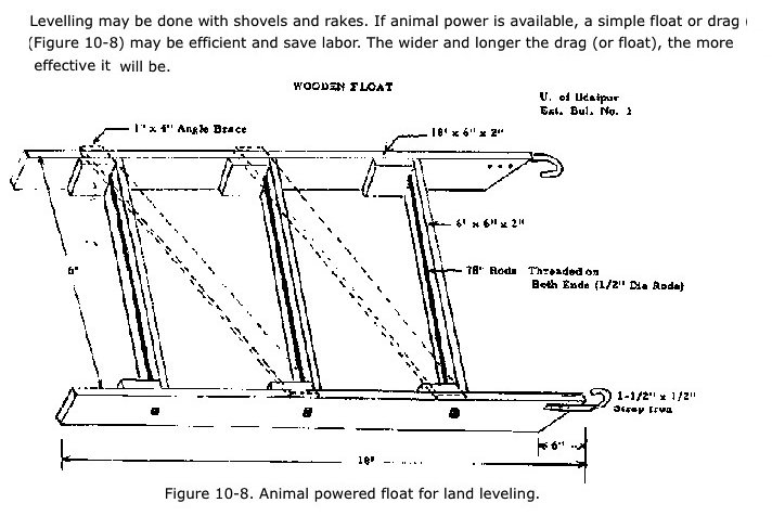

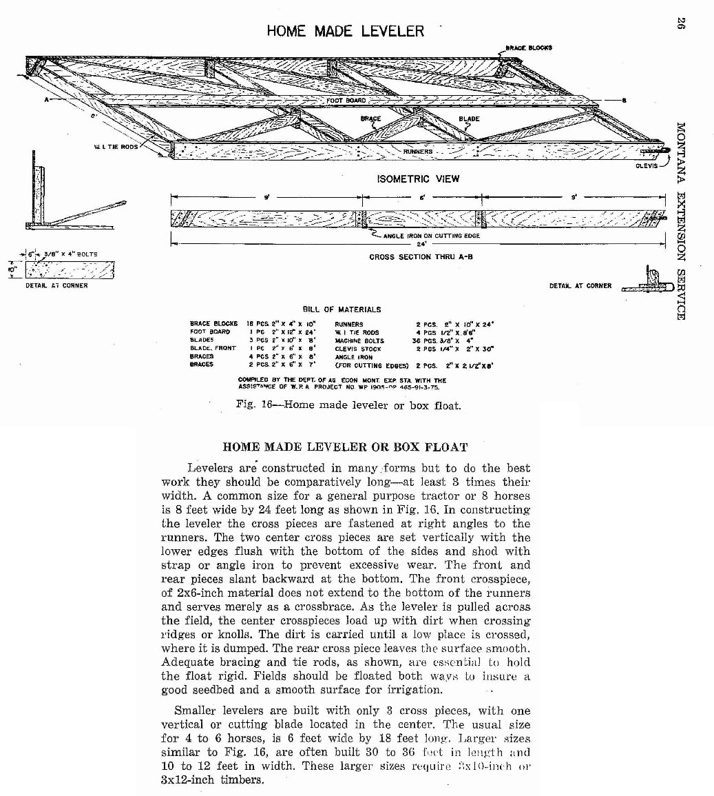

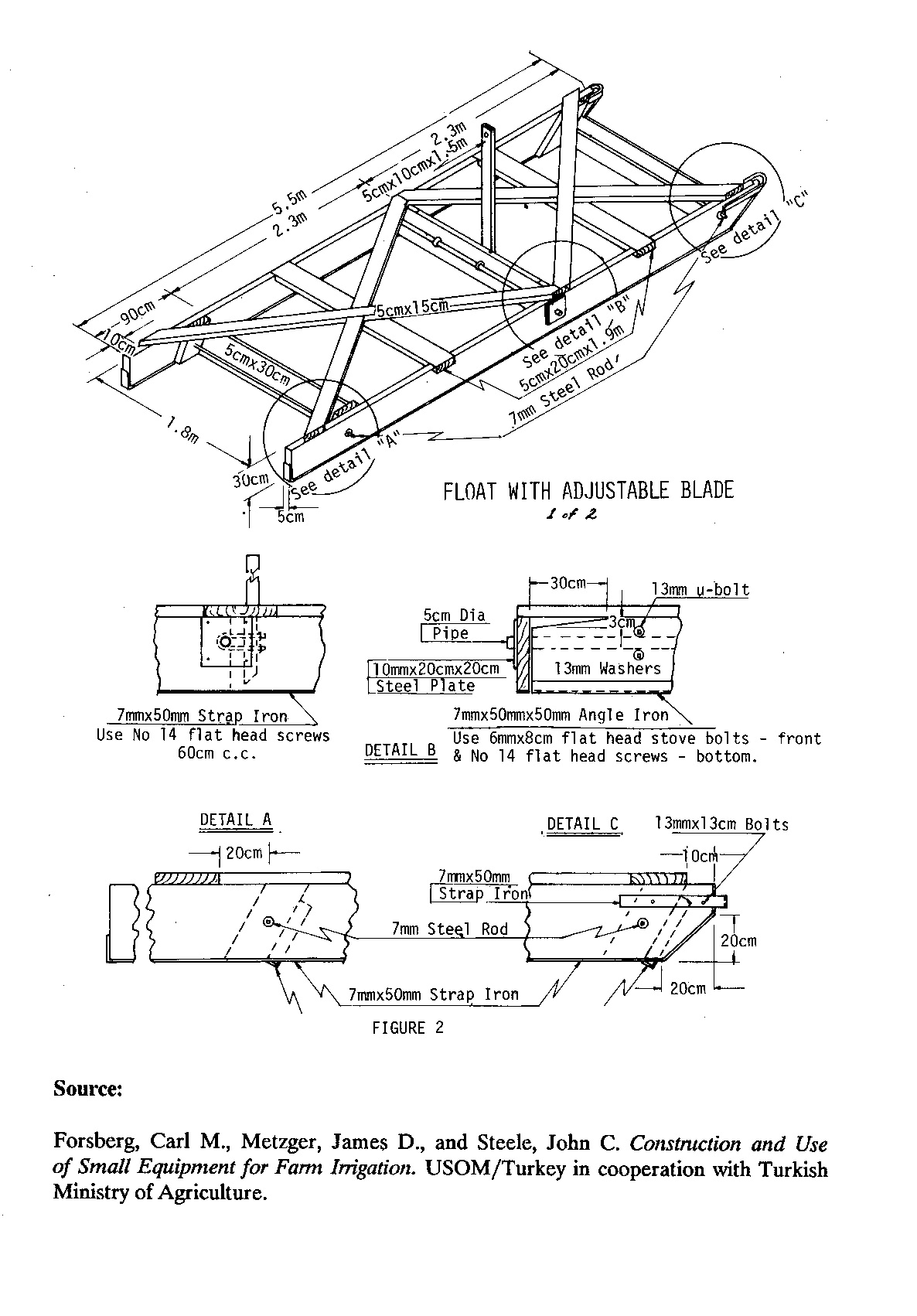

Float7.jpg Float-horses.jpg float1.jpg float2.jpg float3.jpgfloat4.jpg float5.jpg float6.jpg HorseFloatWithTractor.jpg float-8x30-D4.jpg
Bruce

Pictures don't look that bad to me.
I've been working some clear-cut land with disc harrows and a landscape rake. Not perfect but good enough.
In my case I have dug the stumps out.
I wish I had a tiller.
Doesn't seem like a tiller would be happy in ground stumps.

Thank you for all the replies. Stumps were ground in 2013 and I haven't seen any wood come to the surface when tilling down 8 inches so I'm hopeful everything has rotted by now.
I do have a landscape rake but I have a feeling it would get clogged quickly with all the grass that's mixed in with the soil. Additionally, unless I constantly modulate the 3 pt, it will try to dig down in the soft earth as opposed to leveling the surface.
Something I didn't consider is turning the rake tines backwards and somehow cradling a log in the tines with chains or something.
I like that idea better than a chain drag harrow because it would give me the ability to raise the 3 pt and back into the corners. That, and I already have everything I need (would have to purchase the harrow). Might be onto to something here.
