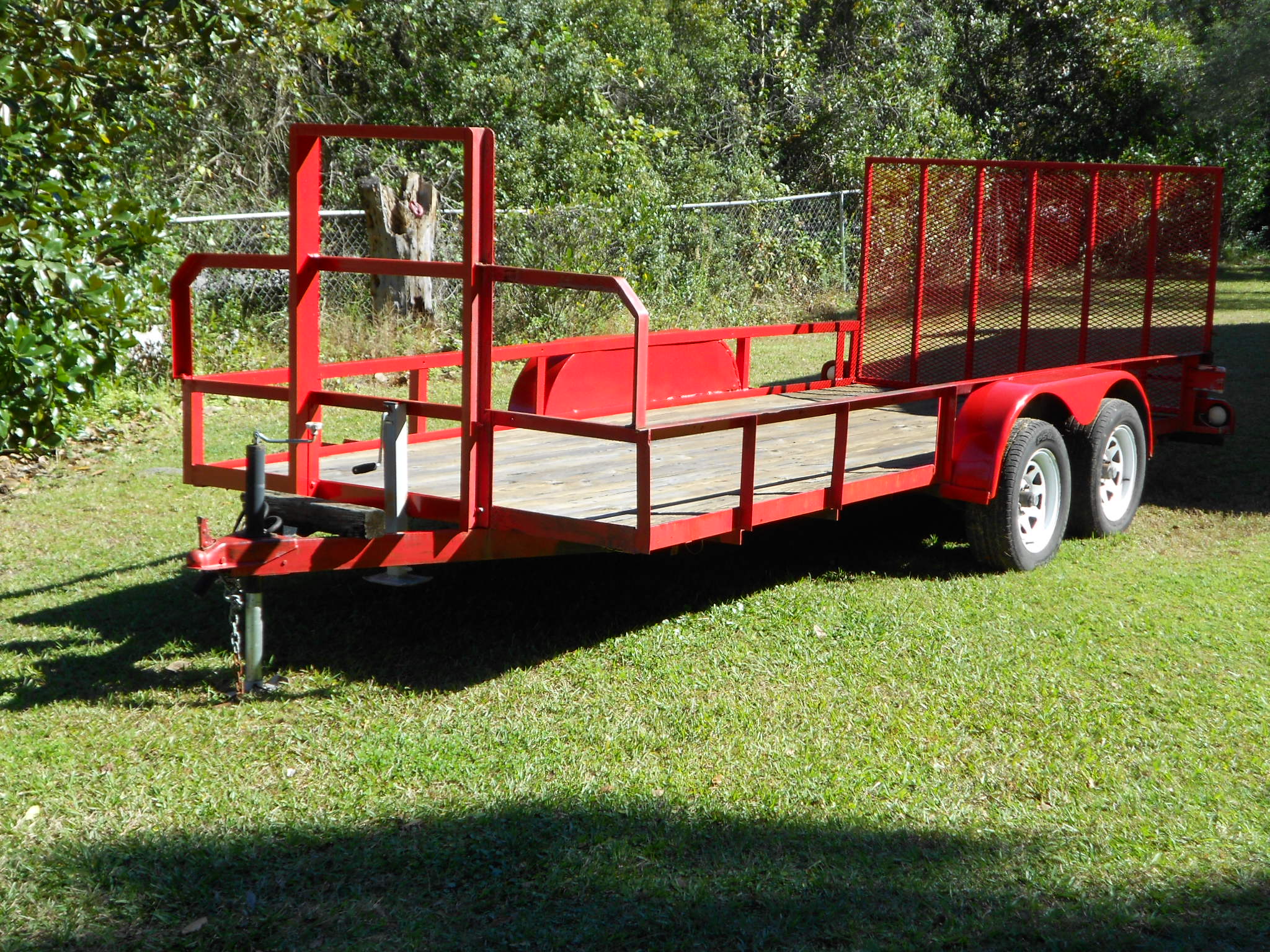

I used old motor oil mixed with used mineral spirits from my parts washer on this older floor.
The sun will bake it in if you do it in the right season.

Thanks, for the replies. I did some searching and found that most people said to use 50/50 waste oil and diesel. Some said 75/25. One bad thing I read about the used oil is some people said that that if your clothes touched the trailer deck it would get your clothes dirty. I'm not sure if they used any diesel or if the put too much on either. Anybody had problems with this? The boards for the truck bed were sawed out just about a year ago. They have been in a building so I'm not sure how dry they may be. I was thinking about treating them before they were put on the truck but IDK if I will. StimW your trailer looks good. I'm still not going to rule out the boiled linseed oil either. I also read were someone on another forum recommended this.TWP Total Wood Protectant - TWP Stain 100 Series by Amteco | Lowest Online Price George thanks on the suggestion on the undercoating. I also read about undercoating the underside of the boards. I may do that on the trailers.
