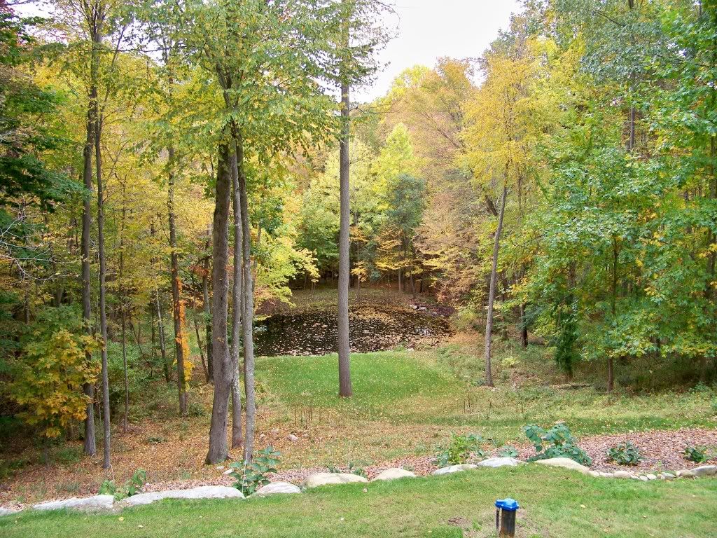

I want to start building a retaining wall...we have no shortage of good size boulders here in CT.
The retaining wall will be on the downslope of a 45 degree hill..or up slope depending how you look at it :laughing::laughing:
Some of these rocks won't fit into the bucket and I am not sure my curl could lift them anyway. So...what is a good way to drag them or get them to where I want them. I was thinking of picking them up via chain but am nervous having them sway and damaging the tractor and blalancing too. I could chain and drag them from the backside of the tractor but then I would be backing down the hill and dragging the rocks backwards.
Any ideas?

I could but I am still learning to use the loader and if one of these boulders starts to roll....there is no stopping it untill it hits a tree or ends up in the middle of my pond. The hill is about 40 - 45 degree...its pretty aggressive. In the picture the wall will be on the right side about a third of the way down

Gorgeous photo! You have a beautiful place.

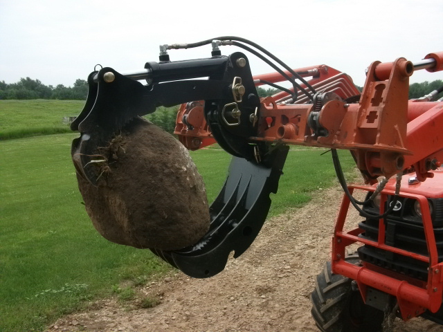

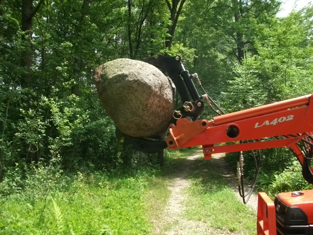

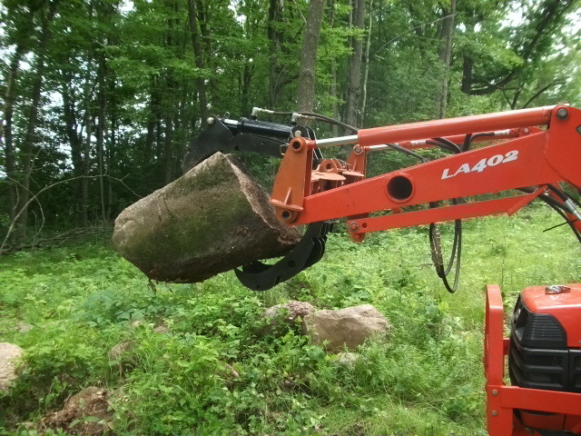

Here is how I have been moving mine, anything larger than 900 lbs. I use the bucket on my bigger tractor.
   / Best ways to move rocks/boulders #8
Magicheater has the best way. you can't beat a grapple for moving rocks or logs.

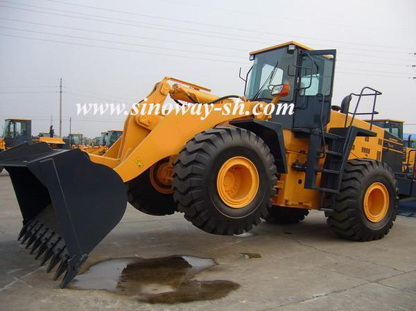

Any ideas?
How big is the bucket? If they won't fit a 'normal' sized bucket, they must be pretty big (heavy) boulders.
Get your hands on something like this:
