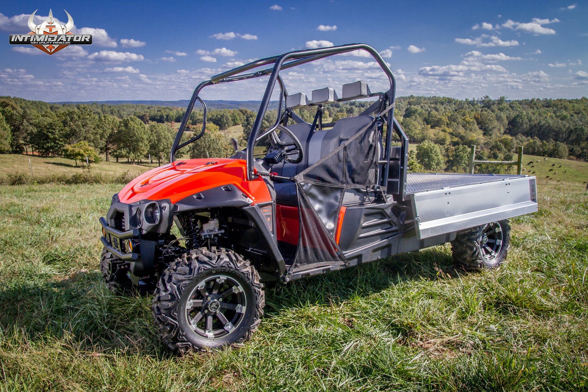

Take a look into the Intimidator UTV truck seriers
Heaviest payload and Towing capacity. 1,600 payload 2,100 towing
Granny gear of 36:1 reduction Lowest gearing in the industry
50% larger wheel bearings and spindles
larger a-arms
27'' rubber stock
Largest bench seat (more knee room and head room)
Gas and Diesel engines available
Have had farmers hook a 8' disc behind one of these and go to work as well!
Truck series
Classic with short box

I like that I have the option of a crew cab with those, as we could fit our whole family if we wanted to go ride at Windrock. What are the differences between the Intimidator 1000cc diesel and a higher-end Kubota RTV? How is it going to handle pulling attachments up a hill? Can an after-market 3pt be attached (not sure that we will, but the option is nice). The closest dealer to us is about 200 miles away, which we'd be willing to drive if we think it's the right fit for us. Thanks :)
The Intimidator will have a wider foot print compared to the Kubota with our 27'' rubber vs their 25'', more speed in the CVT 35mph vs kubota hydro 25mph, heavier automotive grade 4 wheel disc brake and rotors, 50% larger wheel bearings and spindles, 800lbs more towing capacity, Wider and deeper bed with option of the versabed (Aluminum flat bed) front and rear 2'' receivers.
Currently no 3pt mounts available but many different routs to hook up implements via 2'' receiver and a full 4 point frame mount.
Our granny gear of 36:1 is the lowest on the market allowing you to scale any hills with whatever you're pulling.
