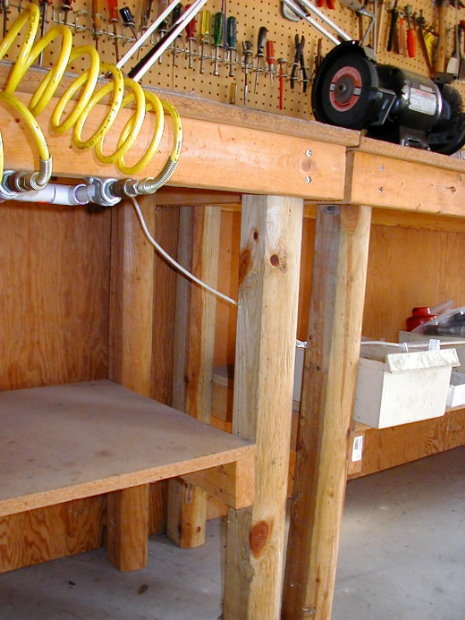

This is not a very good picture, but shows the ends where I put two workbenches together. The landscape timbers for legs were cheaper than 4 x 4s, then used 2 x 4s around the perimeter under the top and a single one under the center of the bottom shelves. Both the top and the bottom shelf for each bench came from one 4 x 8 sheet of 3/4" particle board, and it's all put together with 3" countersunk screws. They're solid and heavy and serve my purposes well in the shop. I have a 4" vice mounted on one corner of one of them, and a 6" bench grinder and a 3 ton arbor press mounted on the other. Of course, you would not want to get them wet. Particle board is much smoother, harder, etc. than plywood as long as you keep it dry.

Good idea with the air lines. Looks like it would stop you from having 200ft of air lines all over the floor.

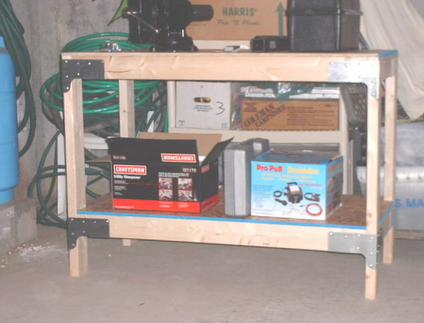

A couple of weeks ago I needed to quickly fab a small workbench for the basement here at camp. Home Depot had reinforcing brkts along with screws packaged together for building workbenches or shelving.
You supply your own lumber.
Makes for a very solid assembly./w3tcompact/icons/grin.gif
Back at my main place the workbenches (3) are steel framed tables.
1 1/2" round pipe legs with 1/2 nut welded to the bottom for adjustable feet, with 1 1/2" pipe crossbracing, and uses 1 1/2" angle for the rest. Originally all had 3/4" particleboard tops. The tops have seen their better days though. I'm probably gonna replace them with 5/8" OSB.

DFB, besides the two I built (shown in the picture I posted), I also have one that looks exactly like yours. My youngest daughter bought a house several years ago when she was single and built it for her garage. When she got married, she gave it to me. My drill press and belt sander are mounted on it.

"and a 6" bench grinder and a 3 ton arbor press mounted on the other."
Bird
I used to have my bench grinder on a wood bench similar to yours.That all changed when a friend of mine had the same setup and was grinding some iron.He left to go to town and came back to a garage on fire.Hot embers caught his woosd bench on fire and burned down the garage.I immidiately took mine off the wood bench and made a grinder stand on wheels for the grinder.Now just roll it to the job, lock the wheels and grind you little heart out.I will try to post a picture later.
