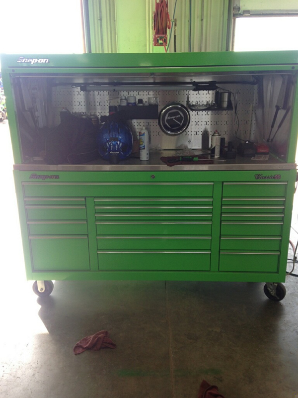

Watch craigslist swap meets or garage sales. I hate chinese HF tools. You can find sets from mechanics getting out of the business or what not. Some get hard up for cash and unload tools. I bought this less than year old snap on box for a $1K, threw in another hundred and got some pullers and compression test kit. Guy that lives behind me buys used/broken snap on for little to nothing and trades it on new. I wish I had the money back from cheap tools I wasted. You don't have to buy premium tools at premium prices.
