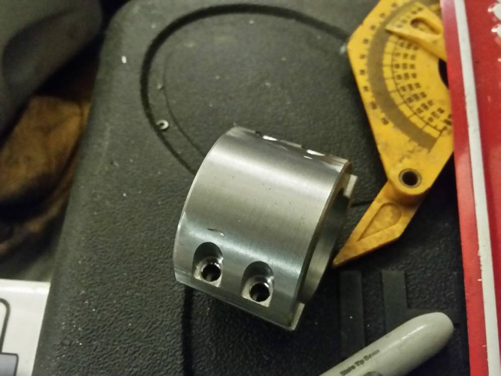

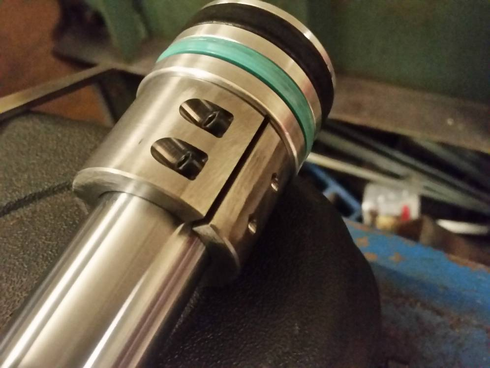

I don't know. Regardless...I have everything good to go except the extension/contraction can be over-extended if I am not mindful. I wonder if a cylinder can have the same contracted length, but have a slightly reduced extension length. That would be the easiest solution to the over-extension problem that allows the shaft to contact the mounting frame if I or my son am inattentive when using the extension feature.
   / Betstco Flail Missing Parts And Very Poor Quality Control. #54
It can be done but not easily, I did make one on a cylinder for my BH thumb as I was working with what I had for a cylinder and it was a little long on the stroke.
It was an internal stop.
Might be better off seeing if there is a way to make an external stop.
