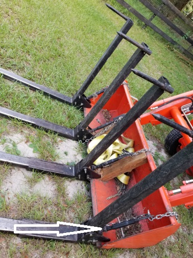

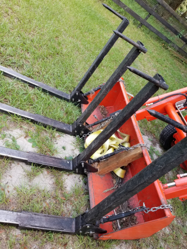

My tractor came with some kind of aftermarket forks on it. I will include a photo. These forks are unbelievably useful. I pick up brush with them. I carry logs carrying hundreds of pounds. I use them several times a week. I even use them to move large packages.
Problem: they are nearly impossible to remove. They're attached with 4 turnbuckles which I can't budge with a breaker bar. This means the front end loader bucket is useless. That's a big problem.
I am wondering if anyone here knows of a better product. It can't be just two pallet forks, because they wouldn't hold much brush. I need 4 forks.
I was also wondering if it's possible to just get another bucket. I don't know how easy it is to remove and install buckets, but maybe it's better than screwing with these forks.
It would be great to be able to drop the bucket and pick up a totally different forked attachment when I need it.

For removing the current binders, I would use a pipe wrench with a piece of pipe over the handle if needed to make it longer and give you more leverage. Then, I would try lubricating them with some chain lube and drilling a hole through the center of the pipe part to put a bolt into to give you leverage when adjusting them.
If that doesn't work and you need to replace them, I would use 1/4" or 5/16" screw type chain binders such as: Amazon.com: Ratchet Type Chain Load Binder 1/4": Home Improvement

Since I don't know your experience with turnbuckles, I will ask the obvious: Did you loosen the locknut?
If that doesn't work, bend the hook up to release the chain.
It has been a while, but I'll bet I didn't. I'll go back and check. I would feel pretty stupid if that worked, but it wouldn't be the first time.

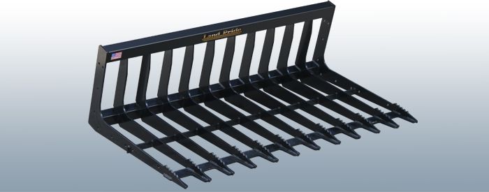

I would still love to have something that replaces the whole bucket, but since no one has suggested such a product, my guess is that it doesn't exist.
The closest thing to that would be either a manure bucket, or a grapple (such as the small ones made by Everything Attachments).
Both would have a shorter tine on the bottom, but with the grapple, you could squish the pile.

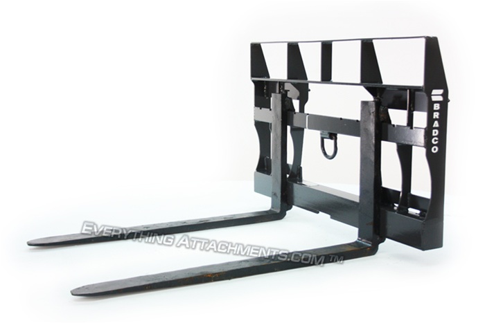

If I could find a way to put two extra forks on a pallet attachment, I'd be in business.
/ Better Brush Forks? #9
Notice the notch in the frame at the bottom, that is where the forks go on or off. just buy two extra forks:
/ Better Brush Forks? #10
Yep, and if they are the type that uses a ground rod to attach the pork to the carrier, you can put two on the rod and have 4 forks that way.
