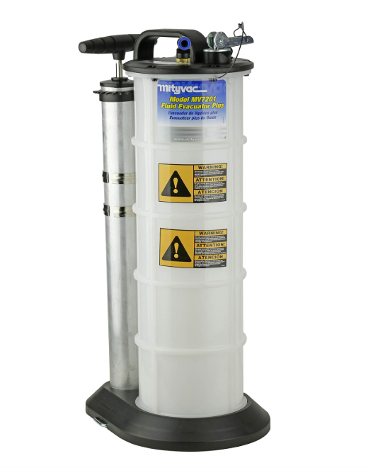

I bought something like this on Amazon. For what you want to do it would be nice. I always remove drain plugs when doing fluid replacement because I don't trust the tube to get it all. It is useful when transferring oil, fuel and hydraulic fluid.
