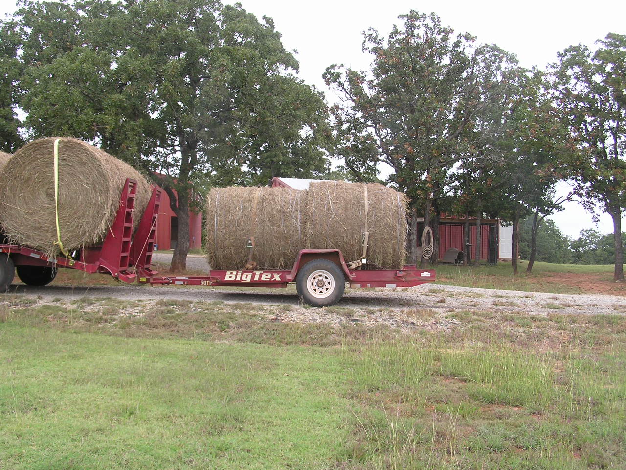

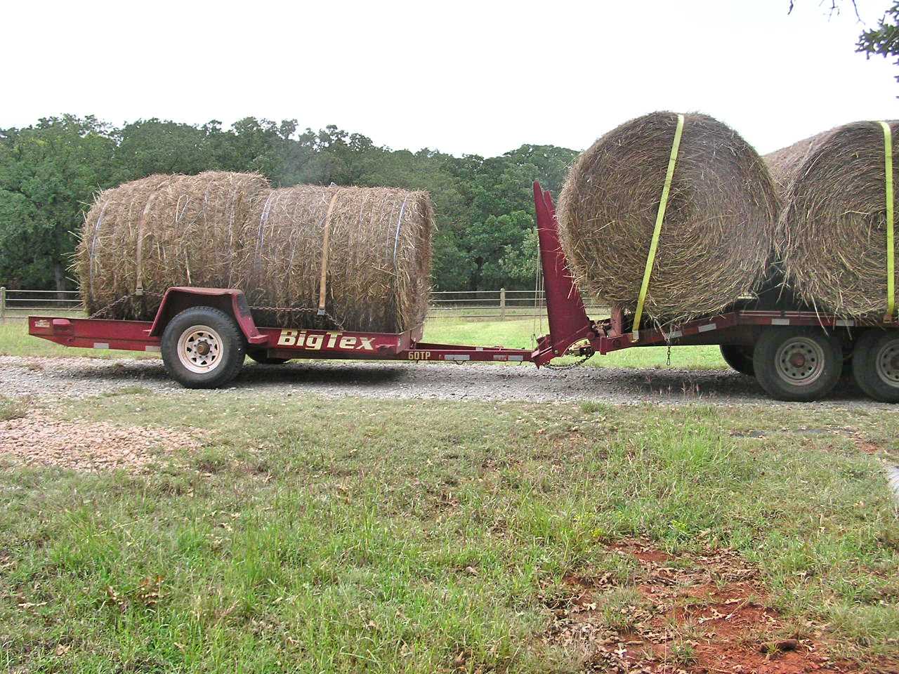

I use one heavy chain between the D-rings on each side of the tilt trailer for round bales:

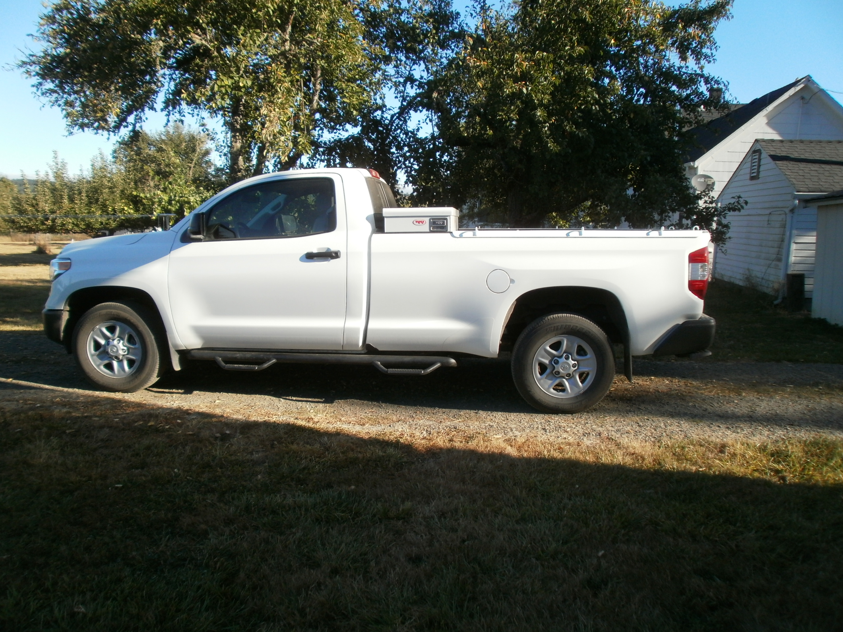

P8240002.JPGI have no use for canopies or toppers. This is what I do for bedrails on all my pickups.Stout as stout can be. I can put binders and chains on there no problem, Heavy duty yes, over kill, maybe. does work for me with anything of value and weight. Unbreakable I guess, never have rolled one of the trucks over to find that out
The steel is bent on a brake in a custom fab shop. Modern pickups don't have straight beds anymore. They have a taper front and back. So the rails need to be cut after forming. A small triangle is cut out of the side. Bent back to fit and welded, ground down smooth. The hooks are made and welded to the sides. Side rails are sitting on top of OEM plastic crap and bolted through with stainless nuts and bolts. Tail gate gets the same treatment.
