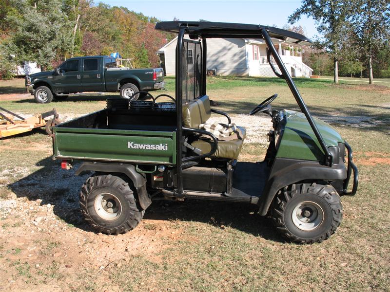

Here is a pic of my 2002 3020 mule up with 25x11x10 goodyear tracker Ps on it. They scrubbed in the front but I added about an inch of lift up there and also trimmed the fins under the fender and now its ok.

The tires do real well. With mine being two wheel drive I need all the traction I can get. Here goes with the pics again.

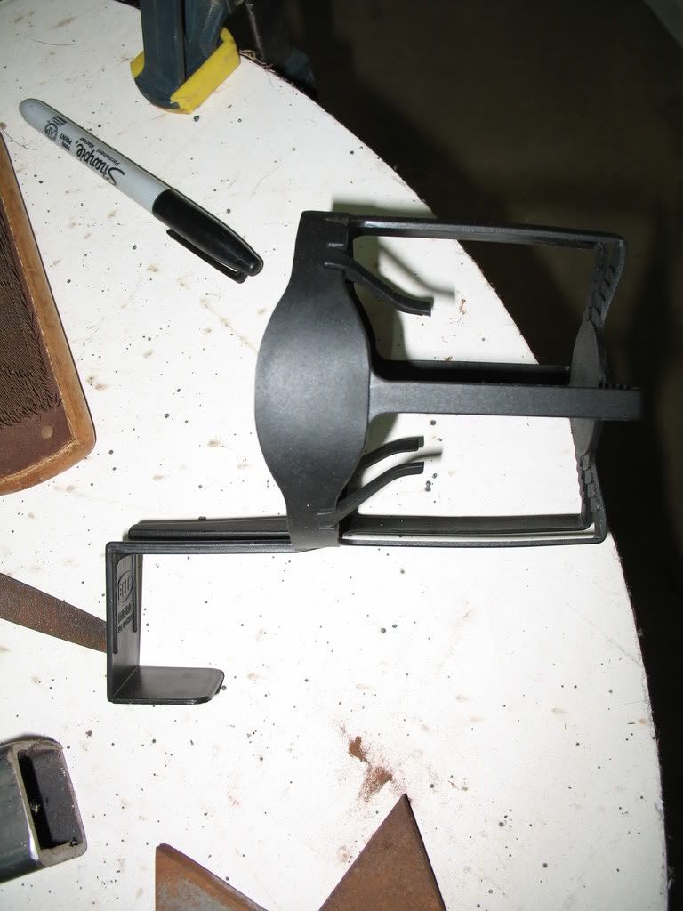

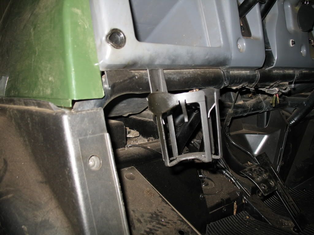

I like the pop can holder. Is that a factory option or one you did? Can you get a close up picture ?

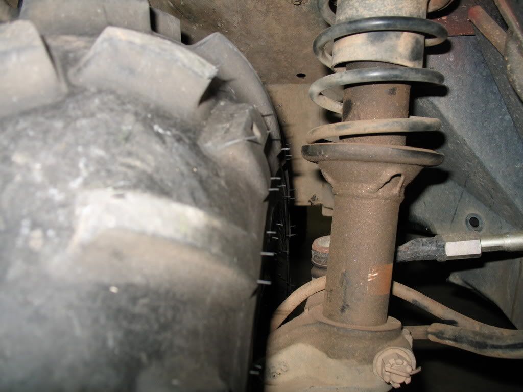

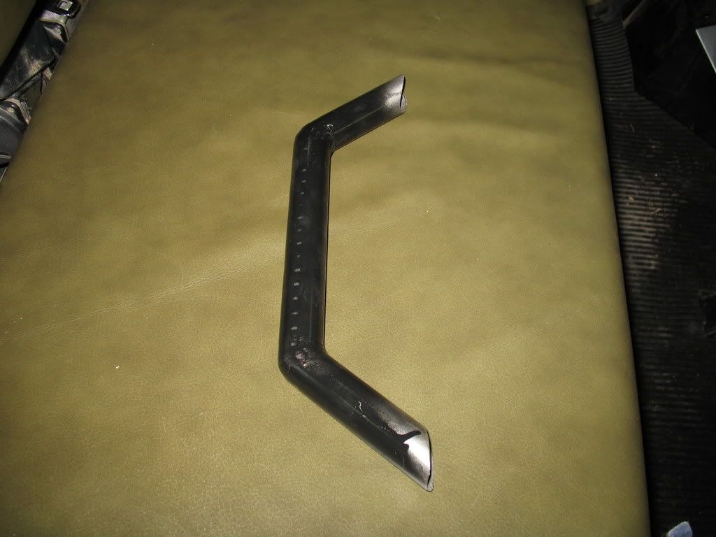

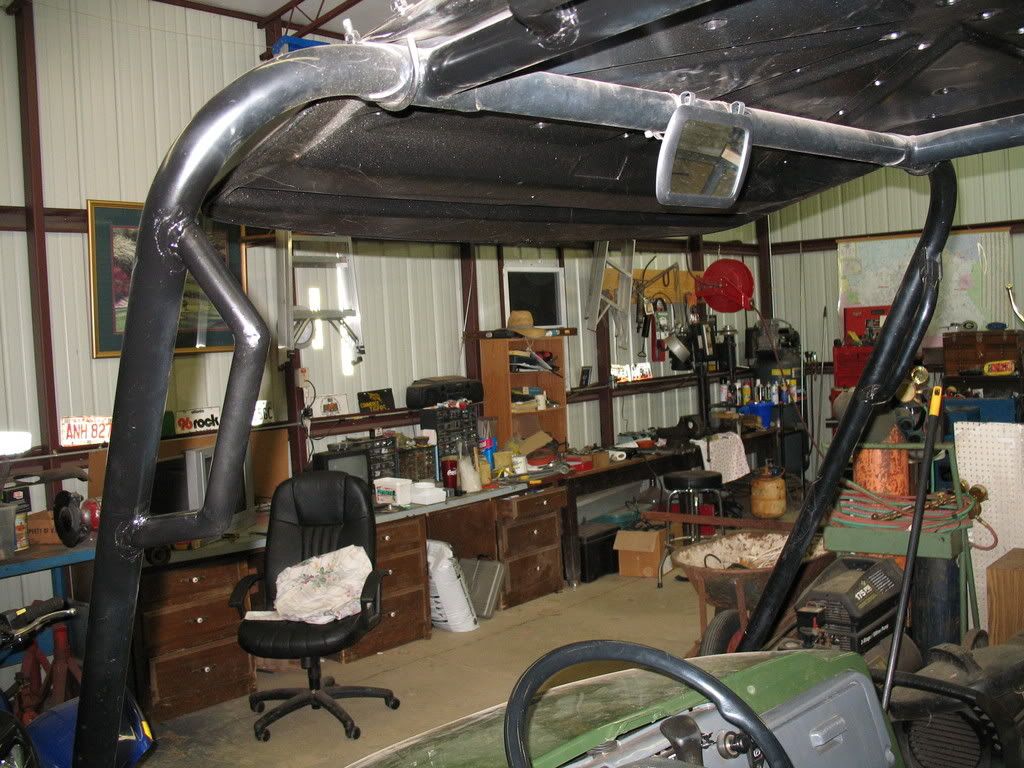

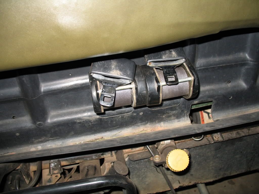

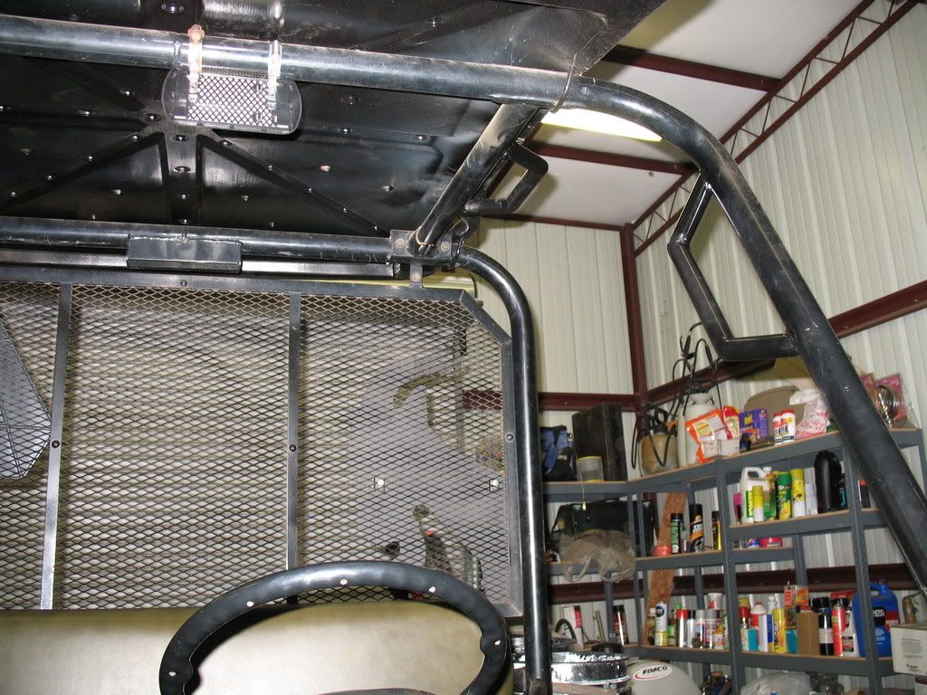

The cup holders are from walmart. Just hook them over the round tube that runs under the dash. It works real good like this. I also had some old vw retractable seatbelts lying around. Put the mule seat belt onto the vw mechanism and it works great. also fabed up some extra handles and welded them onto the drivers side rollbar. I also included a pic of distance between my tire and the spring.
Ken

Wow, your springs are way way way farther from the tires. My tires are 25x11-10's and they are touching the spring mount and the bottom 2 coils.
