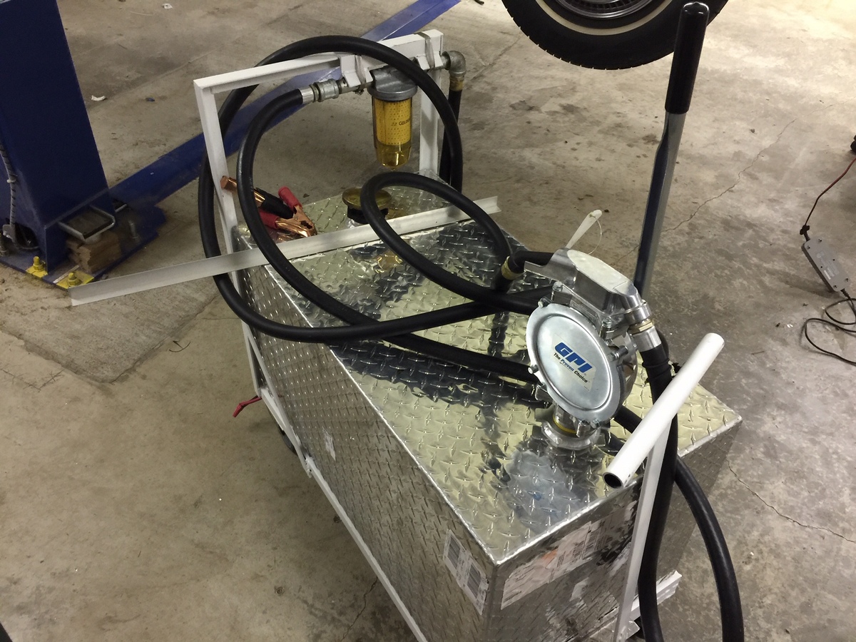

I just made this in the last couple of months. Scored the gasoline rated 50 gallon transfer tank from Amazon as 'used', which I'd never seen before. It was an unused return I'm sure, but saved $180. Made the cart and wanted a manual pump. Pump takes 5 pumps per gallon (measured), which I can live with for my application. I only fill the Eldorado enough to get to the local non-ethanol gas station. I live in earthquake country and my 12 kw Generac propane generator (2004 era) is a piece of junk. So I purchased a 7 kw gasoline unit to 'backup my backup'. I also have 76 Eldorado and several motorcycles that I only fuel with non-ethanol gasoline, so it works out well. For what it's worth, Toukow

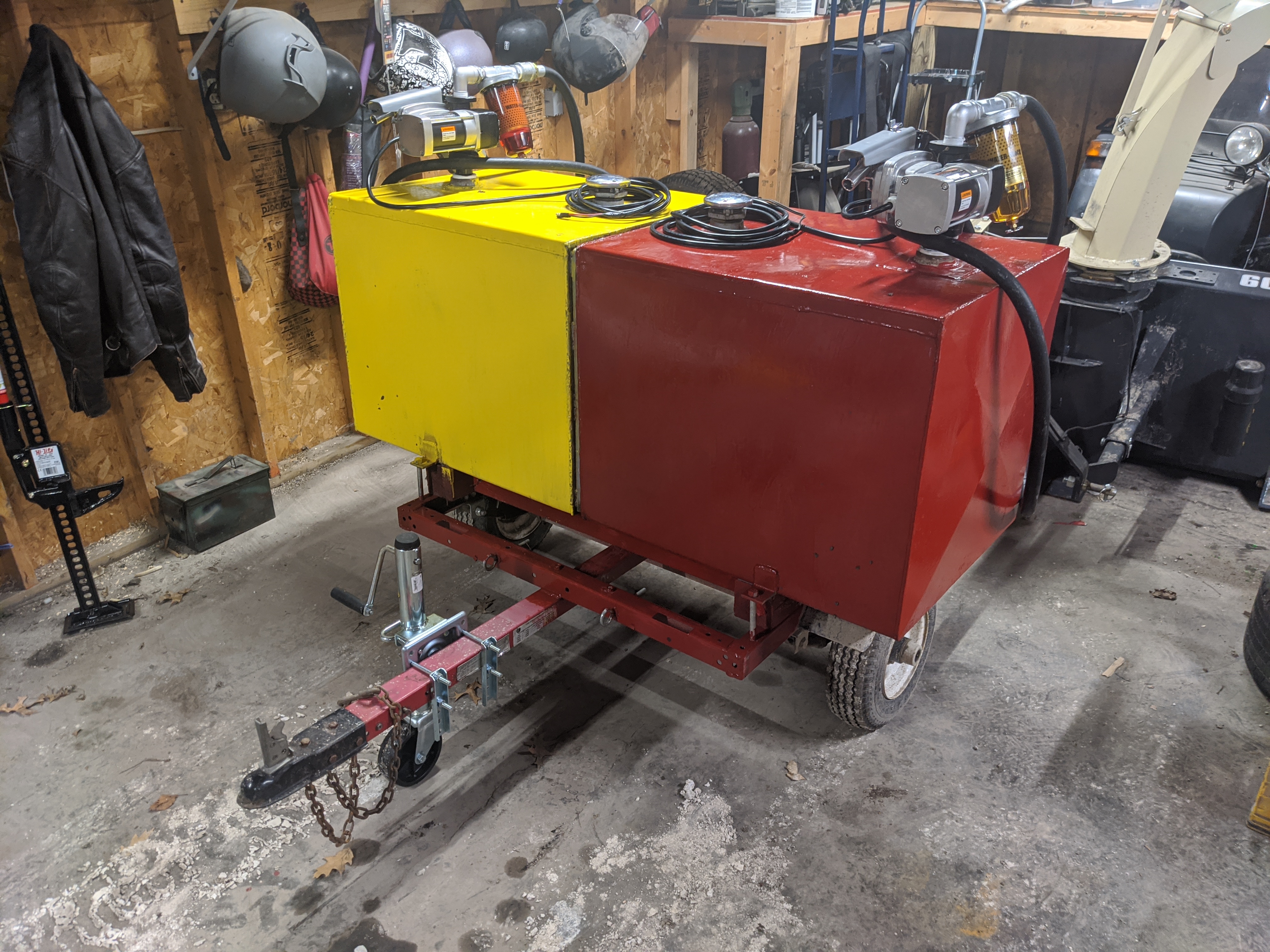

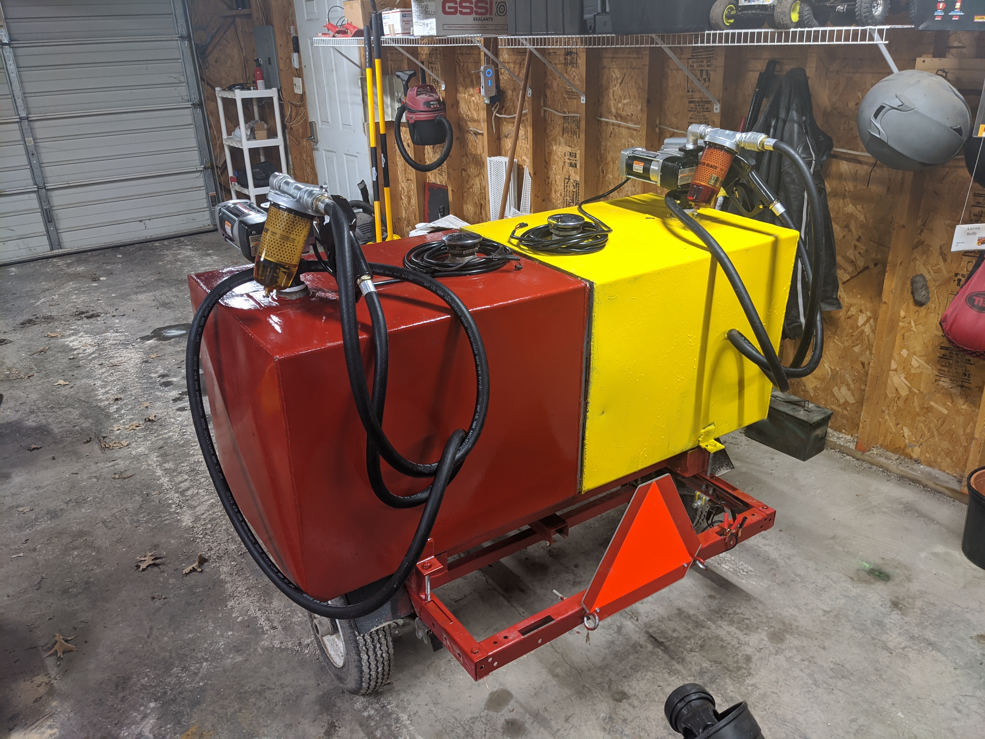

They have gasoline rated tanks and gasoline rated pumps, just rig you up a fuel transfer tank for unleaded.
I did a half/half setup on a small trailer - works well.fuel trailer (1).jpgfuel trailer (2).jpg

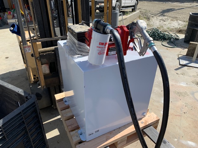

I just built this this week. 50 gallons, homemade pallet to fit the tank, 15GPM pump run off a battery. Makes me wonder why I didn't do this years ago. Fill ups now are a dream. Pull uo pump the fuel in less than two minutes done. Plus the red diesel is half the price of #2 that I have been buying

   / Better way to gas up? #10
Shouldn't that yellow tank actually be painted green?
Yellow is pretty standard for diesel storage. If it wasn’t idiot proof enough already some stenciled letters would fix the problem.
