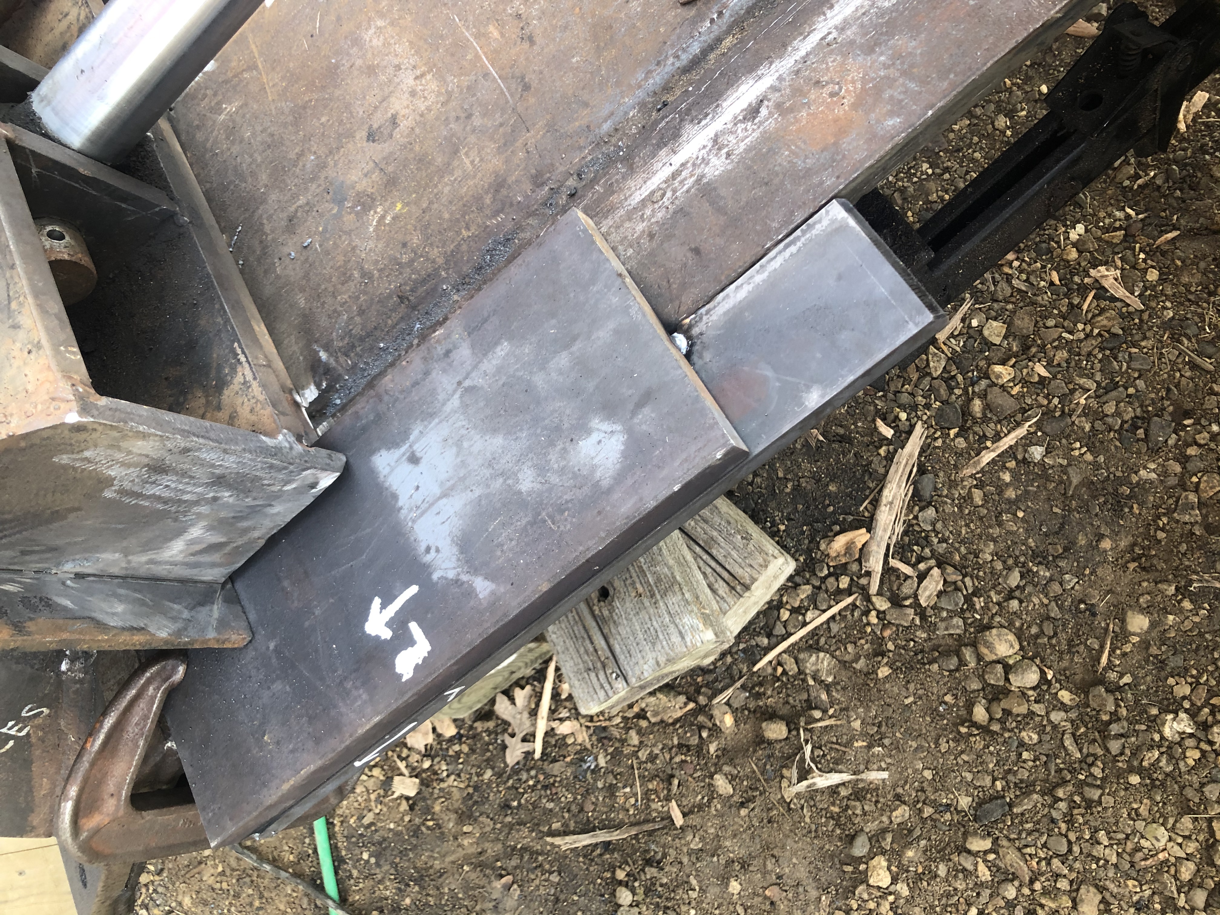

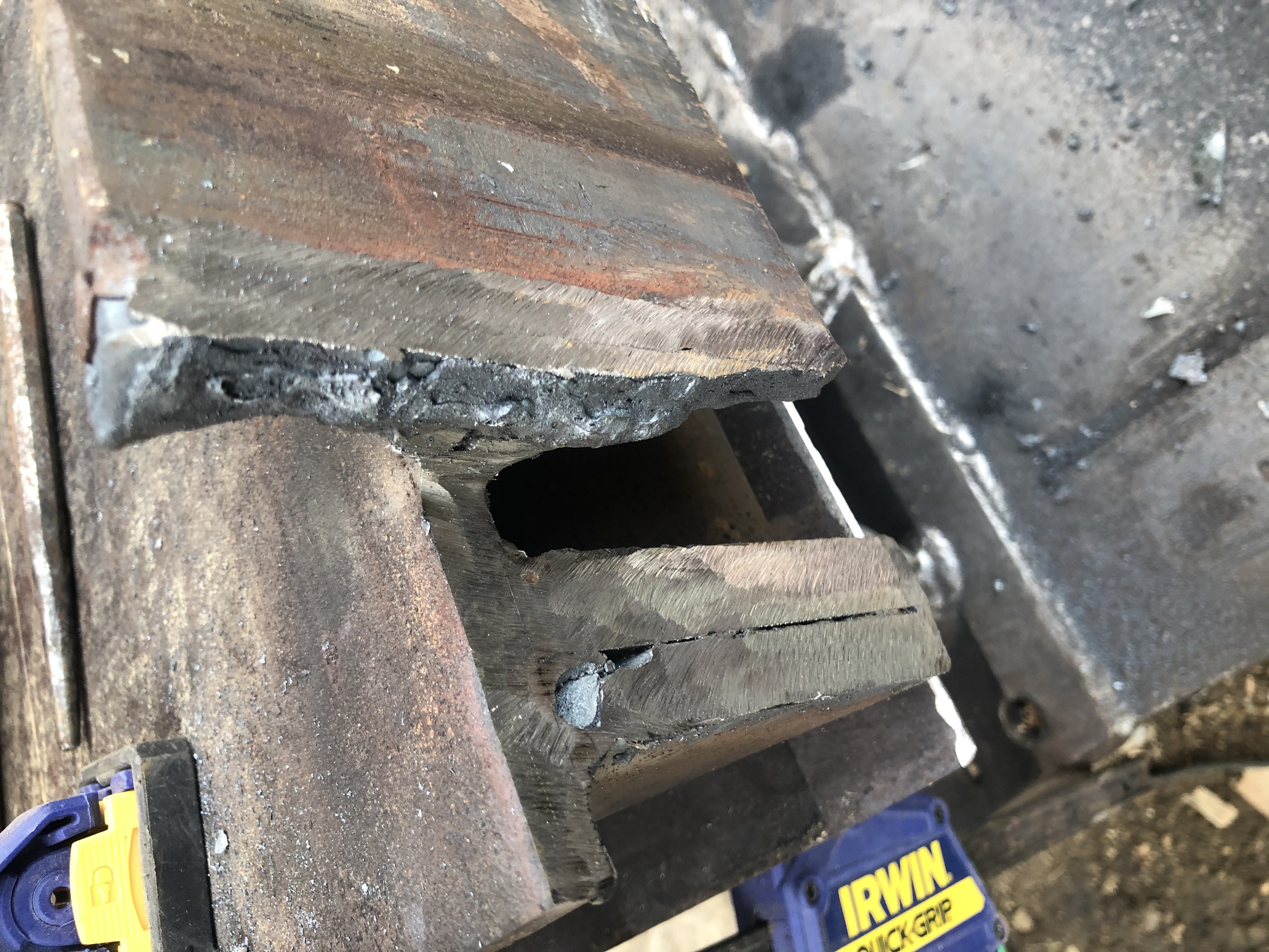

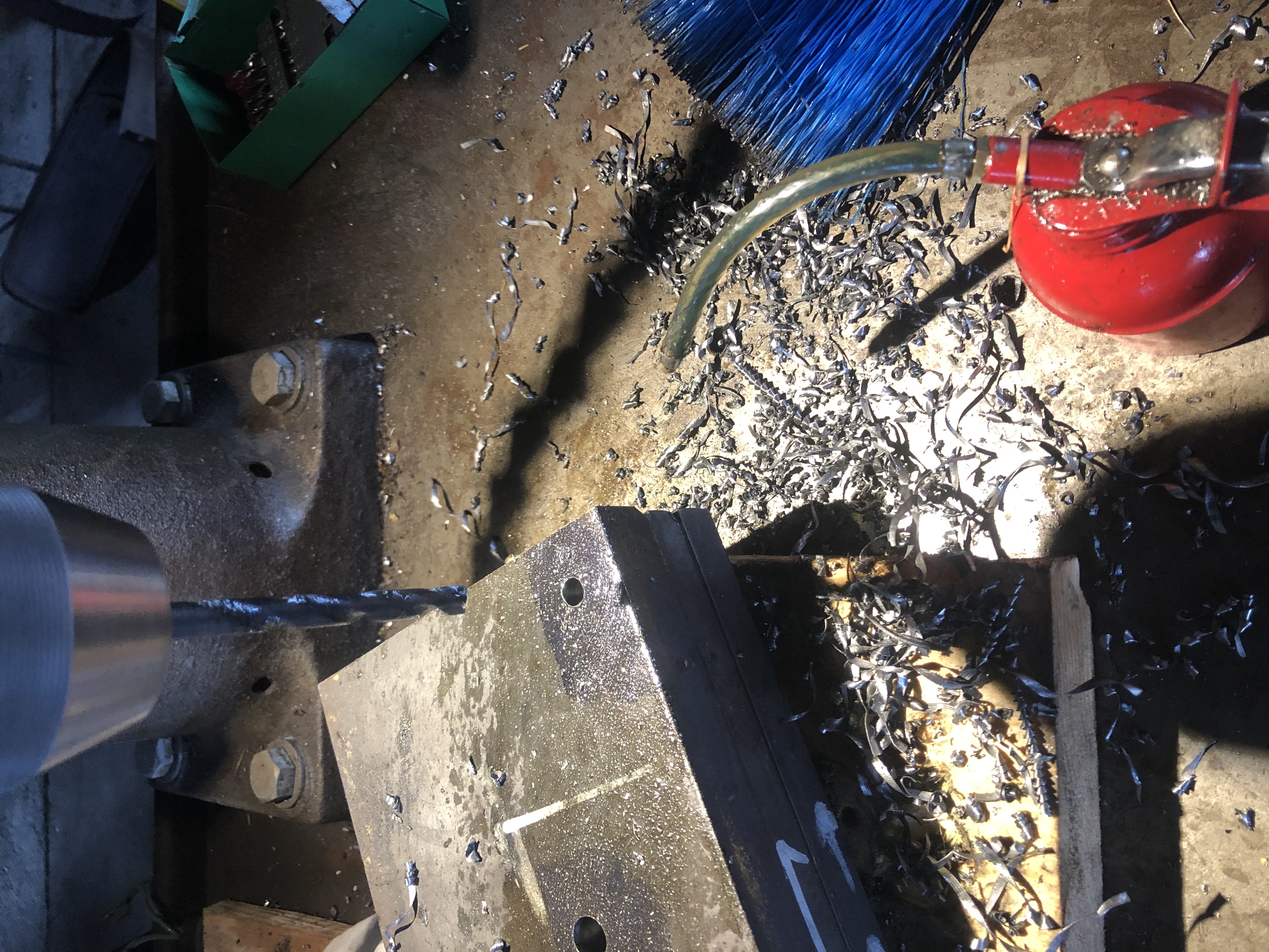

Dec 27, 2019 / Bevel prep for T joint? Thread Starter #21 OP C Cord Veteran Member Joined Mar 21, 2005 Messages 1,720 Location Richfield, Wi Tractor Resident Architect Mocked up the slide assembly. Once I had it set up, I then tack welded the pieces so the couldn稚 shift as I was drilling them. Each assembly was about 3 thick and was held together with (4) 1/2 grade 8 bolts. Attachments A03EB0B4-00BA-4F8A-9175-CC1263EDD216.jpeg 4.3 MB · Views: 161 1BAE7C0A-D3F0-45A9-AB0A-F9037635E2D2.jpeg 4.1 MB · Views: 172

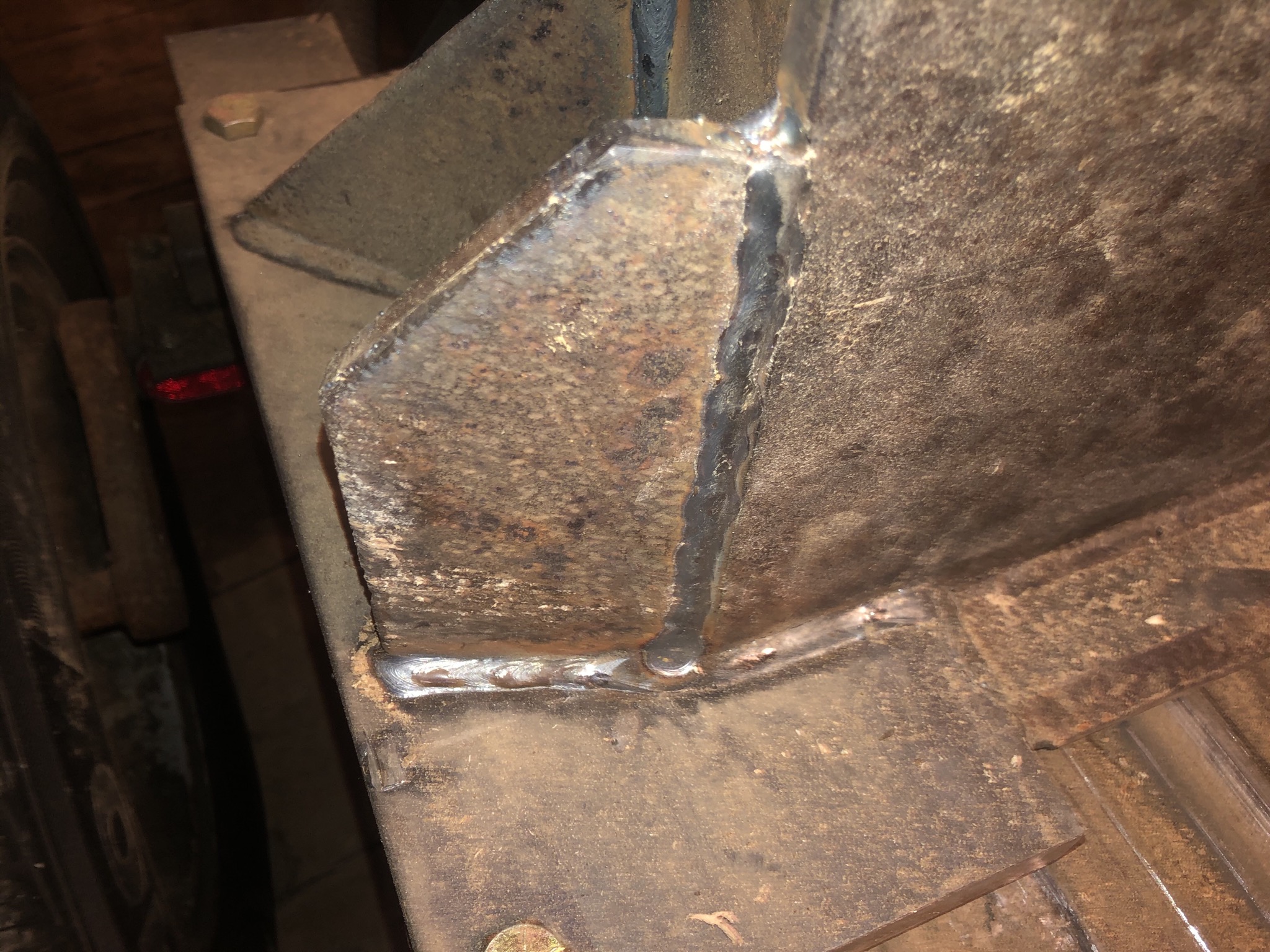

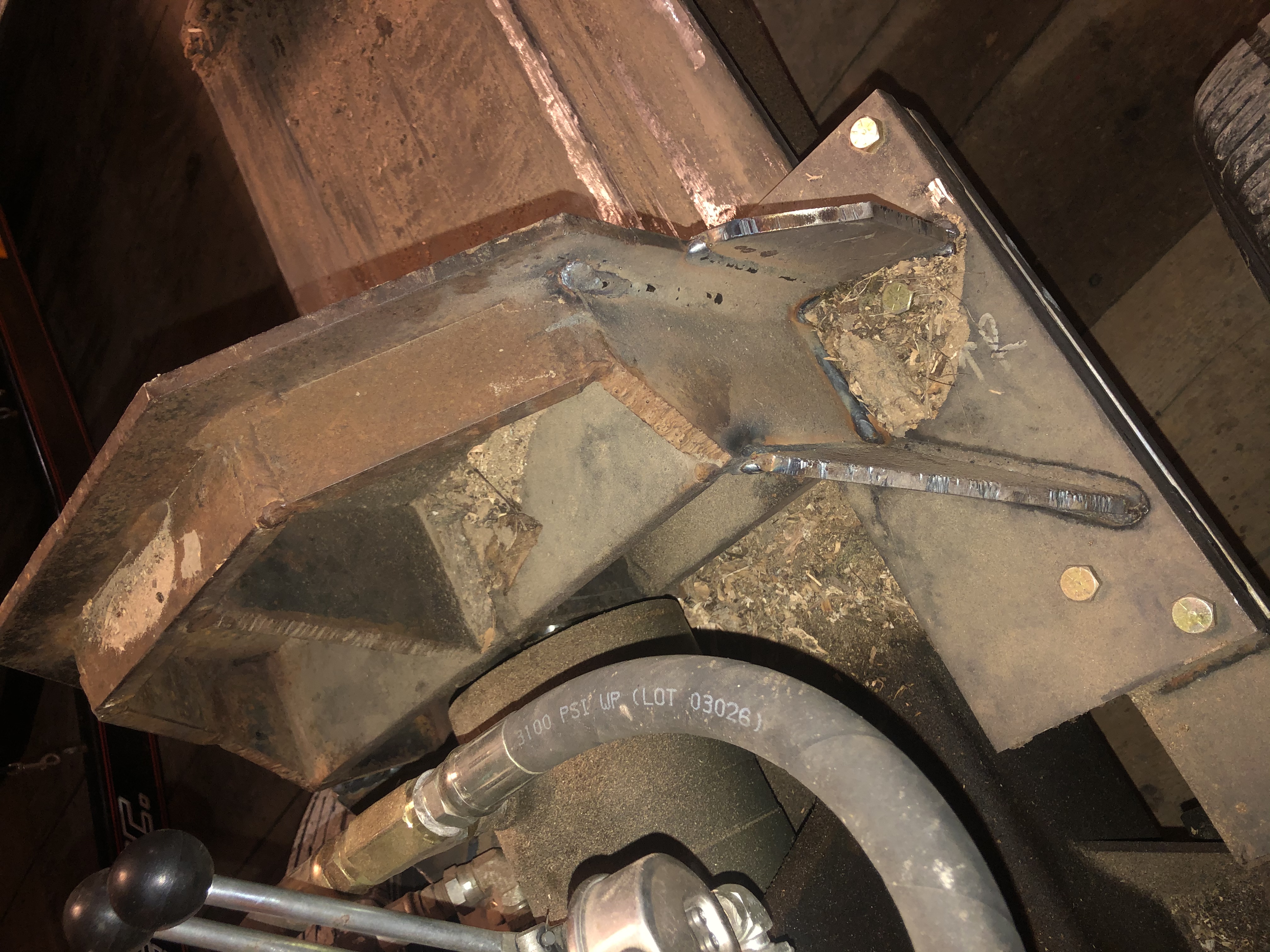

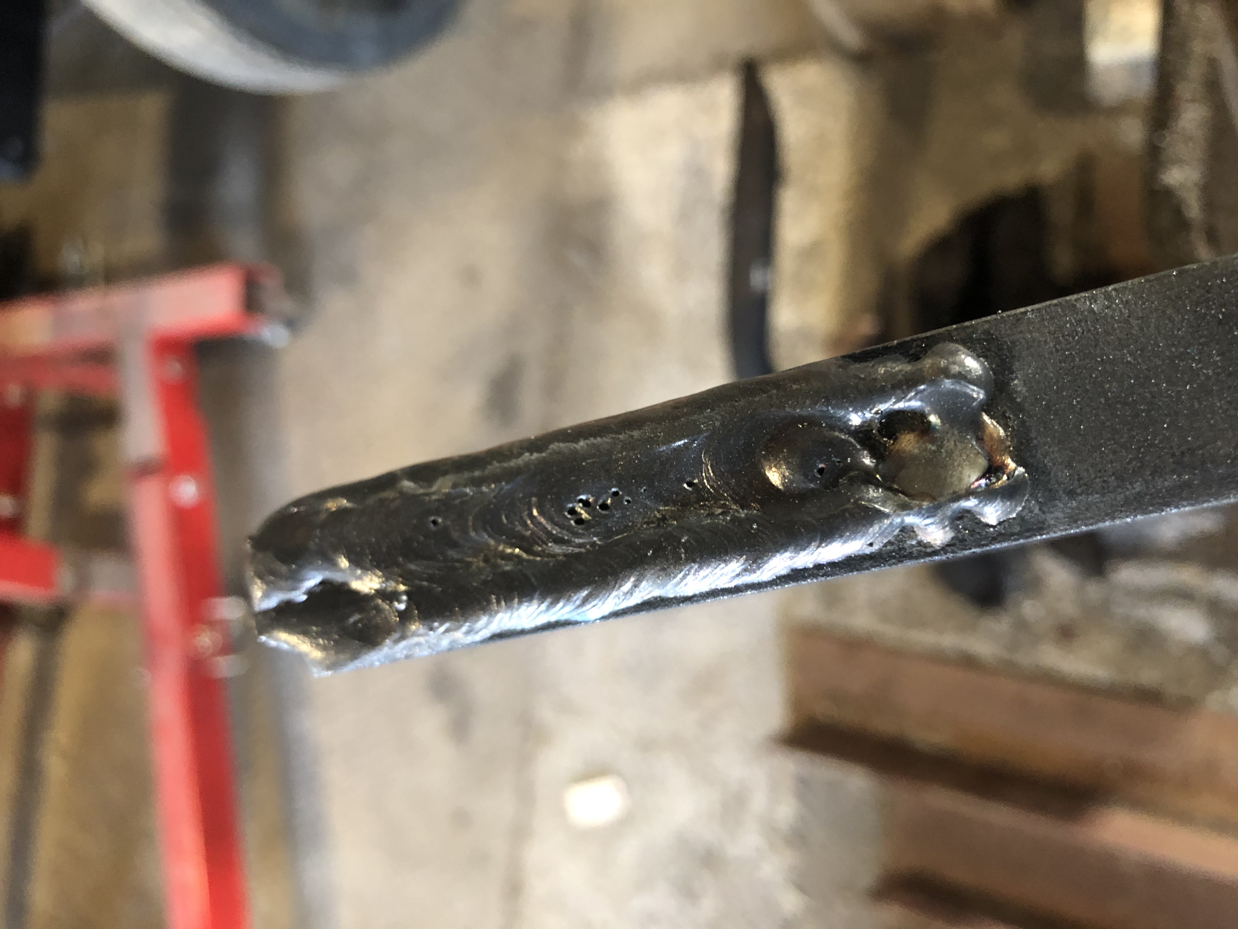

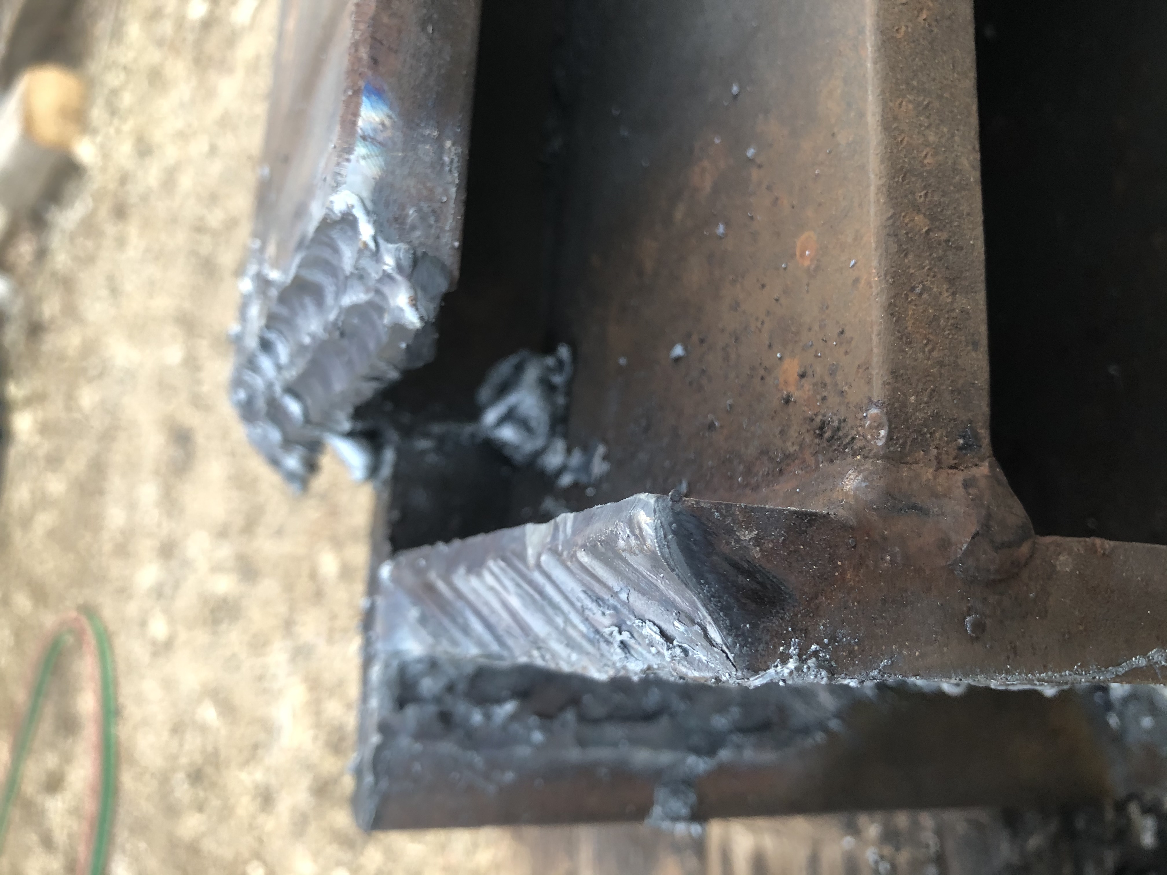

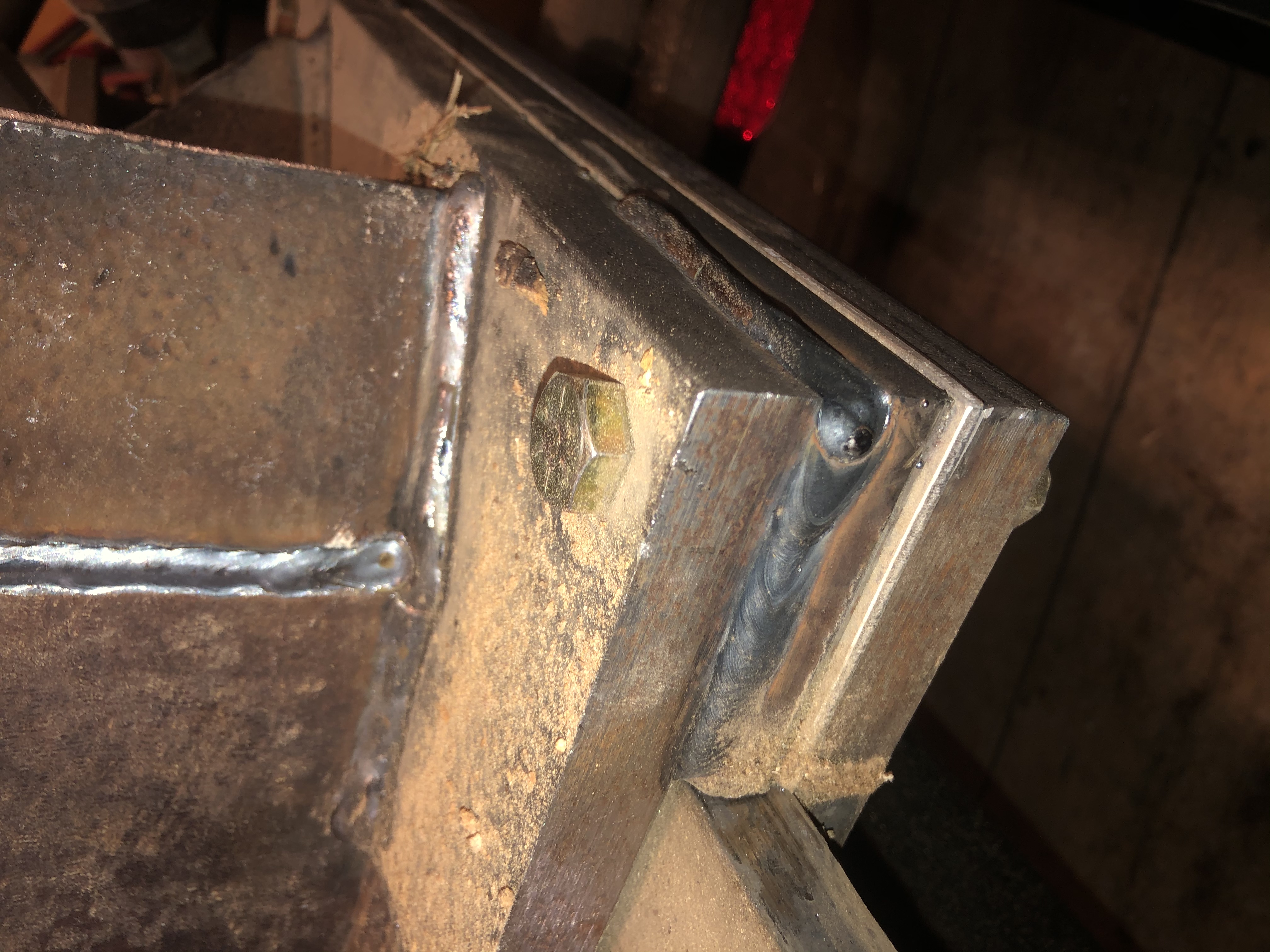

Dec 27, 2019 / Bevel prep for T joint? Thread Starter #22 OP C Cord Veteran Member Joined Mar 21, 2005 Messages 1,720 Location Richfield, Wi Tractor Resident Architect Finished photos after a day of hard use. Attachments 9992D8D6-6D1A-4772-BD1D-0FA7CC314AEE.jpeg 3.4 MB · Views: 172 60664949-7F1A-4519-AE82-12A20D94D6A3.jpeg 913.8 KB · Views: 151 83B9909F-CA05-4F24-894D-967CC6D2BCBB.jpeg 2.7 MB · Views: 168 AAAC647D-60CB-446E-AA2D-6027AD1EE331.jpeg 806 KB · Views: 154
