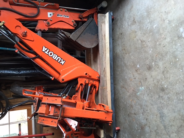

At the price it is well worth it. I have a BH77 that I bought used for my L3901DT. Make yourself a backhoe dolly and it will make taking the back hoe on and off a lot easier. I can change mine in about 20 minutes, a little faster when everything go right. I installed the sub-frame myself, took about three hours.

Exactly right on the dolly - I built one a few years ago finally and it rolls away in the corner for storage in the winter. Takes longer to put the 3PT arms on that to R&R the BH. I don't take mine off anymore all summer - just in spring and fall for winter blade/snowblower mounting.
The BH77 QA needs the subframe and then the BH "hooks" on the bottom and pins on the top of the tractor subframe section. I do have the swivel seat and can move the BH by reaching the pedals but you can move with the BH stick too when trenching.

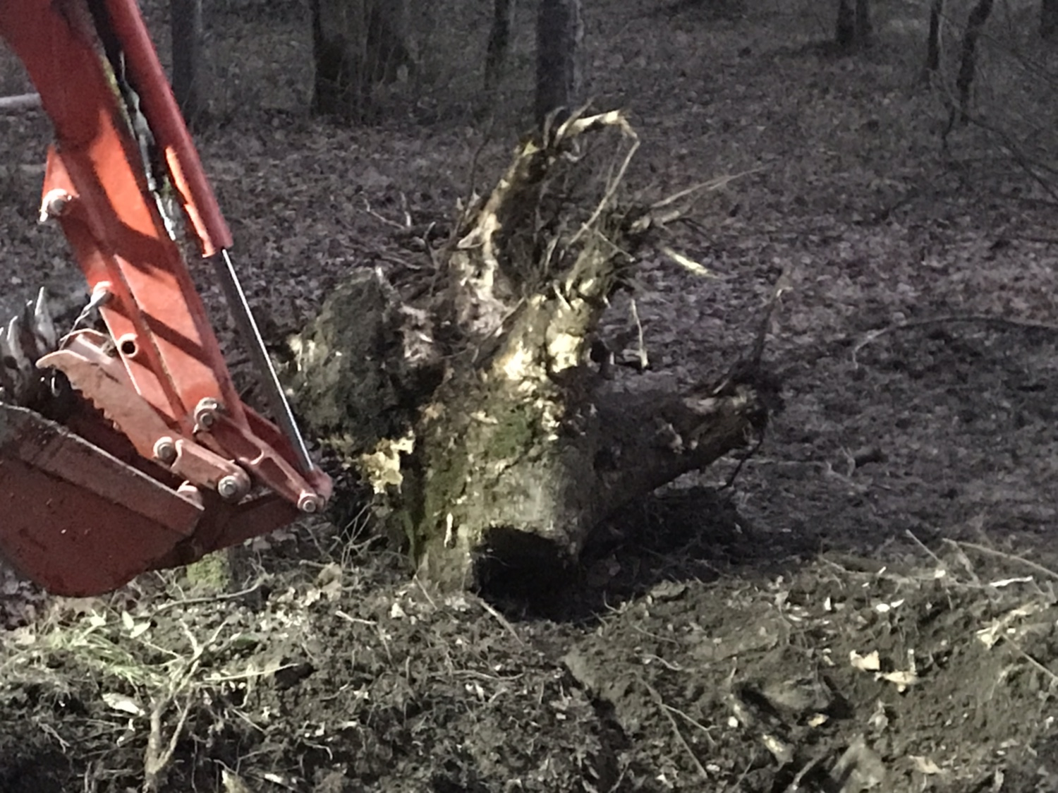

They do ok on stumps but a lot more digging than a mini Ex would take to yank them out. They work good for trenching and digging holes. Is it a Mini Ex - nope, but it will do the job and for the price you could use it and get your money back out of it. If you have HST you can use a stick and push the pedal to move forward or back slightly.
   / BH77 Backhoe Worth It? #20
I have dug lots of Poplar stumps with my bh77.
Takes about 1 - 1&1/2 hours to get the larger ones out.
