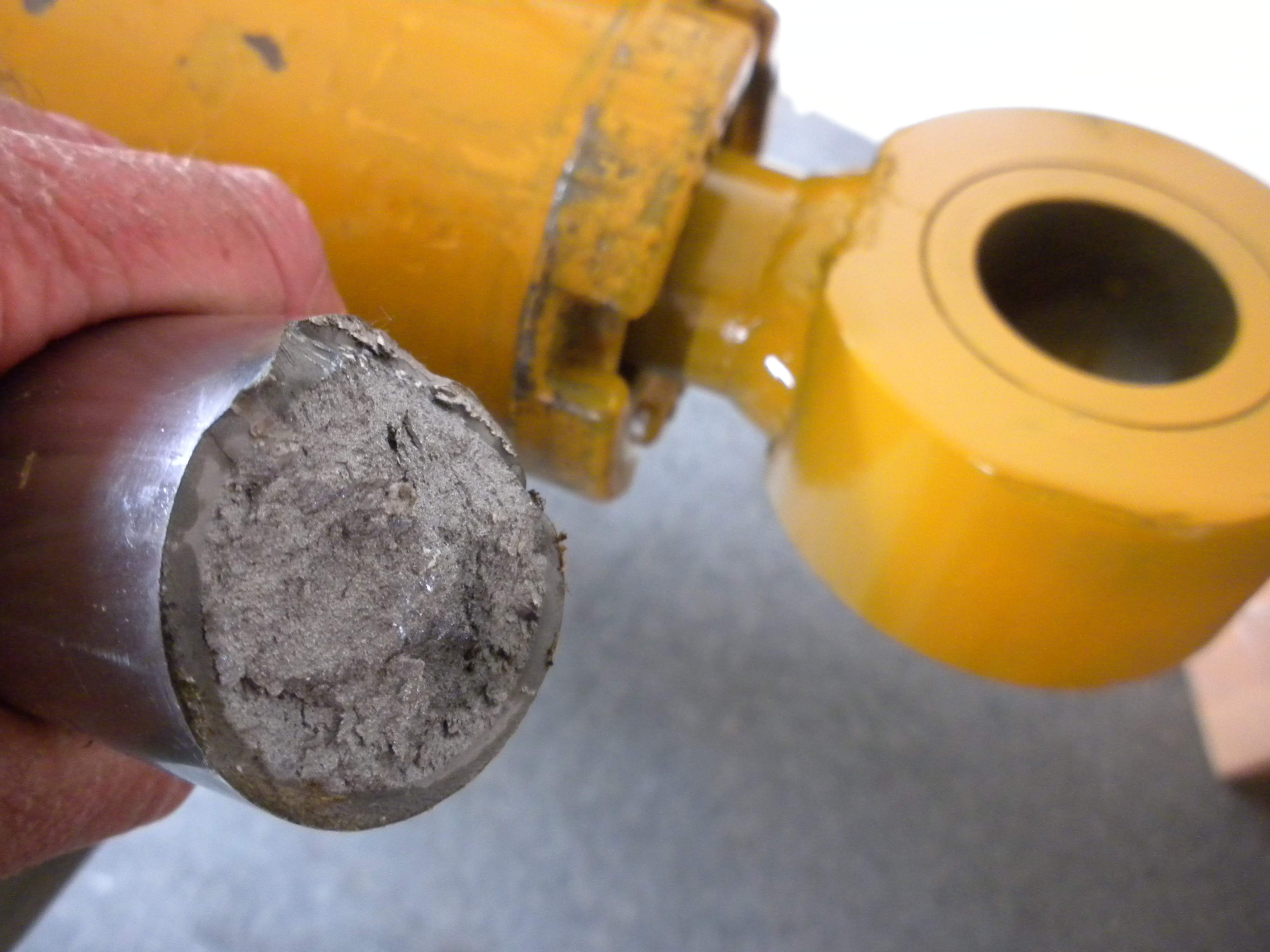

You guys who have call my post into question are correct, 99.9% of the time. Had a good friend that I grew up with who now works at a dealership (not a Kubota one) who was telling me that some time, when things don't go right at the factory (no grease on the pin) that a pin can corrode and get stuck in the bore. Backhoes are not very fast moving items (at least at his dealership) and he says that they often time sit in the crate or on the lot in the same postition for an extended peroid of time. I will say that I looked at the pictures (missed them the first time) and in my humble opinion, the pin did not look like it was froze in the bore in this case. Anyway, sorry for any confusion from my post.
   / BH77 broke - defective part? #32
Oh I forgot to add something. After see the pictures, the metal to me looks very crystalized in the center of the broken pin. Althought this in and of it self may not mean anything, it could point to a material defect. Again, just my opinion.

Here's some pics of the defective/broken pin. I've contacted the dealer that I purchased the tractor from and they are sending me another pin for it. I'm just a little worried that this may be a bigger issue than just replacing the pin now. It looks to me like it may have actually bent the frame that holds the cylinder...maybe torqued/pushed it out a little (see pic 3). Not sure how I'd get this pulled back in. I'm also concerned that it may have damaged the inside of the pin sleeve...perhaps scuffed it which could lead to additional wear later?
Feeling pretty sick about this right now...
I would be sick as well. It looks like it has bent. Replacing the pin is a temporary fix at best. Best of luck in getting this sorted out. Keep posting.
I thought it was just me. I've never seen the inside of one of these pins before, but that doesnt look right to me. I would think it should look like a solid piece of steel which has been cut, not like a broken piece of cast steel.
When a hardened pin or shaft breaks this is typical.....
The pin in question from the OP'r shows it was hardened (the outer layer is finer grain).......
Here's a pic of a 1.750 dia hardened hyd rod that snapped in one clean shot from todays machine work......notice the hardening in the outside approx 1/8 thick.....
This comes from an OEM CAT skidder hyd rod.....in the background you can see the finished rod installed....

Texas Fella, I'm not questioning your knowledge, I just noticed in the photos is looked like the joint was greased and it looks like the pin just broke in half. If dealers are sending backhoes out with frozen joints, I would say that is poor prep, they should grease the pins and make sure they are free before it sold.
