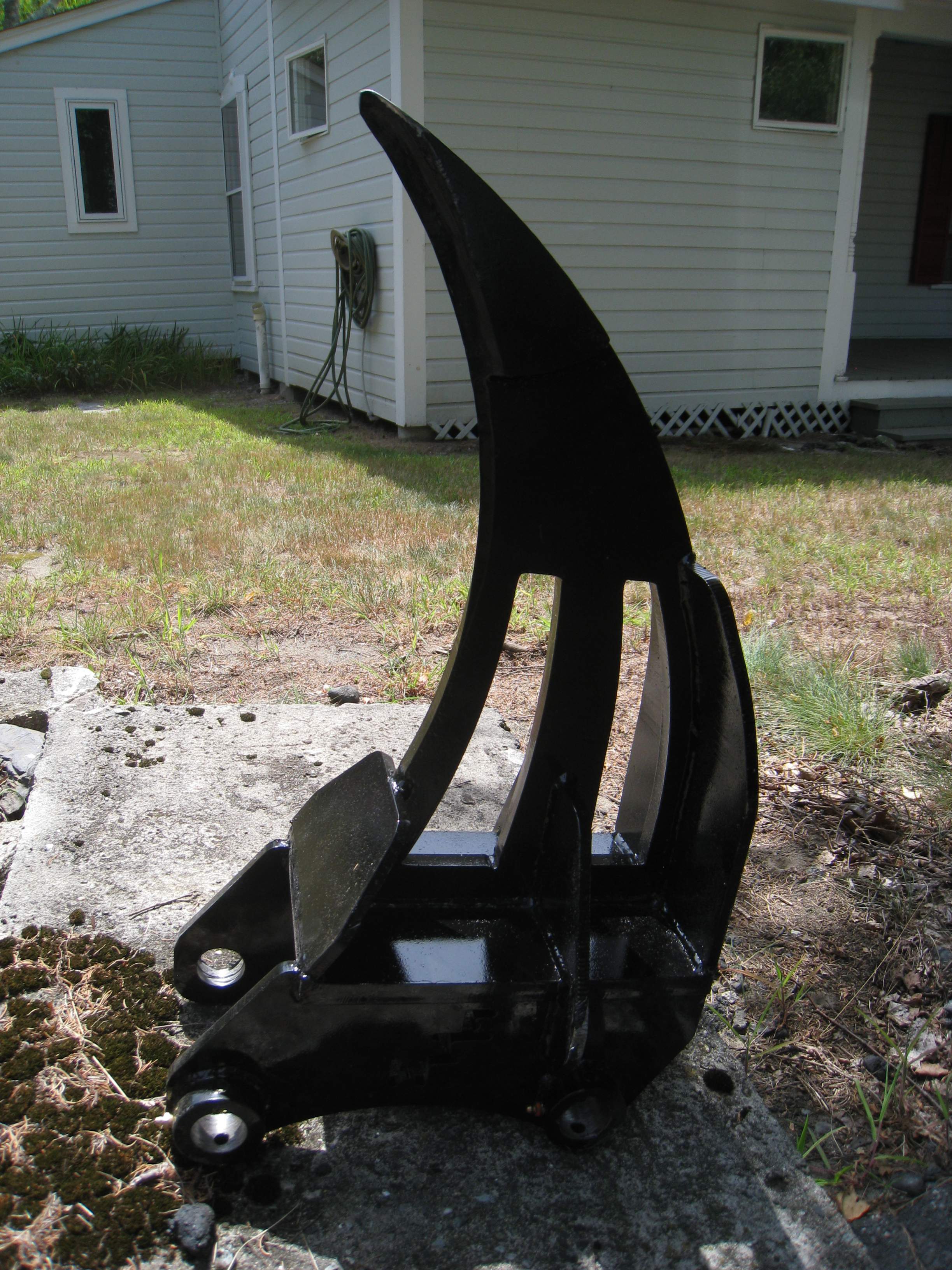

I have a 18" and a 12" bucket. They both get quite a bit of use and I'd hate to give up either one. I had a brand new 24" that came with my hoe when I bought it used. I decided to sell it while it was brand new and buy a 18". In hindsight I was right. Unless you're digging on the beach these tractor backhoes aren't strong enough for that size bucket. As long as the pins behave I can change buckets in 15 minutes. I built a ripper but I've never used it. This works a lot better. IMG_9465.JPGIMG_9353.JPG

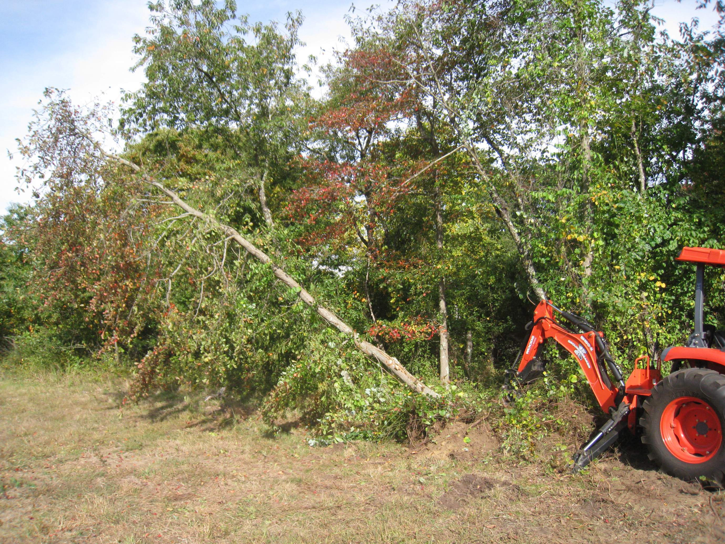

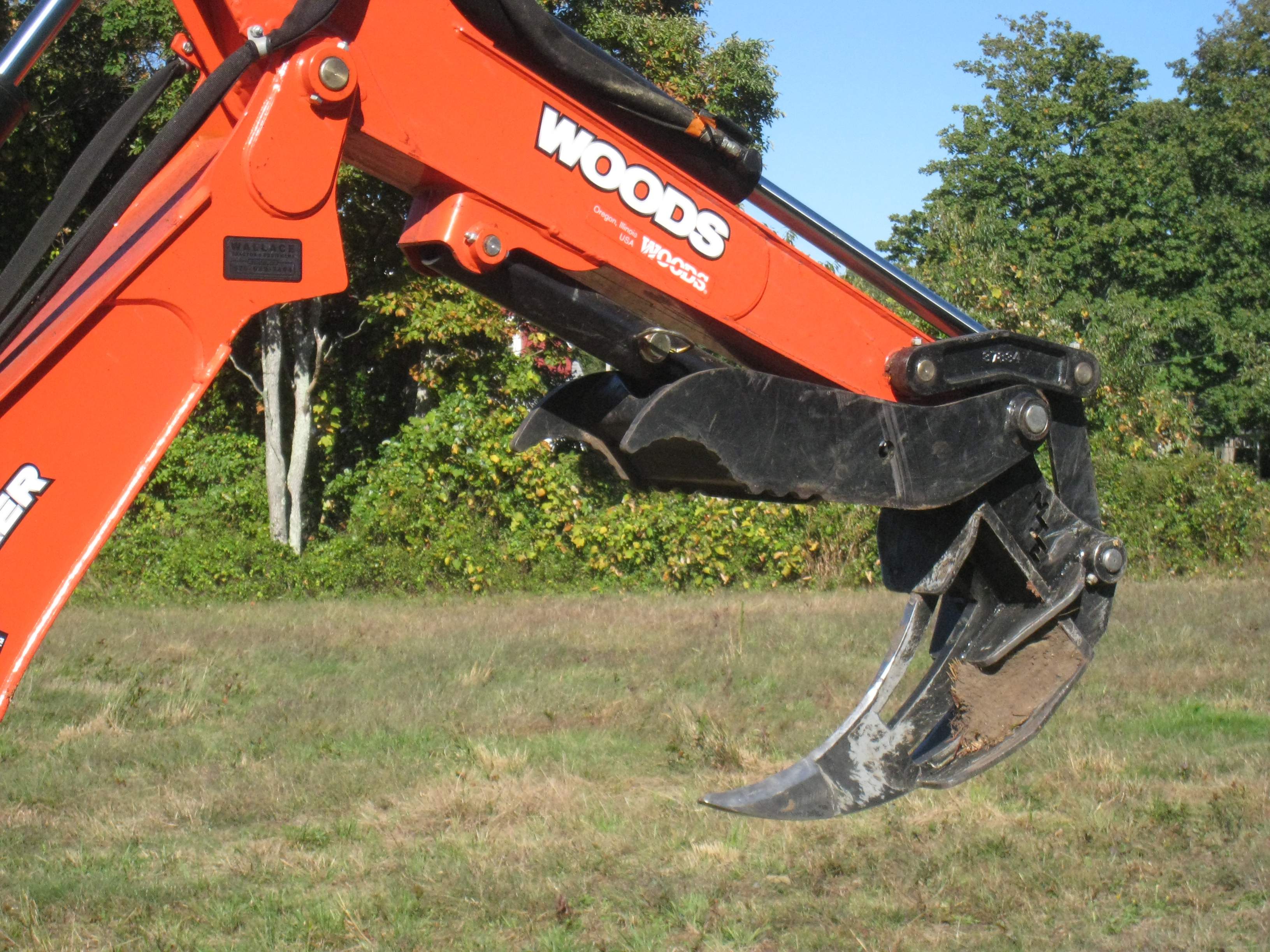

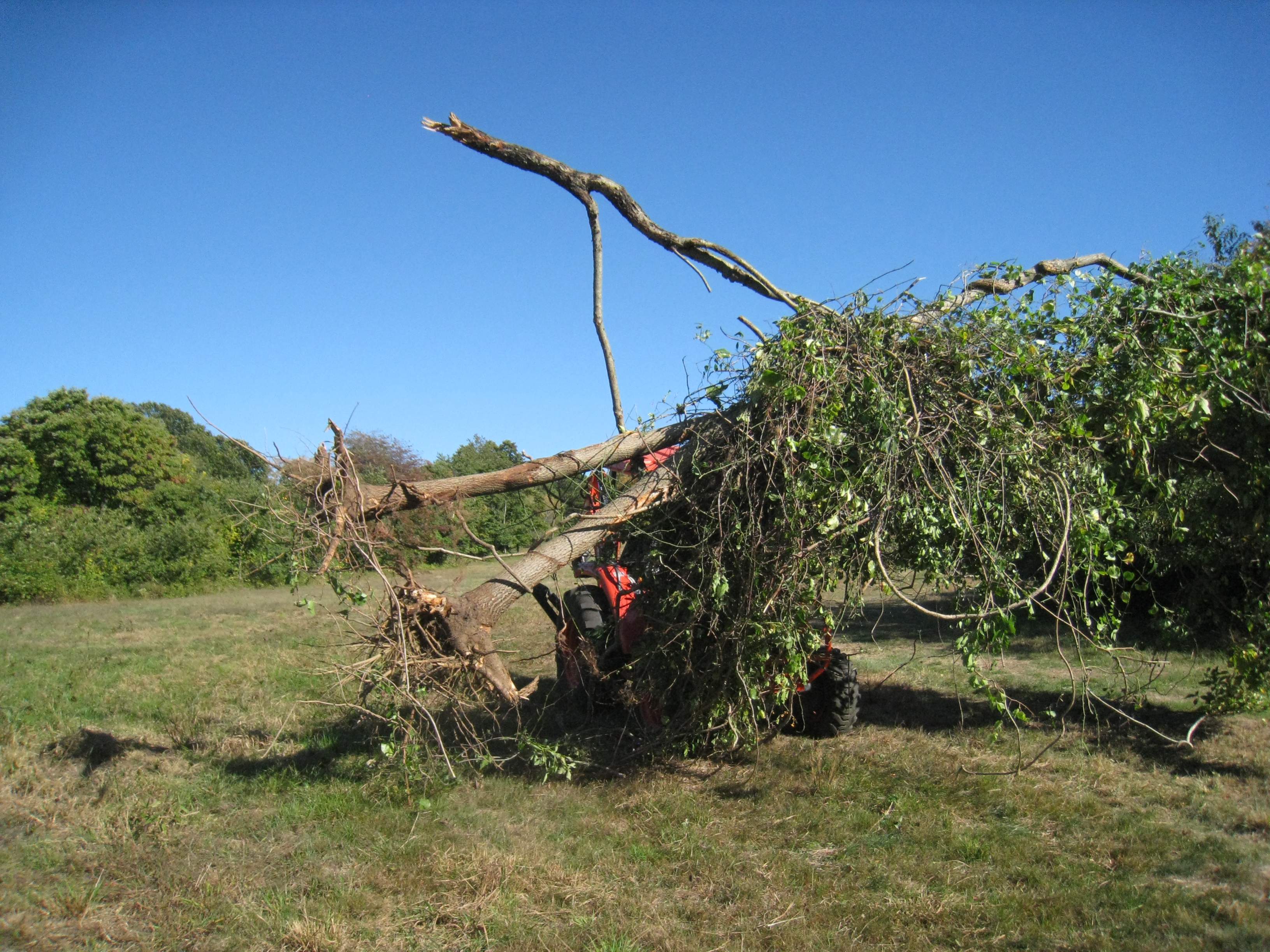

I don't own a Kubota BH but have a Woods BH90x. Standard bucket was 18" I believe. I also added a custom ripper I designed with help from Michigan Iron. The ripper is awesome for trenching and ripping roots. The standard bucket is great for digging and I wouldn't want a smaller bucket. I don't know what he charges now but Michigan Iron and Equipment sold the rippers a few years ago for about $500. Great investment if you need to knock down trees. SO much less work and damage to turf and soil than chainsaw and digging out the stump. Just rip the roots on 4 sides and then push the tree over. Works exceptionally well for trees up to about 12" diameter.

Sorry for being a bit late on this, I don't have much time to be on forums and sometimes I forget to drop down to the Kubota sub-forums when I do get time. I have a ripper tooth from Bro-Tek for my BH92. I think mine was the first one he built. It is very well built and he actually got it right with my lousy measuring skills. The only issue I had was that the front pin was not big enough. I'm guessing on the smaller versions the pins are the same size.
He didn't ask for that measurement and I was new to tractors so I didn't know to think about it. A quick trip to a machine shop to bore out the front pin hole and I was off to the races. The thing is awesome for ripping up roots. It stays on the Backhoe almost full time as I have a lot of trees to take down. Really nice to push them over and not have a root ball to grind.
