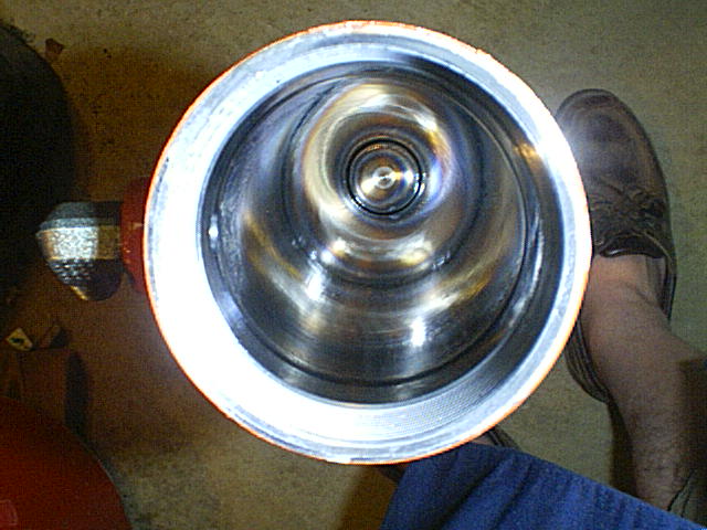

   / BH90 Dipper Cyl
#9
Not a dump question at all...
Yes, it's misalignment that causes side loading. The centerlines of the holes on any or all of the pins are not parallel for some reason.
Side loading causes the piston to continually rub along a line in the bore instead of theoretically floating in the center. The piston motion creates burrs and destroys the seal as it passes over them.
If burrs are present in a cylinder like this one it is a bin job and not economical to resize. Before a new cylinder is installed the problem that caused the initial failure must be corrected or the same thing will recurr.
I have some tools being delivered today that I can use for disassembly and only then can the full extent of the situation be realized. I'll post what I find.
Thanks for asking,
Martin
   / BH90 Dipper Cyl
Lady luck is with me (somewhat anyway),
the bore is score free for 360 degrees of the full length.
This pic is 90 degrees CW to the pin bore...
