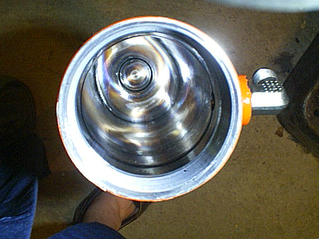

this one is 90 degrees ACC...

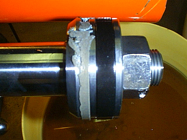

heres the real problem...
   / BH90 Dipper Cyl
#13
the black ring is a spacer that keeps the piston of the walls of the bore so this cylinder is designed to handle some side loading. The piston is not damaged. The seal is extruded. In the business this is refered to as seal extrusion. If the seal was not damaged during factory installation it is caused by pressure too high for the diametral clearance combined with heat which softens the seal.
I am just going to re-seal and see what happens.
I am also open to any ideas or inside information anyone may have, please speak up.
Thanks for looking,
Martin

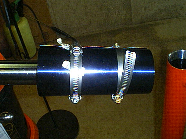

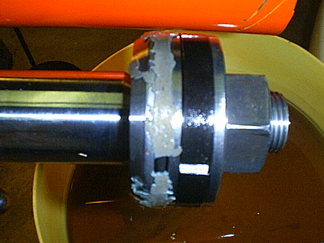

Well we're back in business. The replacement piston block seal is a bugger to get onto the piston. I was hoping the piston was made in two pieces, split at the seal groove, but that is not the case. It is a bugger getting the new seal over the land and into the groove. I heated it up on a 60W light bulb to see if it became more pliable but the difference was imperceptable. I just used my fingers and persuaded it into place. It didn't tear but did stretch some so I fashioned a ring compressor from a strip of .008" spring steel and some hose clamps and kept things snug hoping it would return to the original diameter. Wha-Laa it worked slicker than a cats butt. The cylinder reassembly was a breeze. I had to take the hand grinder to the base of the dipper cylinder to relieve the side loading. I just ground a flat to the depth of the bushing and that was enough. Took about 1/4" off. It has reduced my opinion of Kubota to say the least. Because I know most of you can't read and only look at the pics (joking), here are a few...

#17
if you look at the profile in the bottom of the pic you can see how far the seal protrudes beyong the piston. There is a good lead-in angle in the cylinder bore but I was dead afraid the seal would shear...

#18
so I put together this mickey fickey ring compressor...
