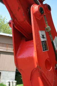

Hi Bob53. The Kubota dealer fixed my BH90 under warrenty and I have some before and after pix that you might want to compare to your tractor. I have not exercised the BH90 yet but I do believe that they corrected the problem. The pic Mechanical_Stop shows the underside of the boom-dipperstick hinge. Note the square plate near the top of the boom. This plate is a mechanical stop. While extending the dipperstick piston, the dipperstick will contact the the mechanical stop before the piston has reached the end of its travel. As the hydraulics continue to push, something has to give and since the dipperstick cannot move the piston bends. Continued in next post.

Continuing Bob53, see in the attached pic that the dealer has removed the mechanical stop.

The wrong pic was posted. I will try again.

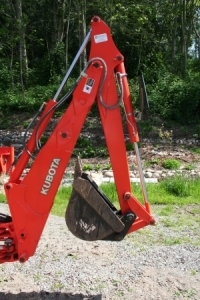

An in this final pic, the dipperstick piston is at full extension and the dipperstick does not contact the boom. If I use the controls to try to further move the dipperstick, you can hear the bypass as the piston is already at full extension. So, I would examine your backhoe for that mechanical stop. It is interesting that the plate is only about .5" thick so if the piston were only a little shorter, this problem would not occur. I do think that this will solve the problem as I don't remember ever hearing the sound that the hydraulics make when the piston is bottoms out before while I had been working. Time will tell.
