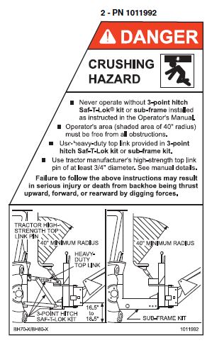

Are you sure you need a subframe for it? When I was looking into getting a mount to put my BH70-X on my M4700 I contacted Woods and they recommended a top-link contraption "3 point hitch Saf-T-lock".
Essentially a beefed up top link used for the Woods BH90.
