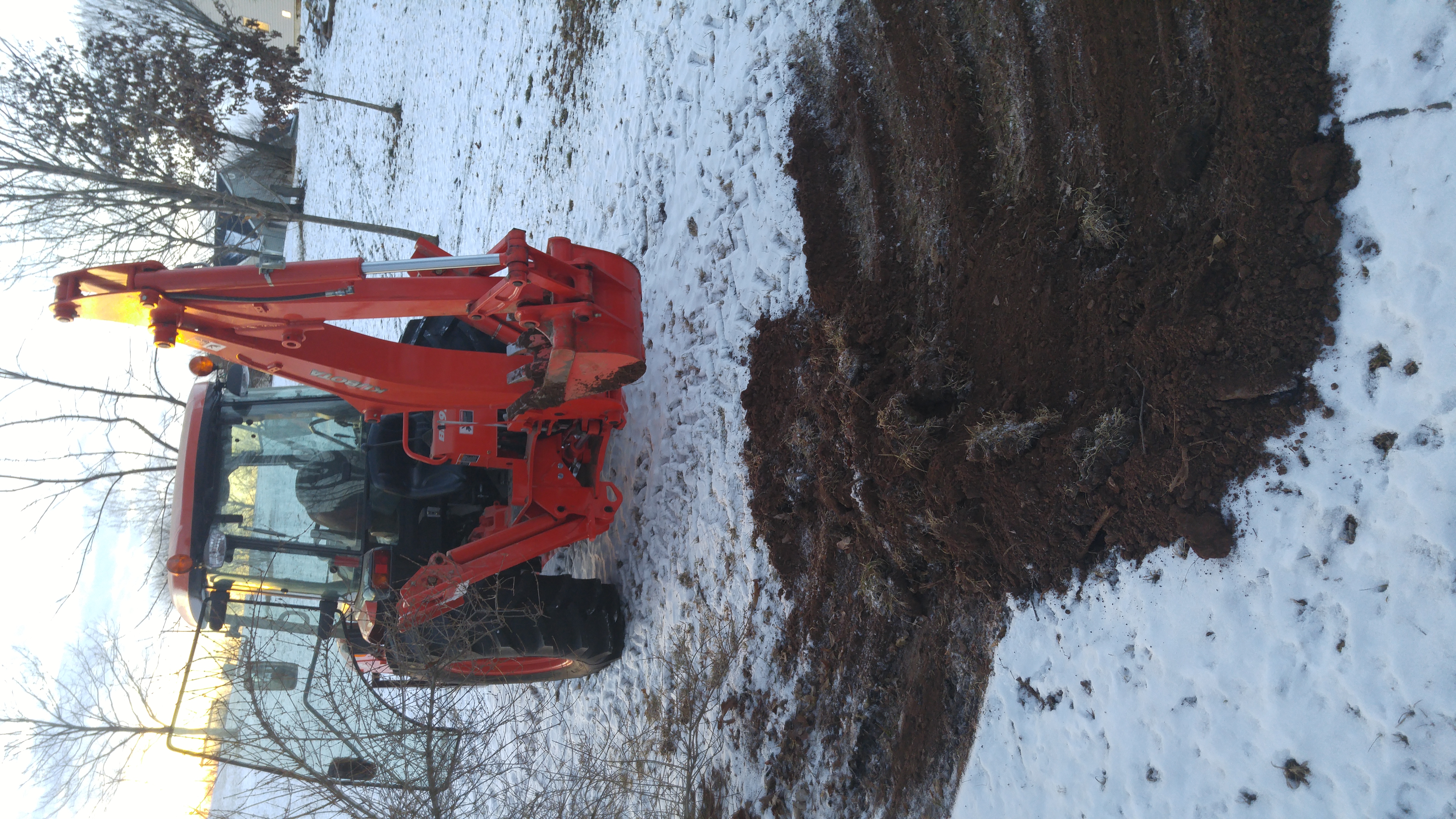

Kubota changed the BH92 to allow it to fit on Grand L cab models in the last year or two. Don't know if it's a change to the subframe or the hoe unit or both. Maybe a dealer can give you the specifics before you start shopping.
