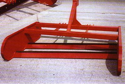

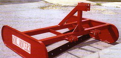

Pics off website of the Big Bee Soil Mover
