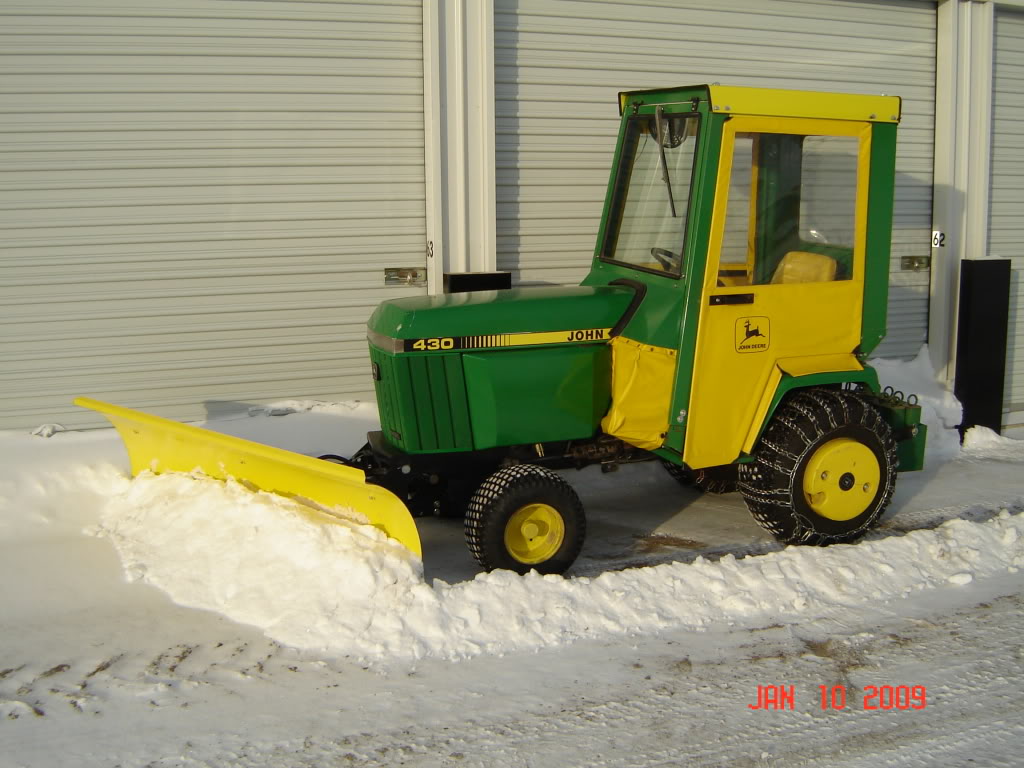

Something like this maybe
   / Big decision #18
A 400 has power assisted steering and it isn't that great. I would go with a 420 or a 430 for the power steering and the high lo transmission. Those run like 12 mph in high that would be perfect for driving around town and doing driveways.
