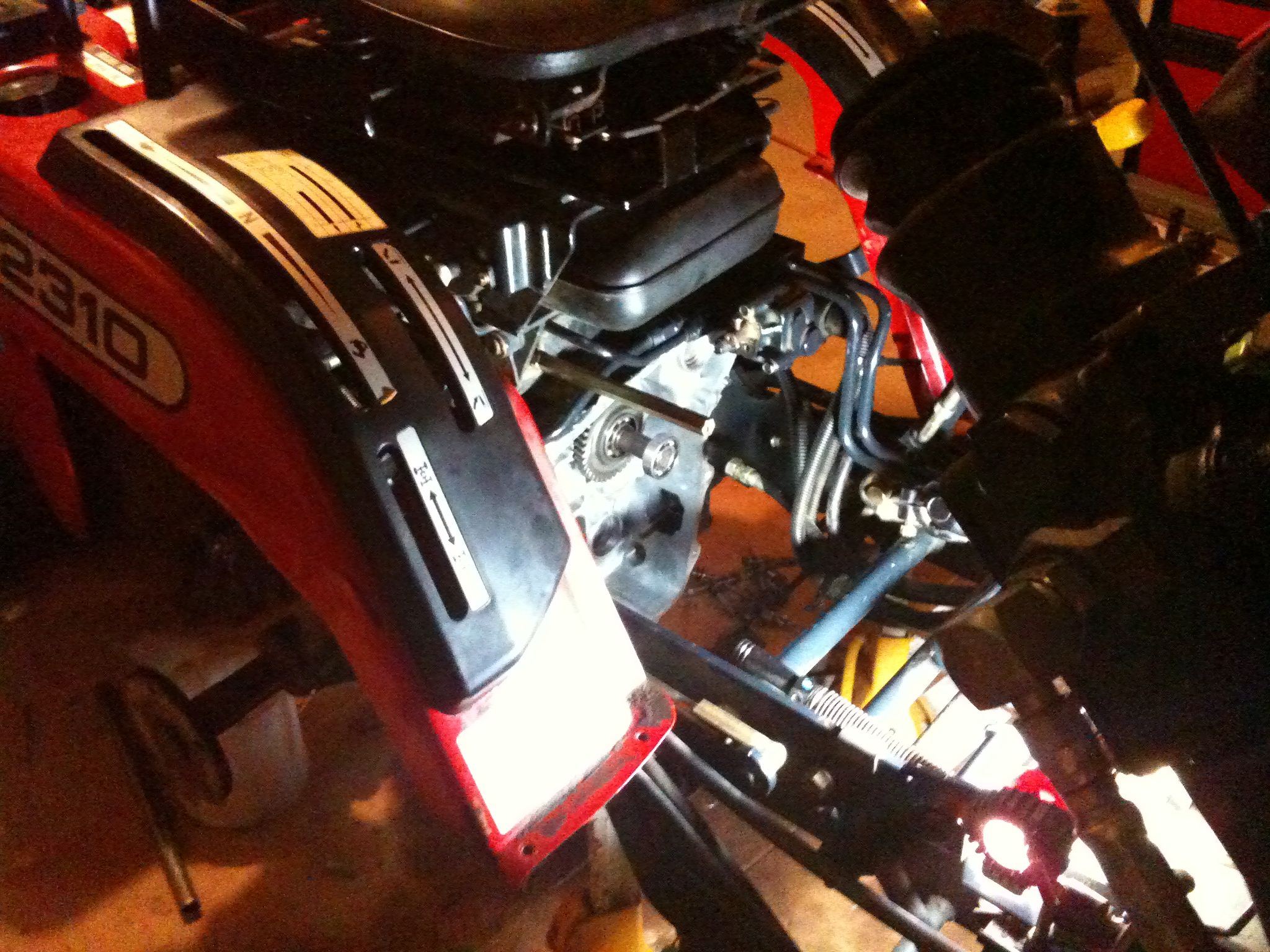

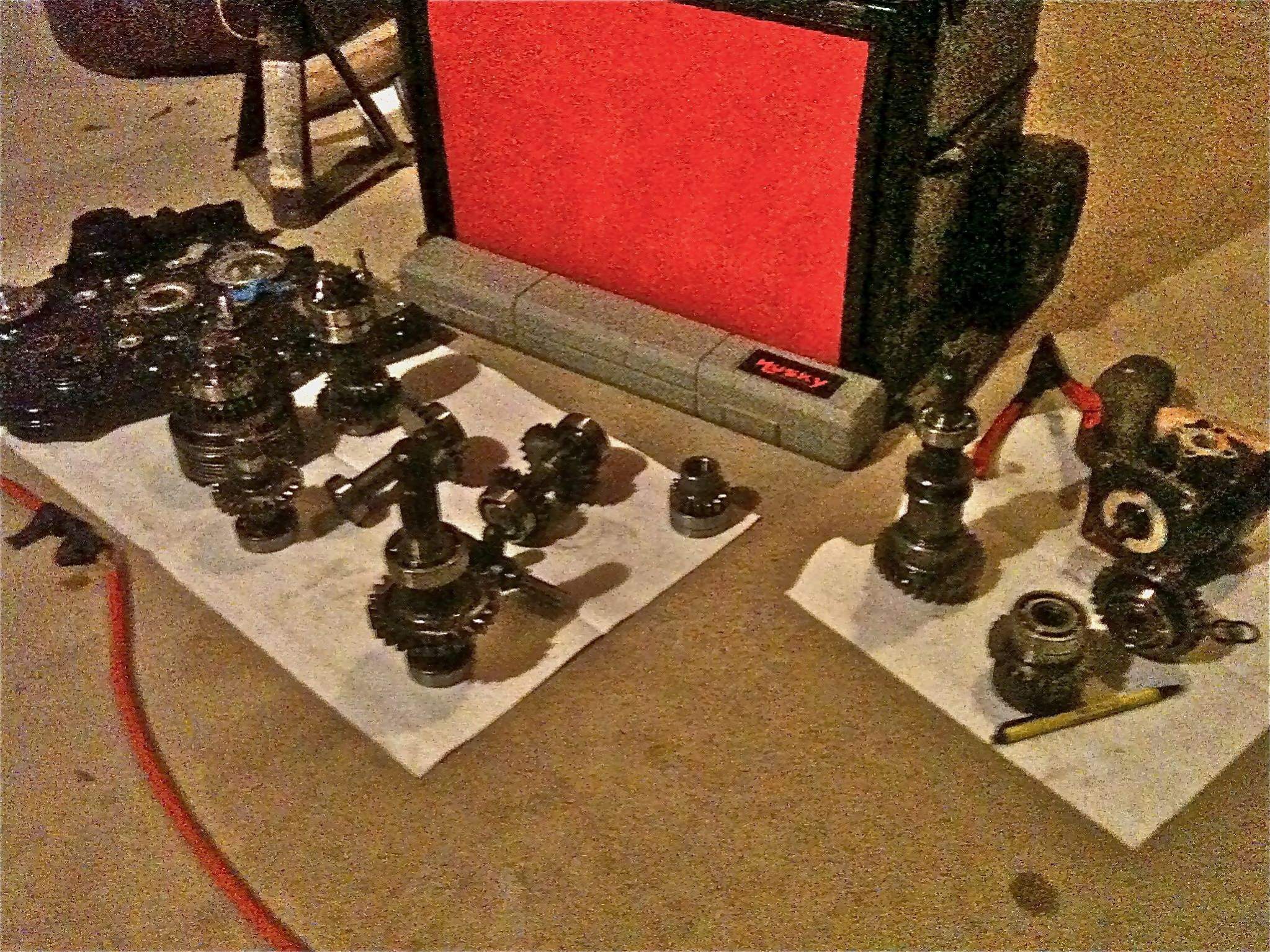

I should have posted this a month ago but:
Anyway, It was a big job and I had great success doing this repair.
My GC2310 TLB is back and better than ever. I need to thank the boys out at
Sossler's Garden & Farm Equip. in New Hampton, NY for their assistance over the phone. They couldn't believe I was going to do it w/o dropping the tranny.
Of course they have lifts & hoists. Me - a couple of stand jacks.
I really only had 2 setbacks along the way. The first required a little ingenuity.
After getting a nice bead of silicone on and snugging up the tranny's front cover, I realized it was impossible to then install the 4x4 detent ball, spring, and plug bolt as the location is right up against the frame. So off comes the cover again. *#%@$!!!! Problem is, in order to seat the internal arm (that shuttles the 4x4 gearing) in place while working the tranny cover on, exposes the hole & the detent ball drops inside the tranny. God bless duct tape. I folded all but the last inch of an 18" long piece and basically created a ripcord. With the cover a half an inch from tranny case, the arm, now in place and covering the detent ball, I gave a yank and every last inch of that duct tape came out. LUCKY,LUCKY,VERY LUCKY. I did NOT want to have to take that cove off again. (and scrape off all the silicone ....again)
That done, I put everything back together, filled it up w/Amsoil and......
*#%@$!!!! I must have tweaked the mid PTO shaft seal 'cause it was leaking like crazy. If I knew it was so easy to replace the seal w/o disassembling anything, I would have left it off 'till last. Used a putty knife to gently pry off the old one & w/plenty of grease on it, I slid the new one on and tapped it into place using a short length of 2" PVC pipe. DONE!
And it's dry. I worked the baby all day. Bucket, Backhoe, drove it around, parked it on some cardboard and there wasn't a speck of a drip next morning. Needless to say I'm a happy camper. And I have to say, a big repair really helps you bond w/your machine. I didn't take a lot of pics. Here's 2 in total disassembly stage.

Not sure if you'll get this reference or not, but here goes: "You're a better man than I, Gungadine!"
Congratulations! You should be qualified for a second job as a Massey mech! Looking at your pictures, I really don't think I would have attempted that; my hat's off to you! (Last tranny I did was a 52 Jag XK-120 back in 1966. I said then I'd never try that again- Scary!!)
Anyway, very glad to hear you're back in business, and yes, I know about the bonding thing!!!:D:D
Thanks for all the updates -- ah, excuse me, the EDUCATION!
