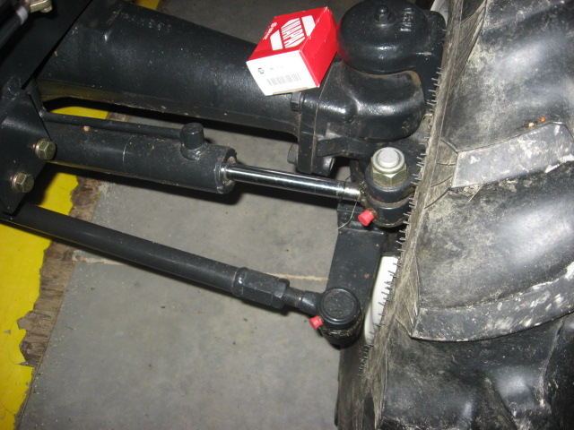

I will post the part number here tonight. They are the Napa Balkamp brand. 10 of them in a box for $5.00. I like the Napa one because they are rubber and stay on longer. The plastic ones I have found tend to get loose after removing them 2-3 times because the hole get's elongated. I have never lost one of the rubber ones in 4-5 years.

CB Here is the part #. There are 5 to a box and I paid $ .77 each each(not box) and the next time 1.00 each to buy some extra and for the brush hod.. Part #715-1091
I heard about these from the guy who has an excavating company and he runs them on his backhoe etc. I really don't know why more people run them expecially going through mud etc.
I grease my tractor every 25 hours and these are still tight, 4-5 years old and they still make a pucker sound when removing them. I ran the blue plastic ones on ebay but they seemed to loosen up after a while as they were a harder style plastic and these are rubber.
