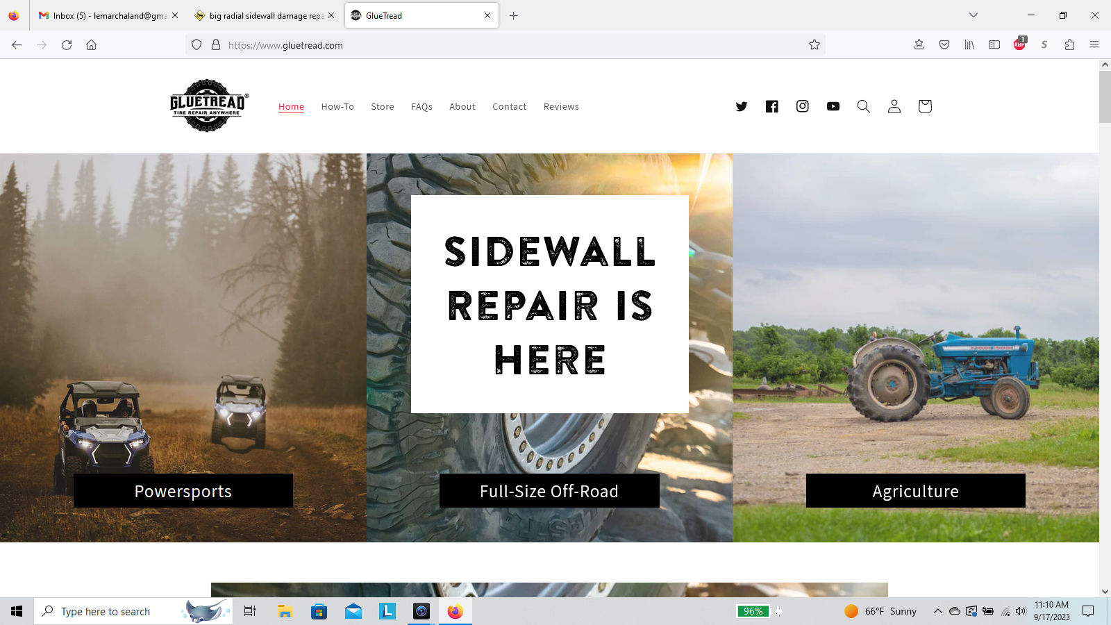

   / big radial sidewall damage repair #8
Here you go;
GlueTread
