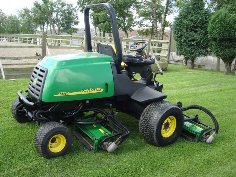

l have been having a bit of trouble with my old ride on mower as of late, its on its last legs and needs replacing really
however when l look around at the price of new its a non starter :confused2:
so since l always enjoy a project l thought l would have a go at building one from scratch
below is a pic of the sort of style and layout l want, except l want to be able to fit a rotary deck or flail mower on the front
and not cylinders as the area l have to cut is a bit rough
to keep costs to a reasonable level l will have to use components l have or can get get cheap rather that what might be best

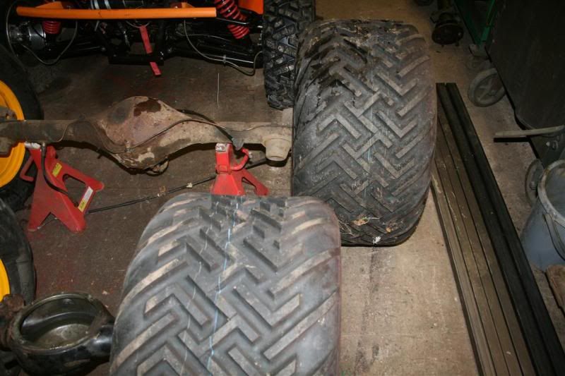

as its always bl**dy raining here l think 4 wheel drive is a must as is a diesel engine
l have been into offroading suzuki's for a long while so the parts bin is full of suzuki stuff lol,
sidekick/tracker has a nice wide rear axle that is quite robust too so that will make a nice front axle on the mower
and a sj front axle will take the sidekick front diff to match the ratio's, the long side is easily cut down to the same length as the short side giving a nice narrow steering rear axle that has matching ratios
the other bonus with using suzuki axles is that the stud patten matches up with the wide wheels l already have

cutting the long side down to the same as the short side meant l could just use another short side halfshaft but the axle isent quite
narrow enough but l might have to live with it
l wanted the rear wheels to run inside the fronts so as l could use the mower as a roller too, but when the wheels turn they use up so much space and l have to get a chassis through there between the tyres out to a tow hitch on the back
