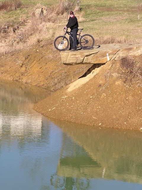

OK guys and gals, see what kind of method you can come up with to move this rock back away from the water about 10 feet so I can reset it level in the same postion it is now. Problem: ROCK approx. 8 tons. Equipment available: Caterpillar 287 track skid steer (4.5 ton ), Caterpillar 308CCR excavator (8 ton machine) and a JD 3520.
Also the rocks end is at the right hand edge of the pic, behind it is level grassy area so there isn't a problem with getting a machine or to there.
And don't anyone suggest renting a D9 or blowing it up with dynamite.
I took a pic of me on it to give you some scale.

Jack it up, put down some timbers, add rollers, attach a 8 shiv. block and tackle, anchor it and start pulling.:D
Don't stand under it when jacking. Maybe make some cribbing to support it.:D
Don't need those machines at all.

I'd dig up all around it and see if you can lift part of it enough to get a log under it. Then dig a ramp to get it up and out of the ground, or dig a trench to where you need it to go.
Then get the chains around it and pull with which every one of your machines has the most power and traction. If that's not enough, put another machine in front of the first one and pull with both. Keep adding vehicles until you can get it moving.
When it starts to move, put more logs under it and continue until you get it where you want it. If the Egyptions did it with people power, you shouldn't have too much trouble with all your tractors.

egon, I rolled it into place on several round treated fence post, but they pretty much splintered to pieces. I had it setting real nice and level. Now its settled into the current postion and I need to rethink the whole thing once I get it rolled back out of the way.

Eddie, now your thinking. Good idea about digging the trench. I just might be able to get it slightly down hill. Gravity would help tremendously. Do you think a lot of butter would help? hahahaha

I would think the Cat 308 would be able to move this. The other machines haven't a chance. Dig a trench behind the rock and pull it toward the trench. Repeat this several times and I bet you will be able to slide it if it is really only 8 tons.

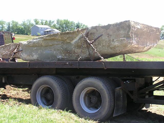

When we loaded the rock on a roll off truck to get it to my place I hooked onto it with a D8 and 20 foot 5/8ths chain. Took the slack out real easy. Let off of the decel pedal and the chain popped like a rubber band. Had to push it onto the rolloff with the D8.
The rock still chained on the truck.

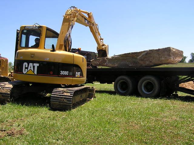

The rock was facing the other direction on the rolloff so we spun it around with the cat 308ccr while it was still loaded on the truck.

Ken, I'm sure the dexpan works great, but I hauled this rock in! The rock isn't the problem its that it settled in and now I need to move it so I can reset it in a level position just about where it is now. If I had given it a little more forthought I probably should have poured a concrete footer for it to set on.
