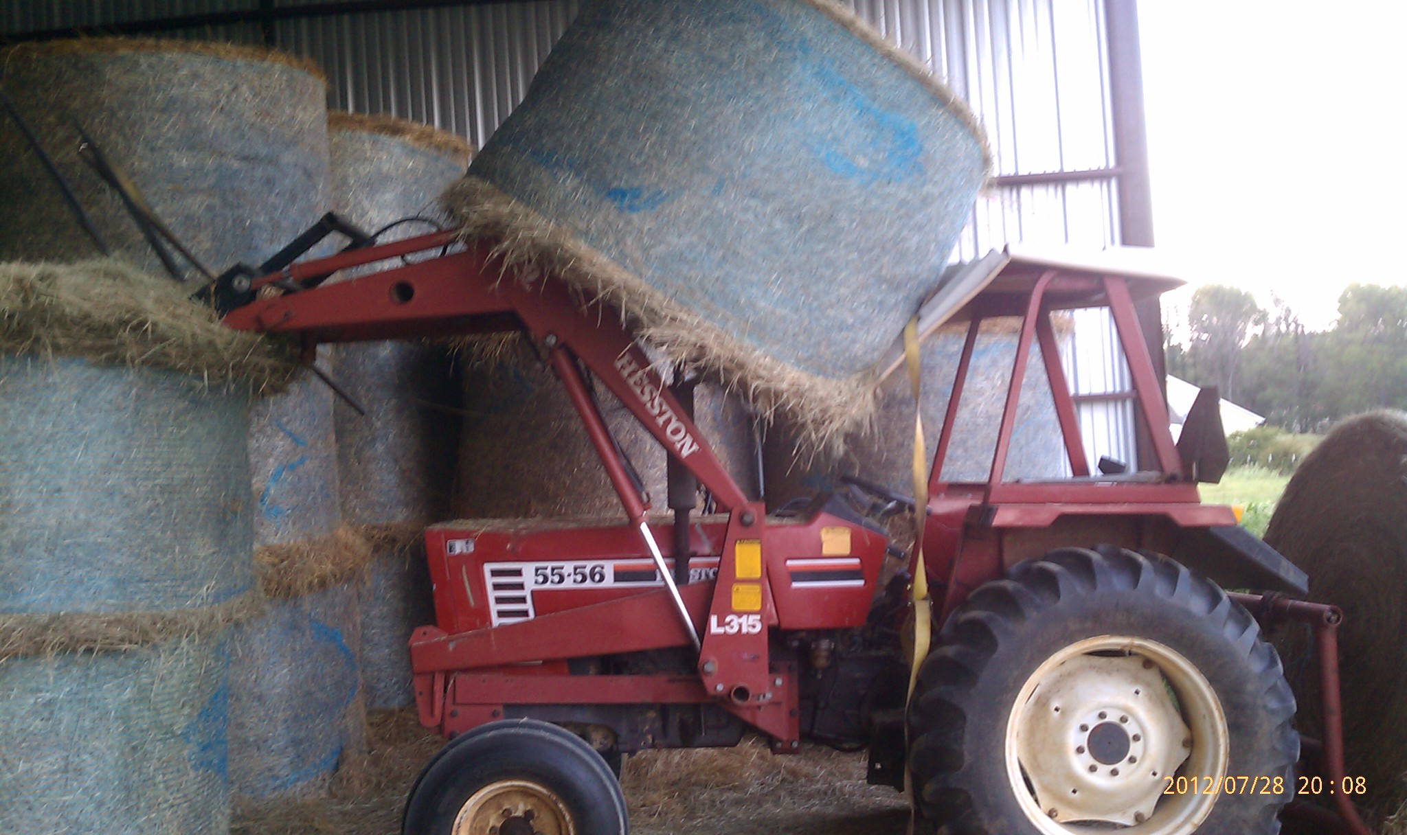

Here is an example of how NOT to stack round bales 3 high with a borrowed tractor. HowNOTtostackhay3high.jpg

shaking my head.all these posts an i didnt see anythinh about keeping a bale on the rear the whole time your stacking hay in the barn.also make sure backstop on the bale spear is high enough not to roll back on you.an do not hurry stacking hay up high.2 bales high is the max most loaders can stack.what hp is your tractor.
