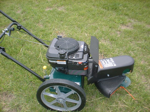

Alan, I have used mine now several times. I am happy with the Briggs engine so far. Over all it looks like Swisher tried to build a quality unit but at the same time come up hard agianst the price point/cost barrier. Ok, well, it has a somewhat chintsy though clever clamp which tightens the rotor support shaft which allows you to rotate the whole shaft from vertical to sideways. Real nice but unless you tighten the Hades out of it the shaft it will slowly or even quickly jump to the side--rotate---due to torque when the cutting head is cutting heavy weeds. It has not been a big problem and I think I can fix it with some clever thought one day when I am feeling clever. The wheels are OK but I think I am going to find me some pneumatic wheels eventually--of the same 16 inch size. I think I only paid like 250 dollars or so at Atwoods--it was on sale--regualr 299. I knew from looking at the rotateing support shaft and the amount of "arm" the cutting shaft has to it that it might want to slip or jump and it does but like I said it has not really been a big problem. I used it for an hour today and it never slipped one single time. The head also swivels from side to side as well as rotaing from vertical to sideways--also very handy--that has jumped on me once when I chopped up a tomatoe cage lost in the weeds that I had chopped up with the BX last Fall /w3tcompact/icons/shocked.gif . It is a pretty decent unit, I guess I give it a qualified thumbs up. There ain't a whole lot out there that is even as good much less better for this price. Supposedly it has permently sealed and lubricated ball bearings in the cutting head, I would rather have a grease zerk, maybe I can fix that too. In this pic you can see it to the left. J

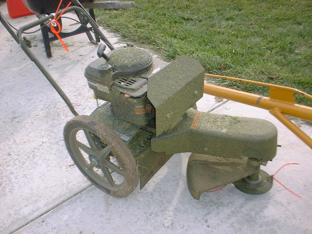

Allan, I too was somewhat surprised that a 6 horse engine bogs down in the weeds. I thought it would just rip right through, but live and learn. I hogged out my lagoon and pond sides and other stuff today--about 2 hours worth on the Swisher--no problems. Here are some pics. Oh, hope you like your new cutter.

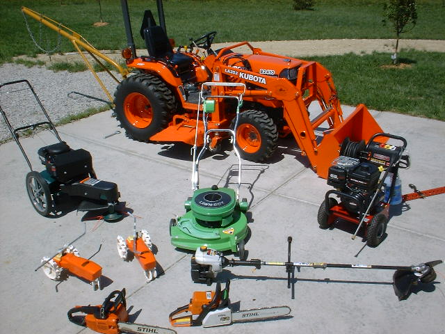

Another view after hogging. J

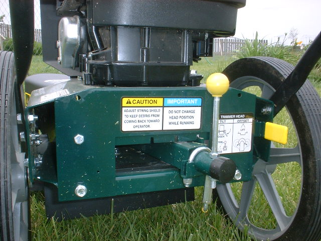

Here is another view showing the tilt and offset mechanism. J

TresCrows - That is definitely a nice feature - being able to pivot both ways. The first thing I notice about your trimmer compared to my Troybilt is that shield in front of the engine. Mine doesn't have it, and it looks like getting grass and debris in the cooling intake and fins could be a real problem. The stuff you're cutting goes everywhere. Of course yours didn't look real clean in the "after" picture either.

Oh, it was filthy after use /w3tcompact/icons/shocked.gif , the photo did not do justice but it cleans up nice. The metal shield does work, the model below the one I got from Swisher has a Lexan shield and a foam air filter that fits over the engine cooling air intake. Yeah--it does! I imagine you could rig up a shield pretty easy from Lexan (not plexi--Lexan!) You can bend the stuff easy in a break or even by hand if you clamp it between two boards etc. Lexan is more like a clear rubber than a plastic--very tuff stuff. The 1/8 inch would be fine. It also, the shield that is, deflects rocks and stuff from the operator as does the rubber skirt below the Swisher wheels. Make sure and wear some eye shields, I have been pelted severely with both my hand trimmers and this Swisher unit. J
