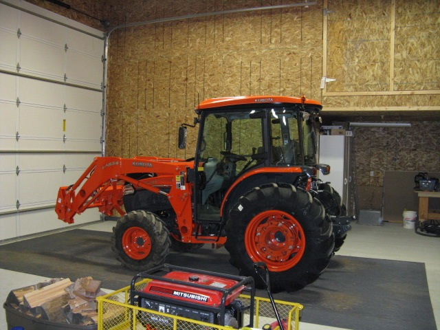

The Kubota Grand L5740 has a very nice cab, cool in the summer and warm in the winter. It is rated:
Engine (gross): 59 hp [44.0 kW]
Engine (net): 57 hp [42.5 kW]
Here's a pic of mine without the bucket or hoe mounted.
