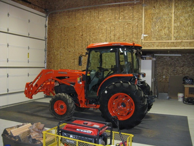

The Kubota Grand L5740 has a very nice cab, cool in the summer and warm in the winter. It is rated:
Engine (gross): 59 hp [44.0 kW]
Engine (net): 57 hp [42.5 kW]
Here's a pic of mine without the bucket or hoe mounted.

You got your kgs and lbs swapped, that 60D will lift 1300 kgs/3000 lbs to 10', but I see your point about height in the barn being an issue with an excavator. Oh well, I guess I'm going shopping for a bigger tractor with a cab. Looks like none of the TLBs have a cab?

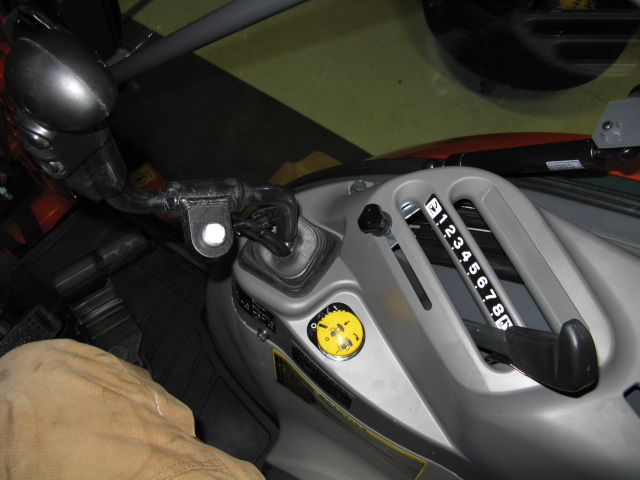

Great, now not only do I want a big orange tractor;)

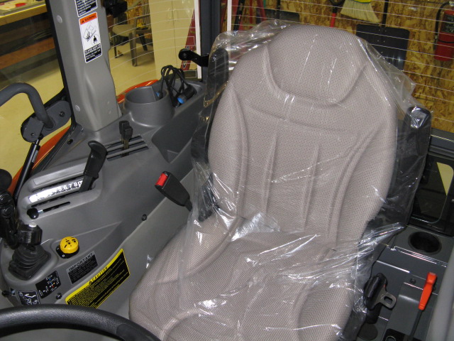

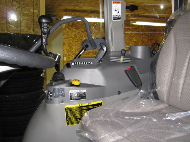

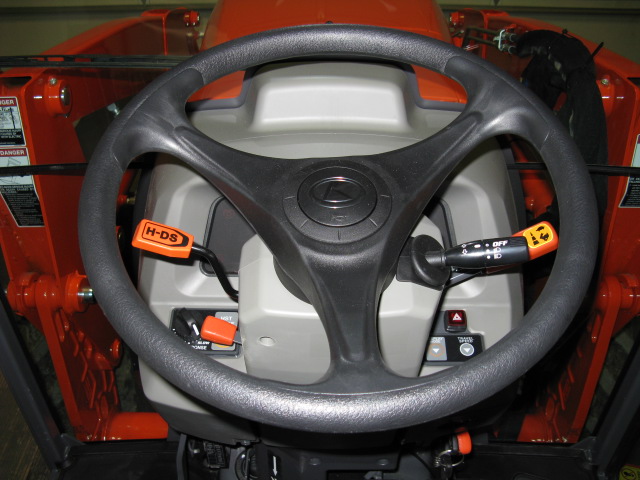

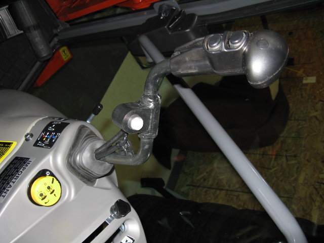

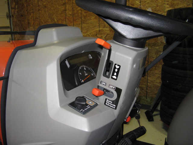

You mentioned a cab, so here are some photos of the 5740 cab interior. The 3 point is Cat 1&2 and is rated at 2976lbs. I have lifted in excess of 2500 (weighed) with the FEL; it handles 1500 without breaking a sweat.
Nice, thanks for the pics.:thumbsup:
