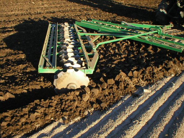

That's a lot of disc. If you're pulling it with an agressive set up in a deep plowed field you will know it's behind you but if you're using it like you mentioned for smoothing out or roughing up a pasture it should pull great.
For what you'd be using it for this is not the best smoother JD built. I use an 8' Blanton 3ph for smoothing and a cheap ugh... light weight Howse for cutting. The Blanton is a heavy disc and it and the JD 210 is built with a simular design only mine is 3ph. It's not the best smoother Blanton made either but it works better now that I played with it and moved stuff around.
I've got the back 2 sections turned backwards I guess you'd say. Instead of the cutting into the ground with the concave facing forward they are facing backward. I know the disc aren't designed for this but hey you don't know till you try. Anyway it smoothes better but you wouldn't want to drag it across the pasture that way but it's fine on loose dirt.
The ideal situation would be to have the disc sections where you could easily turn them around.
At first glance it looks like a normal disc but look closely how the back sections are mounted. I have the front sections set up about 1/2 aggressive and the back only slight aggressive.

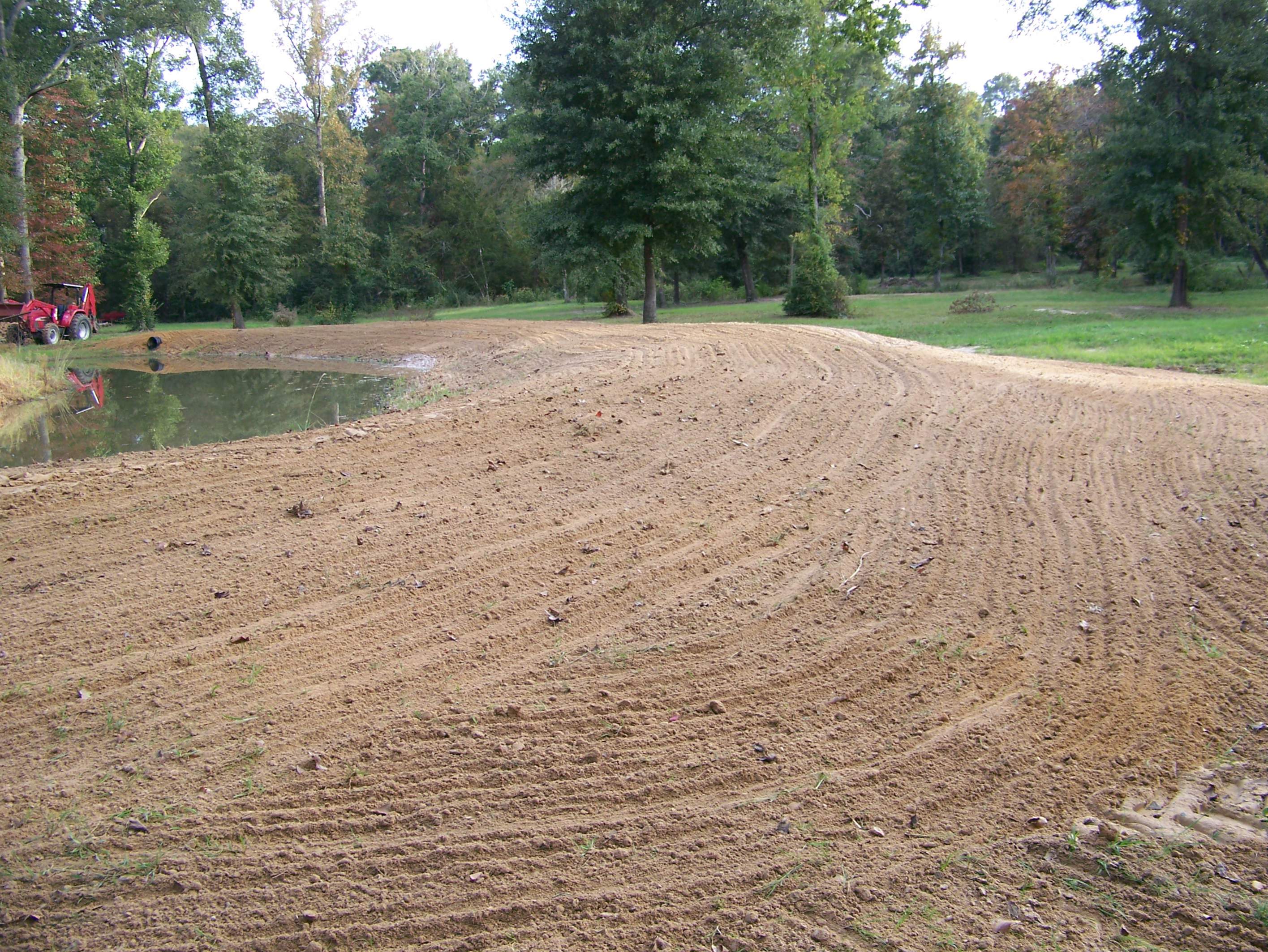

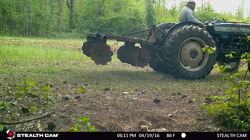

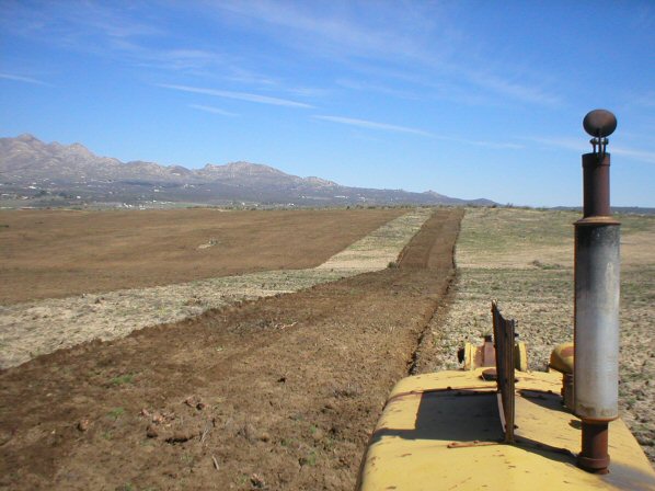

There are so many variables, that without actually seeing the areas to be disked, all anyone is doing is guessing. Type of terrain, type of disk, size of pans, overall weight. 3pt, wheel, old pull type, desired angle, desired depth.
I have a 75hp, 12,000lb tractor that I use to disk with as well as a small dozer and an old Cat D6. We have 6', 8' & 12' Kielfer offset pull disks. With my conditions, the 8' disk with new 22" pans weighs in around 3000lbs. On the 2nd disking (9" deep) there are areas where it is all the tractor can handle. Your tractor would not budge it. I can pull the 12' disk on flat ground only and only a single pass, won't do it at all on a second pass.

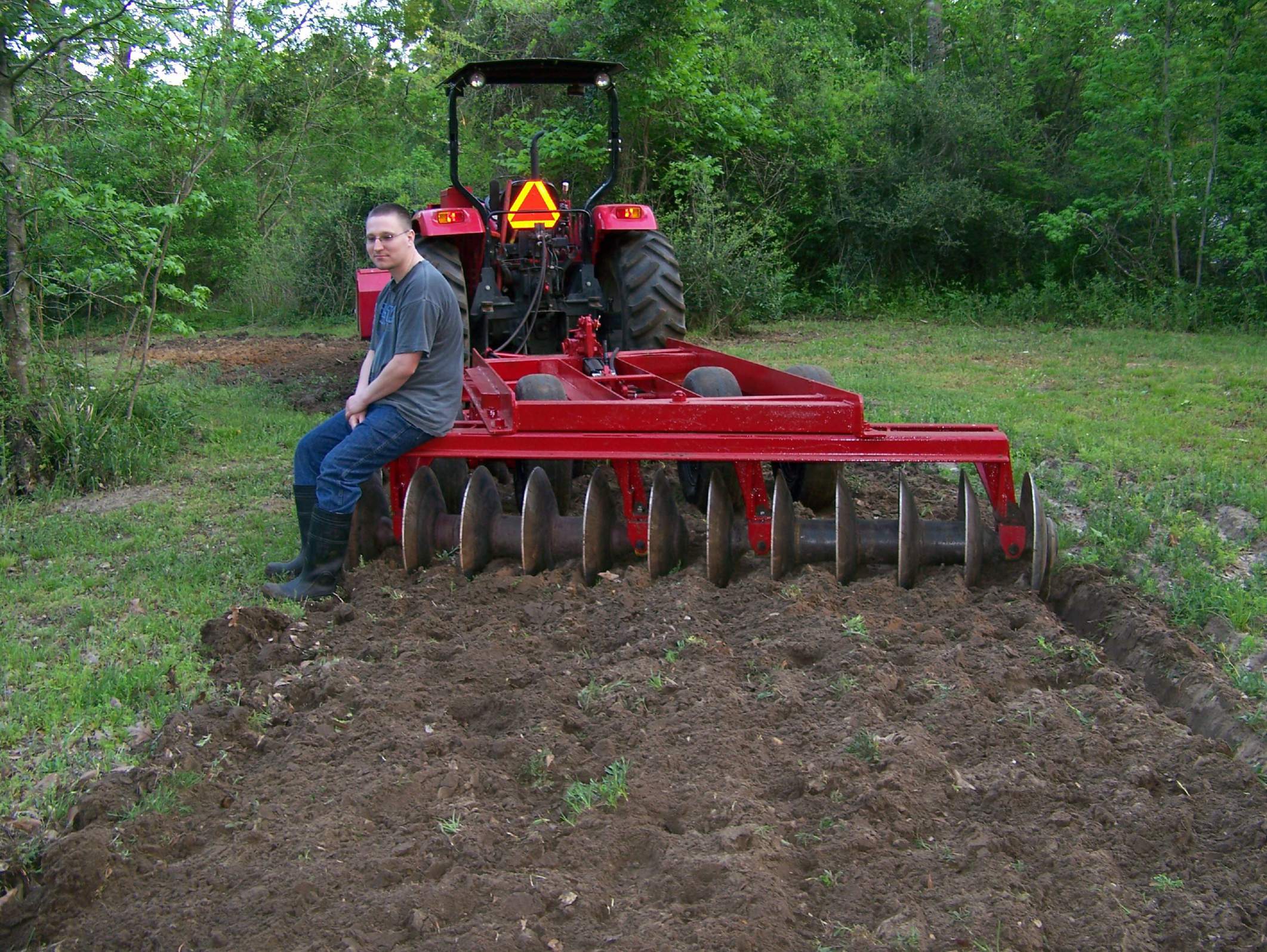

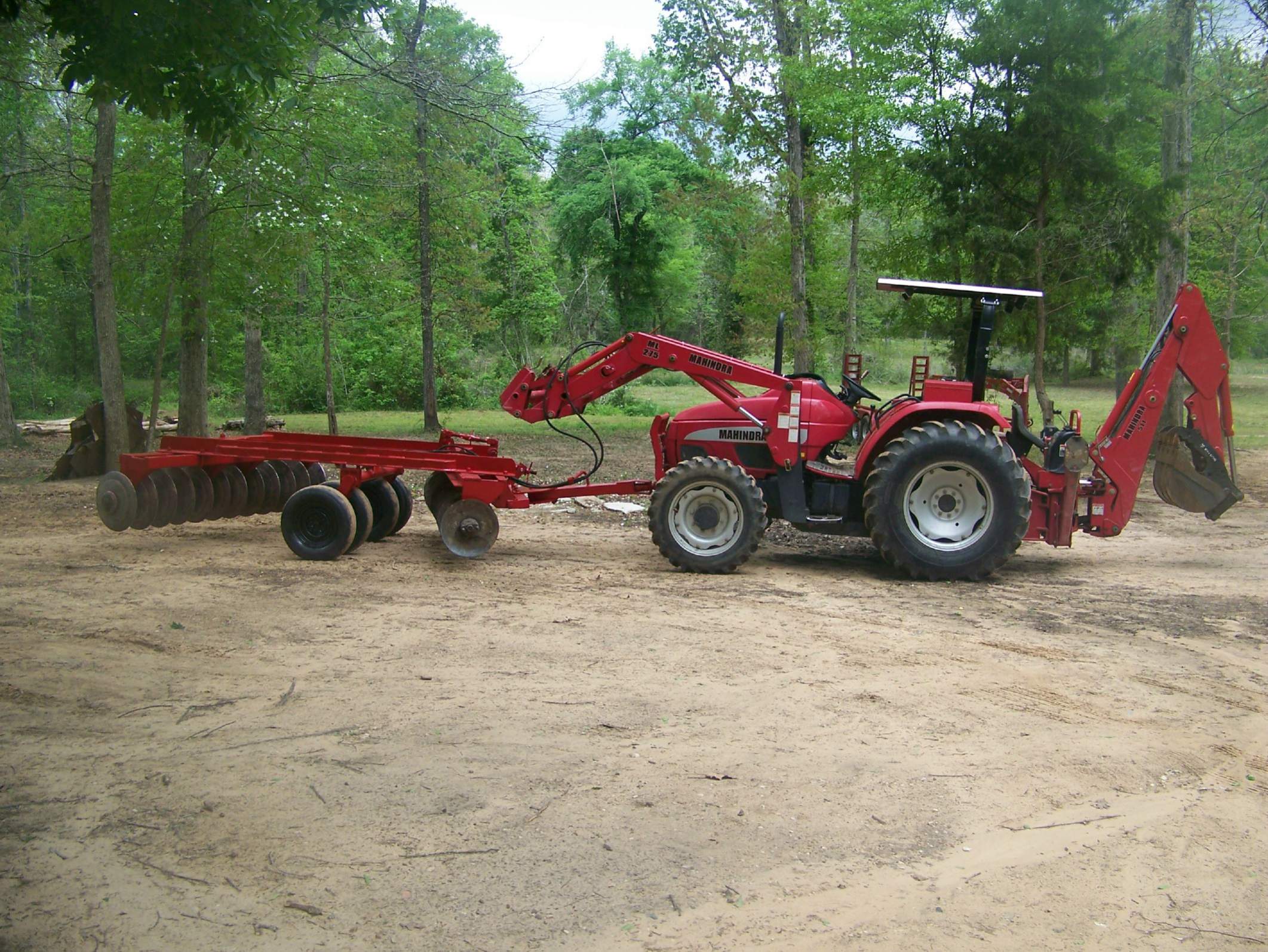

So for those people that are always saying that there tractor can pull such and such and it seems big, need to get ALL the details. Here's a picture of a smaller 13' disk that requires something like 400hp to pull around. :rolleyes: Oh, each of those pans puts over 900lbs of pressure to the ground.
I remember some guy that use to be on here quite often that was going on about his 60hp 6000lb tractor pulling a 14'-16' disk.(I don't remember now) Really? I asked for pictures several times, never got any. Seems like that would be a hard pull even with small pans, but I don't really know, all I've ever pulled are 22" pans.
Again, lots of variables that should be considered.
Good luck with your decision. ;)

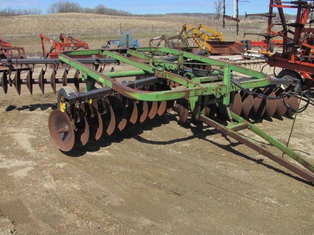

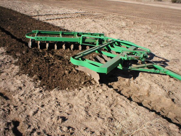

Here is a picture so people get an idea what I am looking at. (This isnt the actual disc, rather one just like it I found online.)

Since its not 3pt, I don't think youll have the weight to pull that size of disc. Discs require lots of horsepower and lots of weight. If it does pull it, I don't think its going to like it very much. On 2nd pass my old school 6' discs will cause me to loose traction now and again, but HP isn't an issue...
   / Biggest disc a MX5100 can handle #14
The wheels bear whatever load the operator desires, so draft force may or may not not be a limiting factor.
However, this non-Three Point Hitch towed Disc will require a lot of room to turn and OP wants to use it in space limited conditions. I do not see how you could move this long-tongue Disc in reverse more than a few feet.
