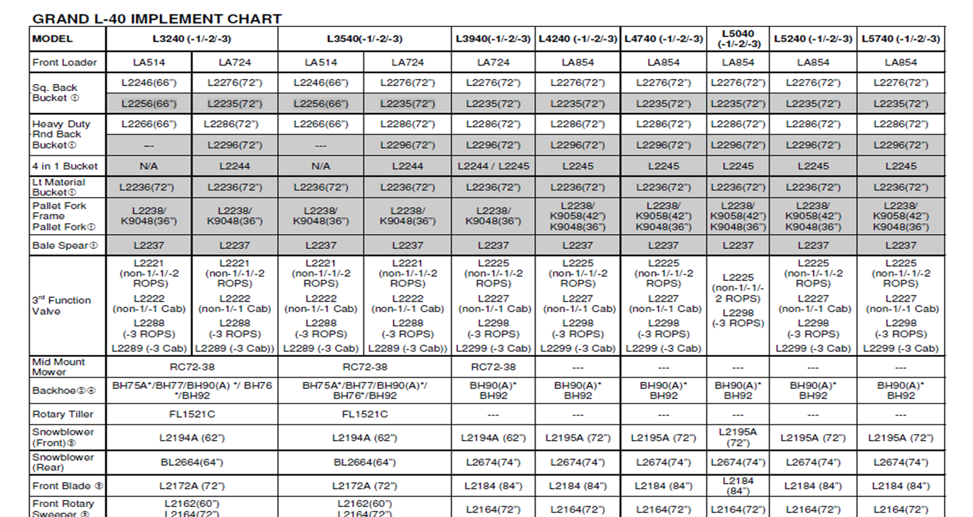

Here's info implements info for the Grand L40 series from the wholegoods price list.

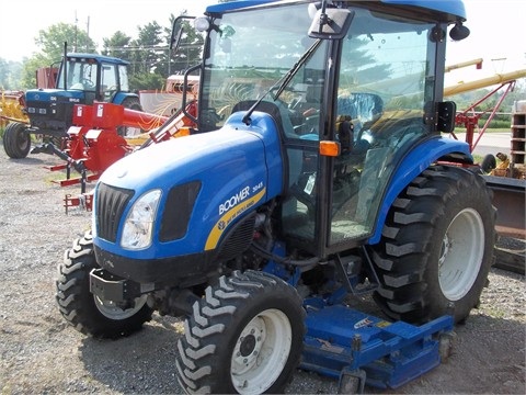

Here's a NH w/ 84" mmm
